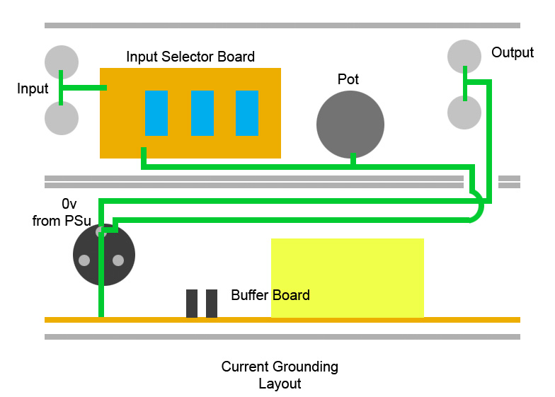

Nuuk brought up the isssue of grounding and that maybe the pot isnt grounded properly. I have enclosed a diagram on the current grounding layout. If anyone has any comment as to wether this is wrong please tell me. If not i will take it the pot is defective and stick back in the old 100k one and put resistors across it.

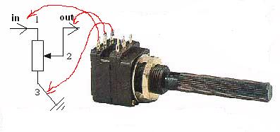

well there are 10 pins on the pot plus 2 for power and i got it with no doumentation, and for some stupid reason i thought that the resistance between input and output should vary as opposed to the resistance between input and ground.
Should be 30 minutes work tonight to fixed. Head screwed back on the right way now. Actually to be honest i didnt quite understand how a a pot worked until i thought about it long and hard today. Then after 1 or 2 hours of drawing pictures on paper I worked out the way i had it and the way it should be.
It should be I- G-O and i had is G-O-I if G is ground, I is input and O is ouput.

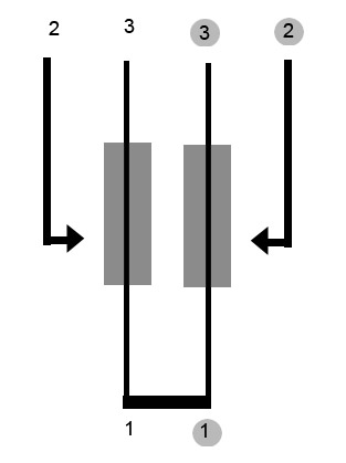

Ok i have messed up again, can somebody help before i shoot myself.
Which should be wire where please please please.
I have 2 as ground, 1 as in and 3 as out.
please begging help
fil
the two 1's arent join how i have it, still doesnt work

Thanks to everyone especially the man of so few words moamps, your diagram showed me I had the inputs and output backwards.
Its an Alps R16 series 10KDX i think they are called, several pins are unused but then you get the issue that the .pdf manual shows connections but does give a very clear idea which way you are viewing it. Also i was reading the diagram wrong and though that the sweep was connected to earth. All told about 7 different wire solutions, all involving desoldering the blooding thing from the board i had it on to re-wire. Total nightmare.

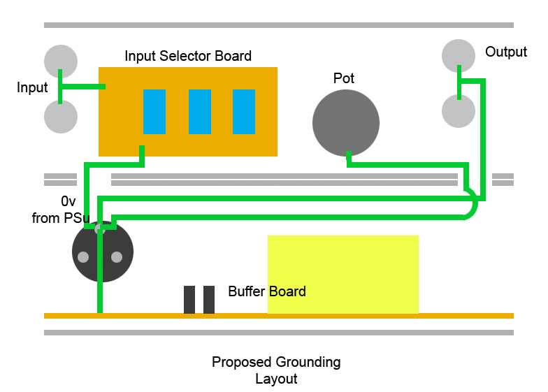

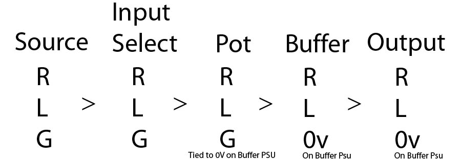

Ok having listened to the machine a lot last night i have to say that there is a slight Buzz or Humm or whatever you want to call it going on. It is not huge but it is there and wasnt before and just wondering if there is a cure. I am guessing it is my grounding layout since it is a bit of a mess
I have done a sketch of the curretn grounding layout and a proposed one i might try and implement. Could anyone comment of wether what I was thinking of doing is correct or wether there is a better solution. The whole star earth thing is made more difficult by the fact the Buffer and passive preamp are in different boxes which i drilled holes into and bolted together so i didnt have to use interconnects which i though would be a bad idea.
The illustration only shows grounding since i guess this is where the issue is
Ok here is the current
Probably not the answer that you wanted to hear Fil, but I would put all the pre-amp stuff in one box (or keep the PSU separate). 😉
Ov from PSU to buffer board.
0V from buffer board to pot.
0V from input socket to buffer board.
0v out from buffer board to ouptput socket.
