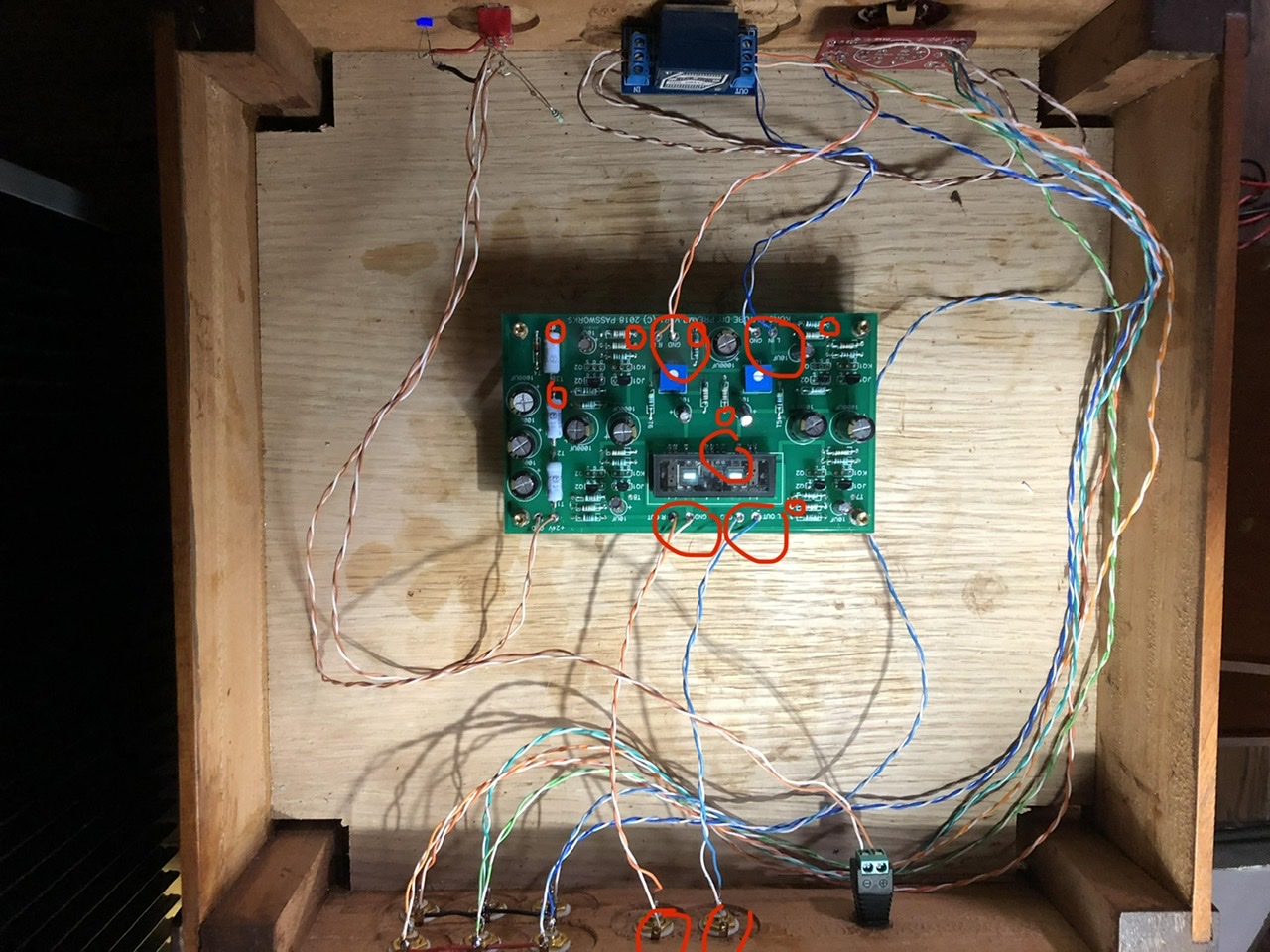

I'm Back again, I obtained some flux paste and spent a lot of time cleaning and resoldering and I still have the buzz. When I turn up the volume, it has a staccato buzz with a background deeper hum. I need to replace one of my R1 resistors. I know they are matched to the transistors. With that said, they are just resistors, right? So if I replace the one suspect resistor with one that matches the other 3, it should work just fine, i think. I have not yet found any breaks or melted insulation in my com wire. I do not know what to do next. I hae not found any obvious bad solders. I welcome ideas or suggestions.

The hum/buzz is present with no inputs connected and it changes sides when I switch the output cables. So I believe it is on the right channel between the power section and the output. The biggest difference that I can find is that the G2 pin on the nutube is very difficult to solder. I also damaged the lead on the R1 resistor closest to T8. That seems to be working okay, but could the repair cause a buzz?
Last the voltages at T7 and T8 are higher than I would expect based on your article on this project. Both have a minimum voltage of around 13.
That is all I can find. Any ideas?
You have two separate problems:
First - The Hum/Buzz
Second, T7 & T8 voltage of 13v
On the T7 & T8 voltage issue, check to make sure you have the 33.2K resistor in the correct place and not 332K. Since both channels have this voltage issue, check all the 332K and 33.2K resistor placements.
For the Hum/Buzz, use your DVM from the G2 pin on the nutube to the negative pin on the 10uF cap and one side of the 33.2K resistor.
I would avoid adding any more heat to the G2 pin and the PCB at that spot until you know if you have good contact from the G2 pin to the the two parts connected to it.

I'm going to try to get this post to take for a second time. I have gone through the offending channel again. I have replaced all of the transistors and R1 resistors. I have cleaned the darn thing and reworked all solders that looked like they might be weak. I have replaced the output wires and RCA jack on the offending channel. The buzz is still present. It seems to be getting louder every time I turn the preamp on. I need to Check on the 332 and 33.2 resistors as noted above. The connections to the G2 pins have been rechecked and are good.
Thanks you Elwood625 I found 2 335k resistors where 33.5 resistors should have been Voltage is corrected. Buzz is still there but is quieter. nutube is if anything, more microphonic.

So I installed the new korg nutube. Still had buzz. Hmm. I had refine cleaned or adjusted everything on the board. So I really focused on the ground circuit. The hum as barely audible, and both channels sound the same. I can only hear it if I lean close to the speakers with nothing playing. I may chase it further, but as of now I am done. I probably need to buy some higher quality RCAs. I really had to fiddle with them to get to 0 ohm resistance on the ground. There was one pole on my old nutube that has some melted plastic or some other material where it attached to the tube only visible from the bottom side. I do not think that was it. At any rate I’m sitting here listening to Robert plant and Allison Kraus. Life is good enough.

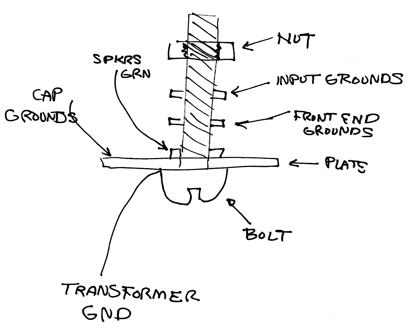

I'm not very good at diagnosing ground hum issues, so far I haven't had that issue, yet. Either I'm blessed or lucky with grounds, however, I always follow this diagram for grounds.
