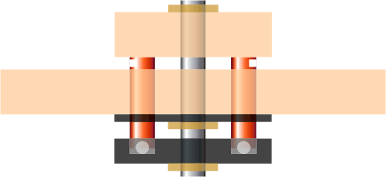

Just skimmed through an awesome thread on DIY binding posts, but I don't have the energy to make something that complicated for this project.
Since it's cheap to get hold of galvanised steel nuts and bolts, I was thinking along the lines of using a large diameter bolt and three nuts per post, with a hole cut through the bolt to insert bare wire into.
Any problems?. In particular, is galvanised steel ok for this job, or is there significant drawbacks over copper or those normal binding posts?

I dont know that zinc, or galvanized steel, would be all that ideal for audio.
It shouldn’t be too difficult to at least find brass hardware from hardware, plumbing, or boat supply stores.
You didn’t like the welding connectors?
Can I put in a plug (ha ha) for Speakon connectors here?
They're airtight and they don't rattle, they allow biwiring as standard, they have very generous current ratings, they have proper materials for the contacts and they allow very easy swapping between amps, cables and speakers when you're A/B testing.
I wouldn't use steel, particularly if you're joining it to copper and passing a current through it. One side or other's going to corrode horrendously.

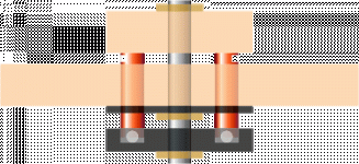

I tride hard to get hold of a threaded copper rod/bolts, but without any luck. I did manage to to get a 10m dia. copper bar for free though, and now I've come up with this design (inspired by cardas). Although it may look a little complicated at first, it should be very cheap and easy to implement as the only requirements are some thick plastic, some nice looking nuts and a steel threaded rod. Four pairs for under £10 maybe...

As roddyama the moderator has rightly suggested, a galvanised steel rod will be terrible choice. Since you've already got the copper rod, do consider investing in a set of cheap threading die tool (ones that don't require a lathe) to cut threads on the said rod.
I built the DIY Binding Posts as linked in your first post. Frankly, I couldn't note any improvement over the spring loaded types that I've been using. But your plan appears foolproof. No harm in experimenting

Yeah, I've learn't a bit since considering steel bolts...
I actually did try to thread the rod using a die, but I wasn't happy with the result. I then started adding other requirements such as:
- no other conductive material in contact with the copper (i.e nuts)
- increase strength/firmness of connection
- no threaded material in the wood
which has led me to the current design.
Your cardas clone is exceptional. I think this might be a more reachable goal for people with only basic tools though...
