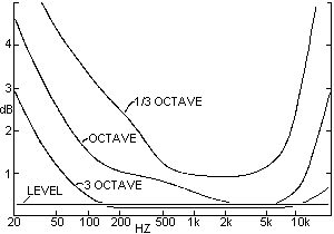

and you should compare to known Psychoacoustic thresholds too when planning a listening test:
Clark's ABX frequency response jnd threshold curves

Clark, David L., "High-Resolution Subjective Testing Using a Double-Blind Comparator", Journal of the Audio Engineering Society, Vol. 30 No. 5, May 1982, pp. 330-338
ABX Amplitude vs. Frequency Matching Criteria
it seems like in most home audio speaker cable situations skin/proximity effects will not be expected to reach audibility
