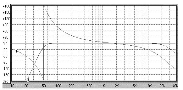

Hello, please can you explain to me better the meaning of "phase wrapped" about LR4 symmetric Xover (I'm a beginner..)? What's the best topology of passive Xover from this point of view?
Thanks.
Most graphs limit the phase to plus and minus 180 degrees to keep the graph a manageable size. So when the phase goes beyond +/- 180 it "wraps" to the other side, resulting in a straight line at the "wrap". See the phase wrap in the attachment at 50 Hz.
Some people think excess phase change (as indicated by a wrap) degrades the sound. Other people not so much. I've seen studies that support both sides of the question. Your decision.
The use of DSP does make it much easier to achieve minimum and linear phase speakers, there's no doubt to that.
Hope this helps.

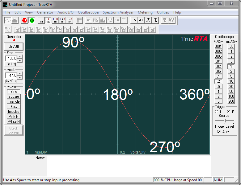

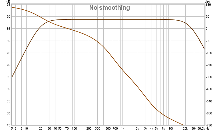

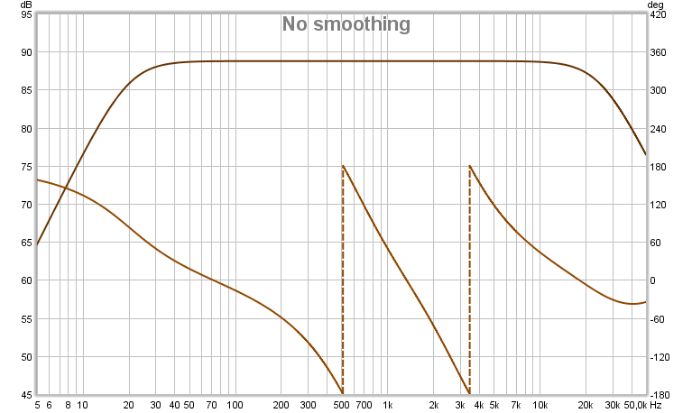

Beside nice points from Grasso789 and ernperkins maybe below can help, picture one phase is exactly same as picture two but with wraps we get better Y axis resolution, they show system with LR4 XO points at 600Hz and 3kHz and system band pass is BW2 stop-band slopes at 20Hz and 24kHz, all these particular slopes form systems unique phase sum. Picture 3 can maybe help better understand that after 360º we start same wave again but its out of sync if we sum it there and if we sum a wave that is 180º apart it will cansel.
