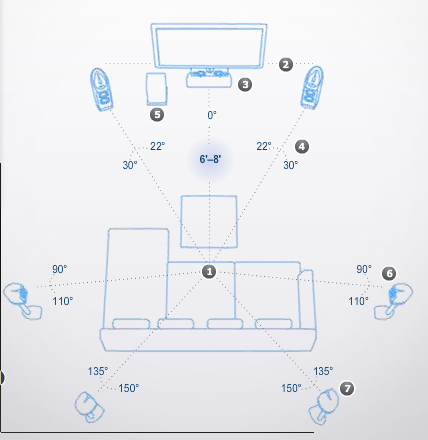

My first project is 7 X two way systems for 7.1 HT. Sealed.

The rule of thumb would be Fs + 2 octaves if xover is 6Db/O w/o Ferroflud
that's 3100Hz for your tweet but you have Ferroflud so you can fuge the rule.
Two octaves is still a good idea but at 12Db you could get down to 2500Hz with out too much trouble. If the woofers are good to 4KHz why even worry about 2.5K. If for a 7.1 you will want constrained dispersion. No?

Excellent input
Thanks Borus,
I like the numbers.
As for the 7.1 constrained dispersion...
I'll have to think it over.
I had bought a set of retail speakers prior to Christmas.
WTW config.
They had a nasty dead zone which has me cautious about dispersion although I think the real problem was phasing / interference and a poor tweeter match to boot. (low spl)
They were returned.
I'm open to hear the case for constrained dispersion.
