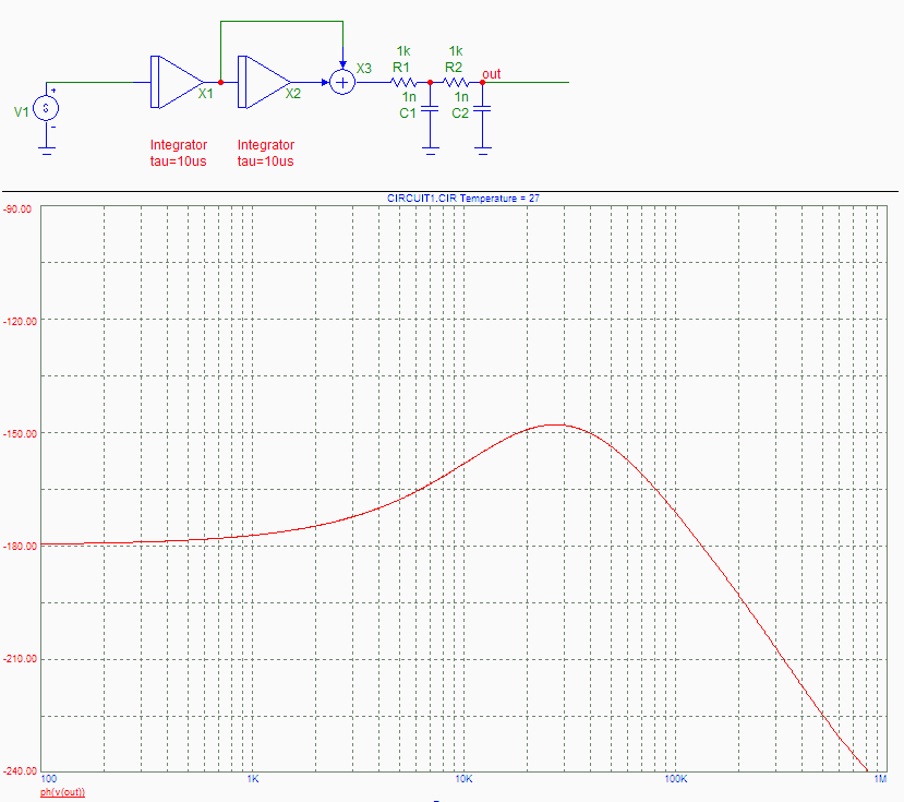

1a) 2nd order self-oscillating deltasigma.
See attached drawing. The modulator has two poles at DC, one real zero before the intended switching frequency, two real poles after it.
Now look at the phase plot. As close as the phase shift gets to 180 degrees at low frequencies, it never gets there. It has only one crossover point at 180 degrees (here 133kHz). This is expressed as "second order loops are unconditionally stable". After an overload, the loop will always return to stable oscillation at the one and only crossover point.

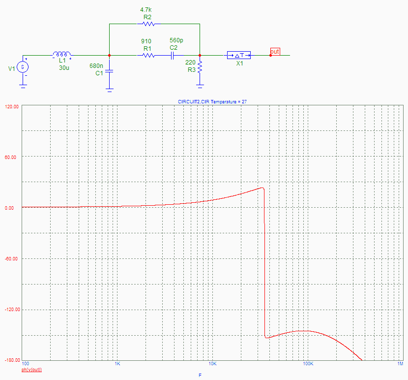

2) UcD. Attached is the circuit and phase plot of the version known from the patent. I've purposefully left the output open, so you get the situation you were "worrying" (I doubt that) about.
As you can see, the phase lead network simply keeps the phase response above the 180º line. There is only one 180º crossover, which is exactly where I wanted it to be.
