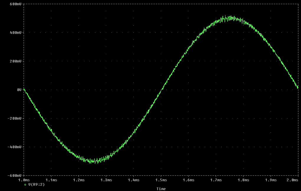

Nth order noise shaping
I here present a scheme that can be used for Nth order noise shaping suitable for Class D amplifier feedback.
In the example here, I’ve made a 4th order feedback, but more blocks can easily be added or removed.
The cut-off frequency is controlled by the ratio between the four capacitors and R6, R8, R9 plus R10.
The ratio between R6, R8, R9 and R10 controls the poles. I have not optimized the ratio. By doing so, it’s possible to get a flat output magnitude and phase response.
As long as the opamp open loop amplification is large, this resistor ratio has no influence on the order of feedback. Only stability and the magnitude ripple around cut-off will be affected.
Opamp U1 dominates the noise generated by the feedback system. Therefore only one low noise opamp is necessary to construct an outstanding feedback system.

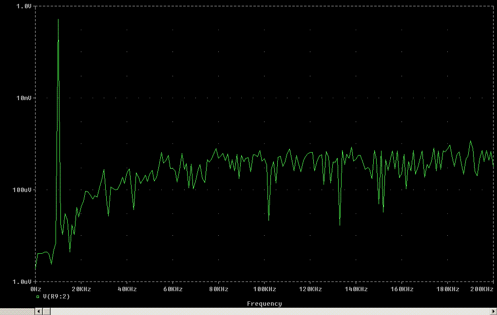

Bode plot
FFT analysis
I've olso made good progress in making feedback after a 2nd order LC output filter. I'll write a post about this later. Happy noise shaping.

Have you tried simulating using 'real' component models?
The opamps have a gain of 1E6 and are limited to a -/+15 supply. As far as I know the model dosn't contain slew rate, GWB nor poles.
Resistors and capasitors are linear and they have no deviation.

If you have a PWM modulator with good linearity you would not necessarily need such a high order of NFB loop (though in simulations at least one can achieve fantastic THD values).
you would not need to remove the carrier signal completely either.
And yes, also a delta-sigma amp would show some switching residual. The difference is that the SD amp's residual is noise-like (see attached simulation) and the PWM's resembles something like a distorted sinusoidal.
Regards
Charles

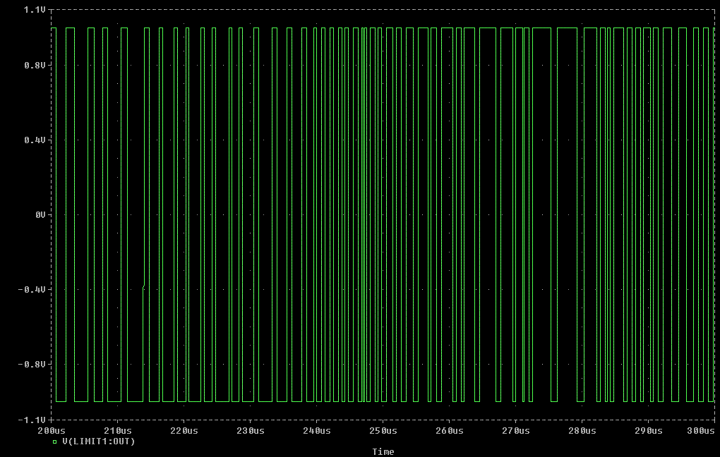

Et voila the modulator output:
I did intentionally use 10 kHz because the modulation pattern is much easier to recognise (I would just look like a green lump on the screen), though the performance would be better at 1 kHz input.

I'm very pleased to se that the delta-sigma converter dosnt switch every clock cycle (I'm assuming that you gate the digital signal through a d-flip-flop). This could really lead to a huge improvement in MOSFET efficiency. U^2*C*f losses are large when you go for a low Ron. Less switching is needed in order reperesent a signal. However, I'm afarid that less cycles will be skipped, when the amout of feedback is increased and there by no efficiency benefit of the delta-sigma converter. What do you say?
It does indeed lower the pulse-repetition frequency with increasing input voltage. OTOH it also has a high IDLE switching frequency which can also lead to problems.
Just a remark: Because I ran into limitations when doing mixed signal simulations I just use a S&H and a limiter instead of a comparator and D-FF.
