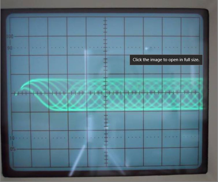

Like this. I would have thought around 1.2 volts from top to bottom for a Philips RAFOC. The signal will be sat on top of any DC voltage present but that is normal.
1.5 volts sounds a bit high but don't alter anything, just compare it with the good one using the same disc and measurement points. This picture shows 1 volt peak to peak.

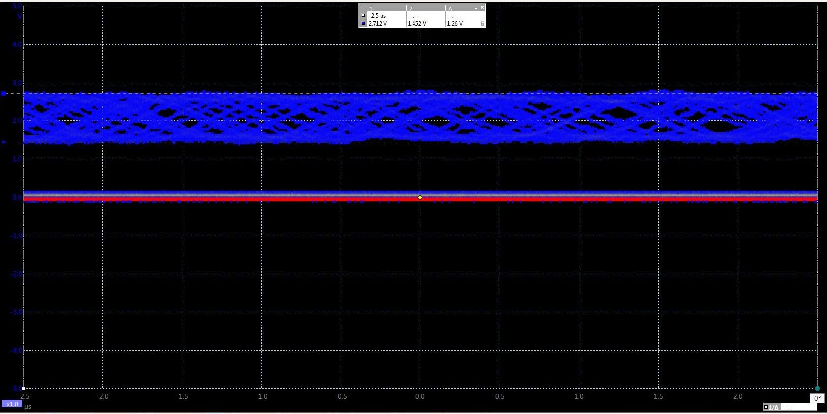

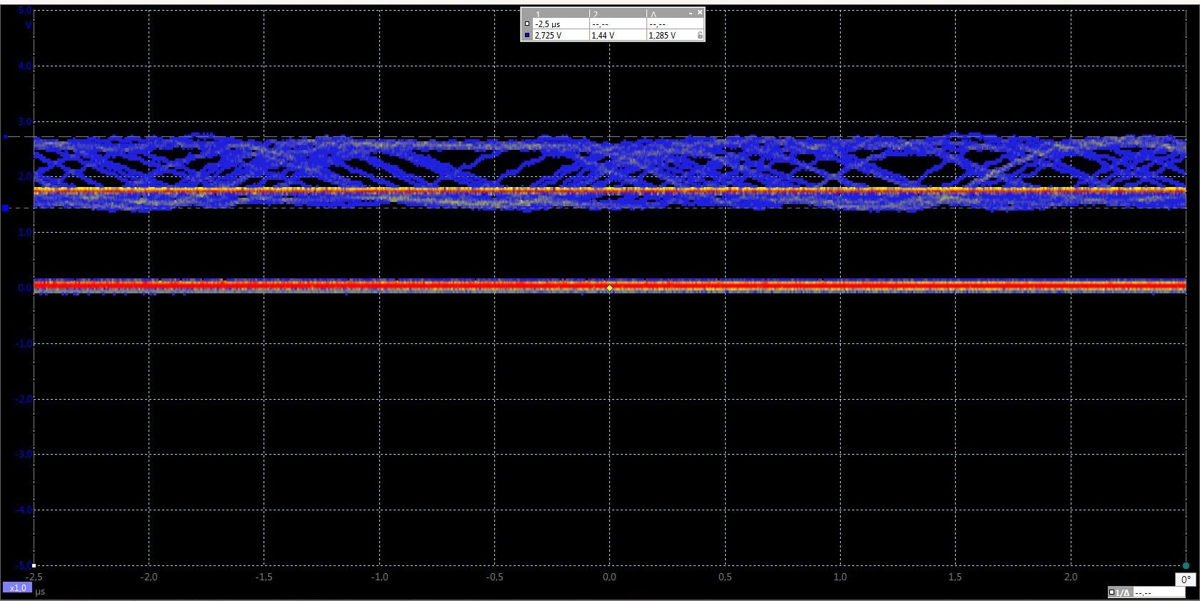

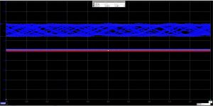

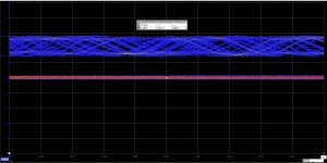

I managed to capture the eye patterns:
  • Good player - original CD - 1.3Vpp
  • Good player - copied CD - 1.3Vpp
  • Bad player - original CD - 1.3Vpp
To me those eye patterns look pretty much similar. What can we conclude from the results?

Well the amplitudes look OK and about what I would have expected. Thats good confirmation of that :up:
Can you make any determination of the 'quality' of the CDR signal ?

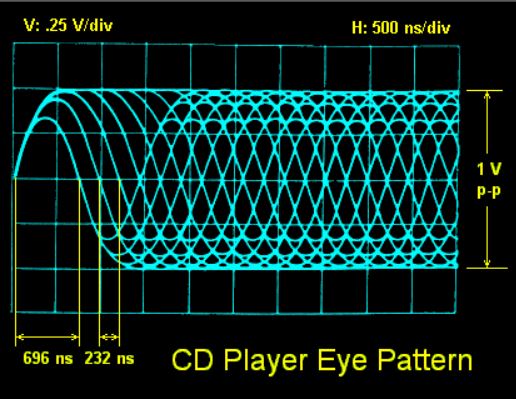

What we are looking for is jitter (is it steady) and the relative amplitudes off the T3 - T11 sinewaves that make the eye pattern up. All you can do is make an estimation of whether it looks OK on the CDR. Does the CDR waveform 'bounce'.
Its possible in the end that your problem is just down to tolerances, one player coping with it and the other does not. I suspect there will be no easy answer to this one :(

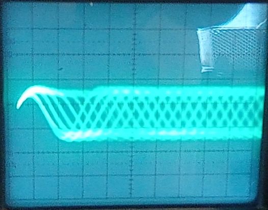

This is a real eye pattern I took a picture of (on an old Sony) and yours should look very similar. It should be rock steady. This was on a pressed commercial disc. Yours should be similar. The CDR will probably be less good.

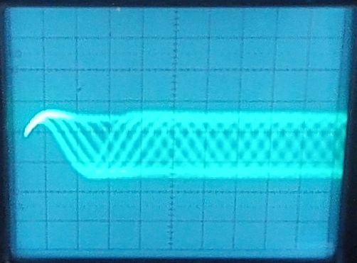

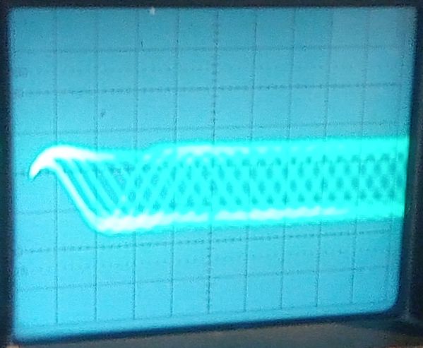

I found a cheap used analogue oscilloscope and captured the eye patterns again. I used 0.5 V/div and a timebase of 500ns. Sorry for the image quality. I hope you can get at least an idea of the signal quality.
The good player with original CD produces the best pattern - the pattern is stable and does not move at all. The eye pattern of the bad player oscillated quite a lot which results in a blurred photograph.
Probably it is worth mentioning that even the good player had some problems with the burned CD now. It was required to load it a second time, the first attempt gave rise to a "CD cannot be played"-error message.

They look reasonable enough. If you can see that the burned disc produces an unstable image then I think you have your problem, or at least part of it.
Some players just can not cope with the poorer signal a CDR/RW produces, however you can sometimes see a big difference in burning discs at different speeds. I found burning at faster speeds (which is against what you generally read) produced the best results on my burner.
As you have a scope that can accurately measure amplitude now, you could try increasing the laser power slightly by looking at the RF. Measure the amplitude accurately first on a known good Red Book disc (write the value down) and then increase the level a couple of hundred millivolts. Now see if the CDR plays or not.
Its really just for curiosity. If it doesn't help then reset the amplitude back to where it was on the same Red Book disc.

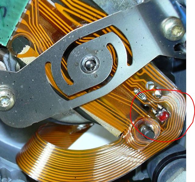

I just tried to find the pot for laser power adjustment on the servo PCB and in the schematic. Apparently, there is none :confused:
Is it possible that the laser power adjustment was done at factory by soldering a calibrated resistor? Could an IC on the servo PCB do the adjustment automatically?
While checking the PCB and schematic I saw that I forgot to replace a tantalum capacitor on a small attached ADOC PCB. It is for decoupling the +5V VDD for a PCF3523 IC. I read that it converts the I2C signal from SAA7310 to SPDIF. Do you think it is worth replacing the tantalum cap? Maybe it could affect the +5V rail somehow.
Ah, now I rember that I saw this preset when I once removed the CD drive. I did not dare to touch it because the whole drive/flexprint assembly looks really fragile.
There is no chance to reach the preset on the flexprint while the disc changer is assembled, it is necessary to remove the drive for the adjustment. To be honest, I don't want to risk damaging the laser with a trial and error approach.

I checked my captured eye patterns again and realized, that they slightly differ from the textbook eye pattern that I saw:
After the first three strong peaks there is a small dip in the signal with lower amplitude compared to the average.
Anyway this effect is visible for all eye patterns that I recorded, even for the good player.
