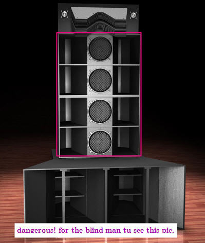

The GSA system follows Richard Long's Paradise Garage system design with Levan/Bertha subs, either Ulitima rear loaded horns with 15 inches or what appear to be side mounted JBL 4520 or something similar to Waldorfs (which was Richard's 2x18 larger version of the 4520) although the one in this picture appears to use 15 inch drivers with a larger mouth on the rear loaded horn, double JBL 2395 horns (copies?) with JBL or TAD drivers, and JBL 2402 or 2404 tweeters. The Levan is a hyperbolic horn expansion for shortest length to the cutoff frequency - though it's still not small - the trade off is the high frequency distortion increases faster than other expansion rates, but as the Levan horn only covered 2 octaves it isn't a big issue. The Levan (named for Leroy Levan the best known DJ of the Paradise Garage) was the mouth expansion of the bass cabinet which Richard called a Bertha. A single 18 half height Bertha was an Emerald ( i believe was first used at Emerald City disco in New Jersey).
The drawback to the system is it's horn loaded except for the 200 to 1khz range where it's a direct radiator ( done better in bigger systems by Richard) and the phase cancellation where the rear loaded horn is out of phase with the 15 inch direct radiator in the low mid band.
I don't know if GSA is using a crossover similar to the RLA 3000/ 4000/5000 but expect he is.
From further viewing of some GSA installation photos there is a GSA 3001 crossover which has the same functionality as the RLA 3000 - the RLA 3000 was build by Alan Fierstein of Acoustilog who did the room treatment of the Paradise Garage, and still services the RLA crossovers, but doesn't build new ones.

No its a different Horn, the Bertha is a EAW 2X18" Horn BH-882iP. If interesting, I post a drawing of the Bertha/Levan combination!

I worked with Richard Long in 1985. The bass box is called Bertha and the extension with a 96 x 42 inch mouth is called a Levan (after Leroy Levan). The drivers were custom made Eminince 18's - maybe some RCF 's later . There were also a few Levan's built with 120 inch x 42 inch mouths with a third bend . (I worked iwth Richard on a club called the Copa in Toronto with 4 of the 120 inch Levan's that were double stacked for a 10 foot x 84 inch mouth). Sometimes Richard made the Bertha's or EAW made some for him as well. The 10 foot mouth was only ever made by Richard - i gave him a hand in his NYC shop for a day doing the final cuts of the mouths for the Copa. The Bertha/Levans are run 20 to 100hz on an effects output with a gain and cut control on the RLA 3000
The problem with the GSA system is the phase cancellation on the 15 inch low mid box where the horn loaded back radiation meets the direct radiator 15's output. - maybe about 250 to 400Hz range ) It was better done by Richard with 2 of 2 x 15 inch fully horn load bent front loaded bass horns running 40 to 250 HZ per stack and then a 250hz crossover to the double D 2 x 12 inch horn ( RCF ) with large long phase plugs Richard called the Double Dildo before crossing to the JBL 2395's at 1200 Hz which ran full range while the 2402 JBLs ran off the RLA 3000 crossover from 7 K and up on an effects output of the RLA 3000 crossover . The second problem with the GSA's 15 inch box is they don't go down to 40 HZ which was needed for the crossover points Richard used, but they may well have thier own crossover points based on their driver choices and cabinet design.
