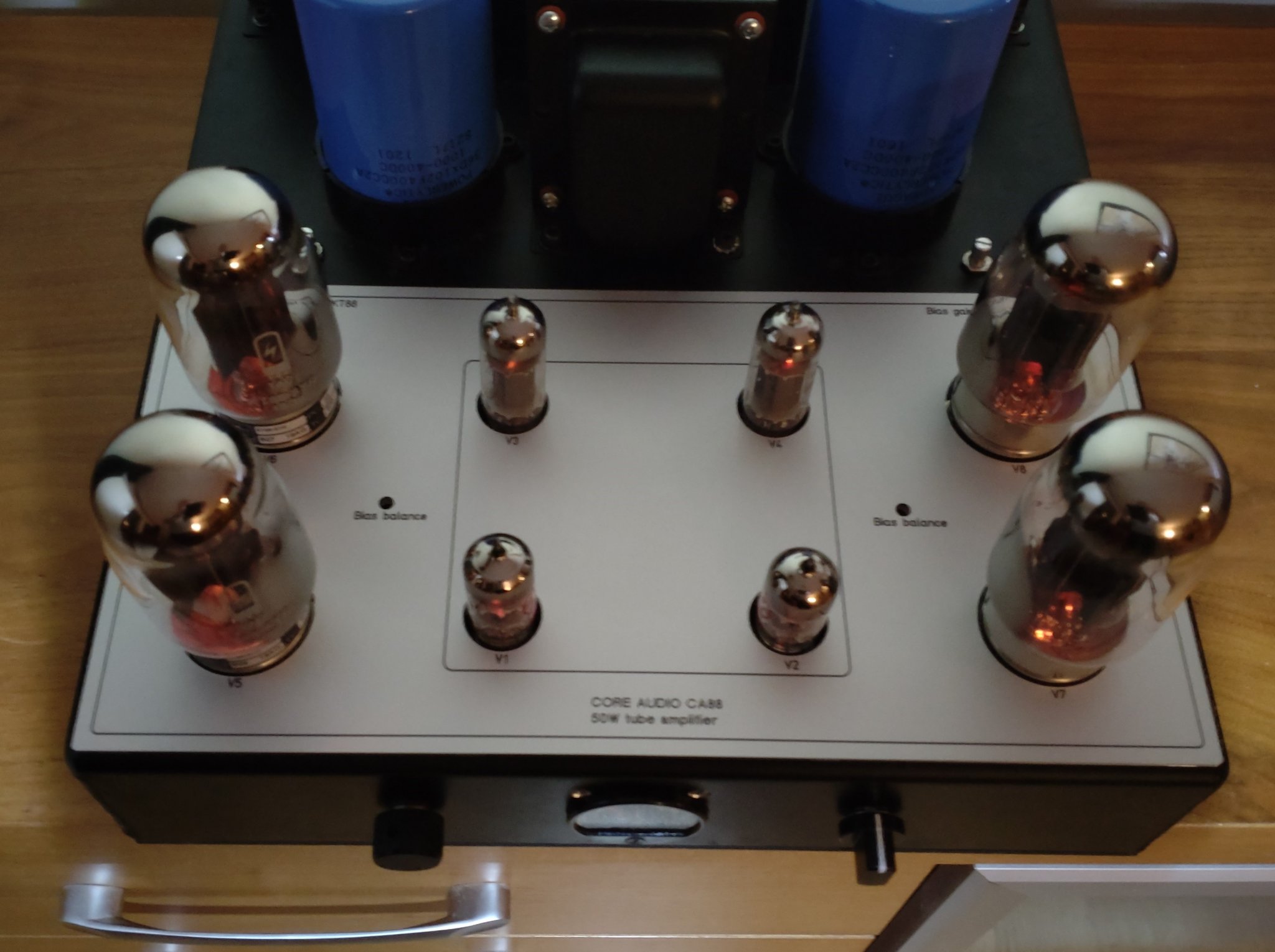

Attached is the only picture of the amplifier in this thread. How can you deduce from it without a doubt that the two channels share one power supply? I can't. I think I can see three pieces of iron on the picture. But even when the two channels do share one PT, there still must be more than three pieces of iron since the minimum is 2 x OPT, 1 x PT and 1 x choke. And if there really is only one PT, how can you deduct from this picture that this one PT doesn't have seperate windings for the two channels? I already know the anwer on this one: You can't.
That's why I asked TS about it but the only answer I got is that it is "a normal stereo amp" (see post #13), which to me didn't clearify things.
What I can deduce from the picture is that the power supply very likely is different than the schematic in post #1. The picture shows four adjustable resistors, two per channel. If the two adjustable resistors for bias level would share the same voltage source, adjusting one of them for lower bias would lower the bias of the other channel too, which ofcourse would be absurd.
And what about the 529 Vdc from 380 Vac with half-wave rectification? If you are a competent troubleshooter, you surely must be able to shine some light on this...
