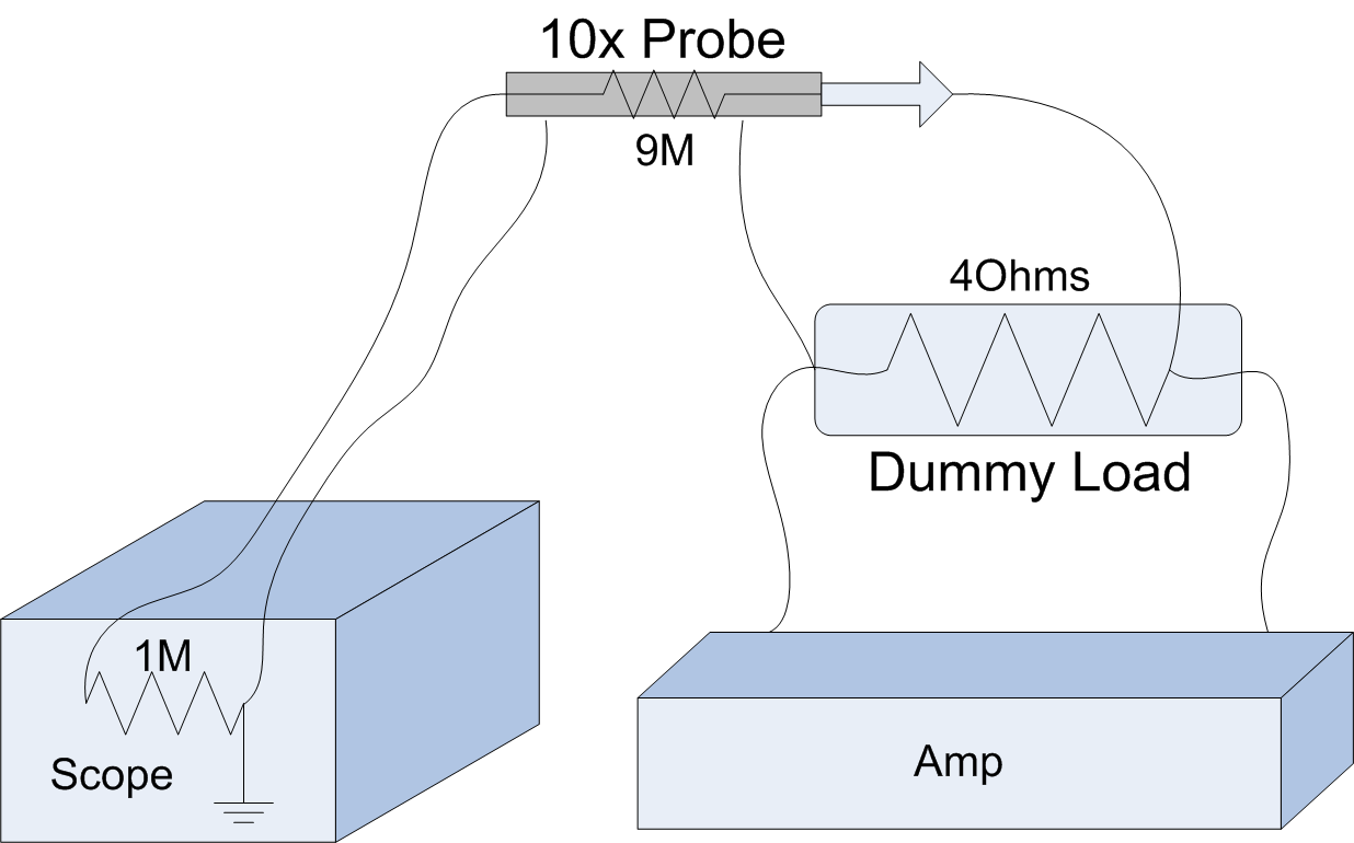

One (probably the main) advantage of using a 10x probe is that it makes the impedance of the scope 10 times that of using a direct connection to the scope's input. This won't matter for most measurements, but for high impedance circuits such as the grid of a vacuum tube, 1 meg is a substantial load and will change the measured voltage, and 10 meg impedance of a 10x probe will give a more accurate reading.
I use my scope for testing new amplifiers.
The first test is for DC fault on output.
I connect scope to output and power up the amplifier and check to make sure there is zero volts on the output. If the voltage is to a rail I power off and find the fault.
If it is close to zero I trim the DC adjust pot to get zero volts.
The next test is setting up the bias pot.
I apply a sine wave and monitor the output on the scope.
To start with there will be crossover distortion.
I slowly turn up the bias until the crossover distortion goes.
Job done.

x1 probes are quite slow and round off square waves, attenuate spikes etc but will be usable for non critical audio. Typically, a x10 probe lets the scope work to its full bandwidth specification, cheap ones are rated to 150Mhz but this is with x10. Most ordinary probes are rated to 600v max.
