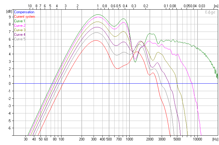

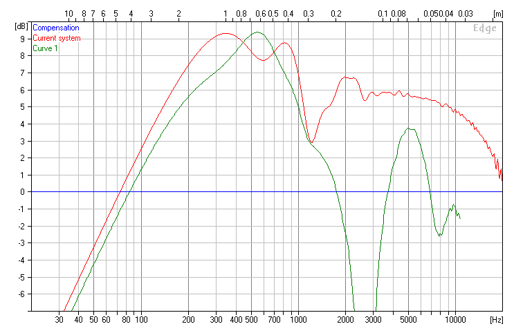

I went ahead and did it for you. See attached. The speaker is modeled in the Edge as shown in the first image. I had to do it in two steps, one with the two woofers, and then a second for the middle FR driver. This listening axis is 3m away directly in front of a speaker at the height indicated by "mic". I plotted these on the same plot so you can compare the responses. It is important to note that this is ONLY the open baffle gain/loss curve and does not include the drivers' own free-air responses. Those have to be modeled separately. But we can keep those in mind and take a look at the effect of using the OB to see what might happen.
The first thing you can see is the OB gain/loss curve drops off below about 300Hz for both drivers. This depends on the baffle size only and that is why it is similar for both drivers. This is the HIGH pass effect I mentioned above.
The next thing that you can see is that the woofer gain/loss curve drops like a rock above about 700Hz. This is due to the fact that the driver is larger and with two of them you will be very far off axis from at least one of them. This causes interference, thus the dip. Can't use the woofers about about 700Hz for this reason.
Then there is the fullranger. The effect of the OB gain/loss is a significant dip in the on-axis response between 1k and 2k Hz. That's not good since you want the response to be smooth above where you cross over from the woofers. This is caused by the central mountnig of the fullranger in the baffle, and the fact that the fullranger is small compared to the baffle size, so it is like a point source. This is a major weakness of the PAP design IMHO. There is nothing you can do to completely "fix" this.
In the third plot I show the on and off axis responses for the fullrange driver. As you move off axis the response falls in level, e.g. at 300Hz on axis is the top curve and as you move off axis you move down the curves. It is easier to see how there is a hole around 1.5k Hz. Also, the depth of the dip is different for different off axis angles. This means the crossover cannot EQ the dip out the same for each angle. So you will have to live with it to some extent. It is only about 3-4dB but you will hear that. You can try to fill it in with some EQ and it might be OK.
So, with that info in mind, here is how I would approach the crossover design. Luckily you have subs. I would either cross over as high as possible from subs to woofers, boost up the woofer response below 300Hz, or cut the woofer response above your desired crossover point to the subs. This will flatten out the lower part of the response. Next you need to cross over to the fullranger, and that has to happen no higher than about 500-600 Hz. Then use some EQ to fill in the 1.5kHz dip. Finally you will need to balance the relative levels from the two woofers and the fullranger in order fort he overall tonal balance to be accurate. After that do some voicing EQ.
