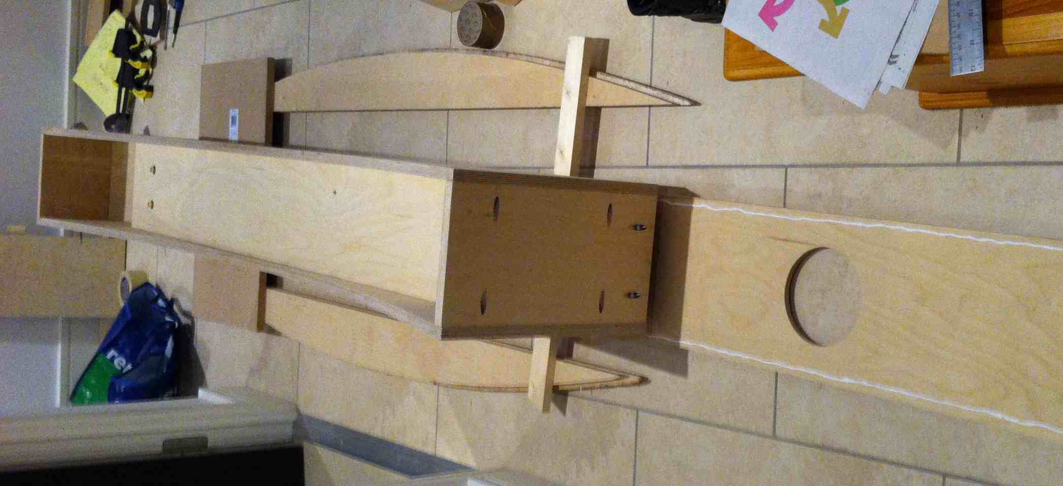

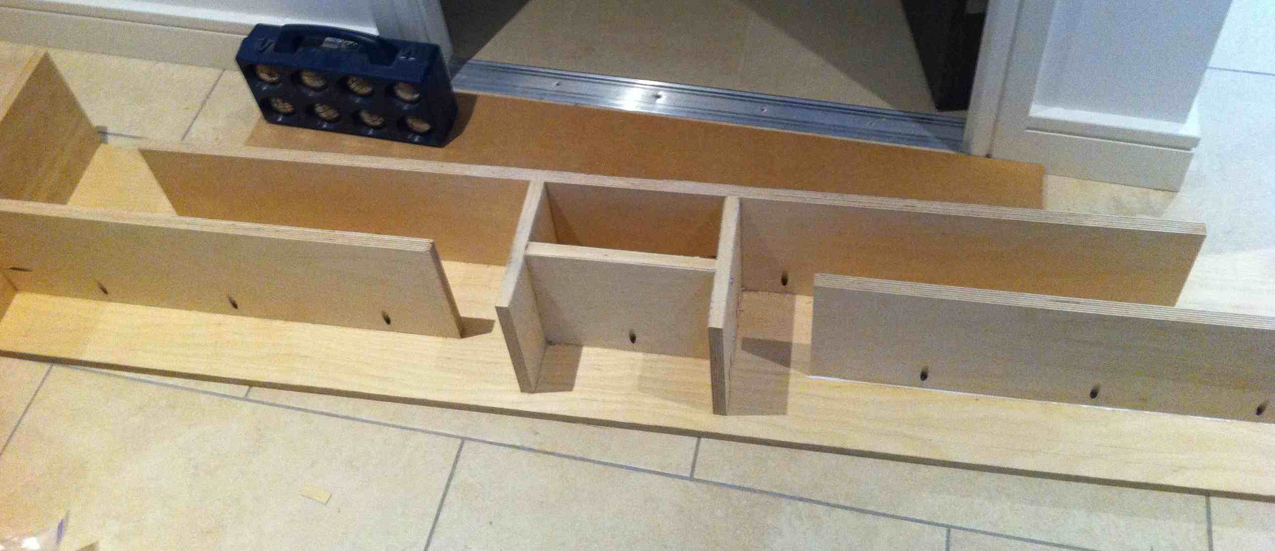

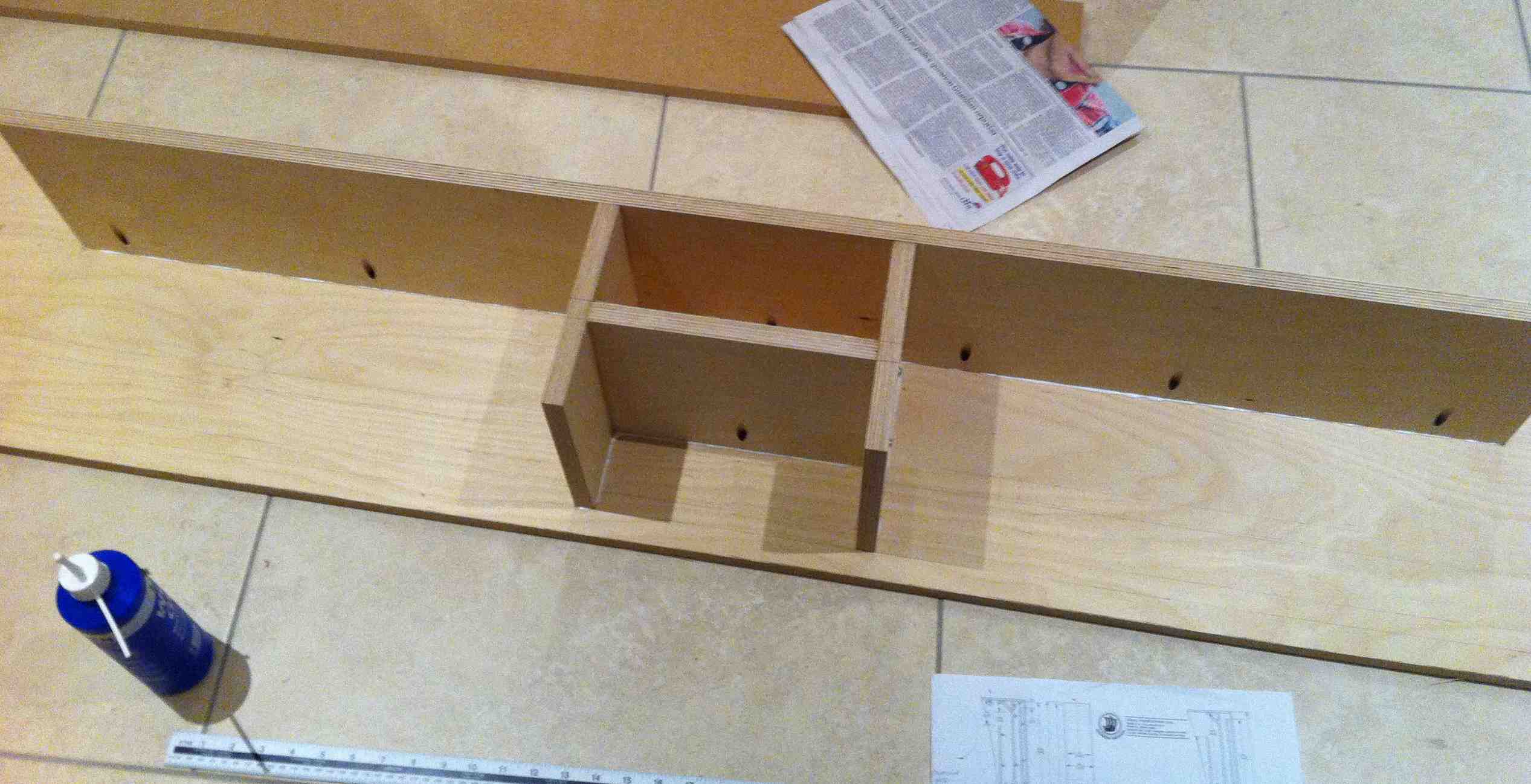

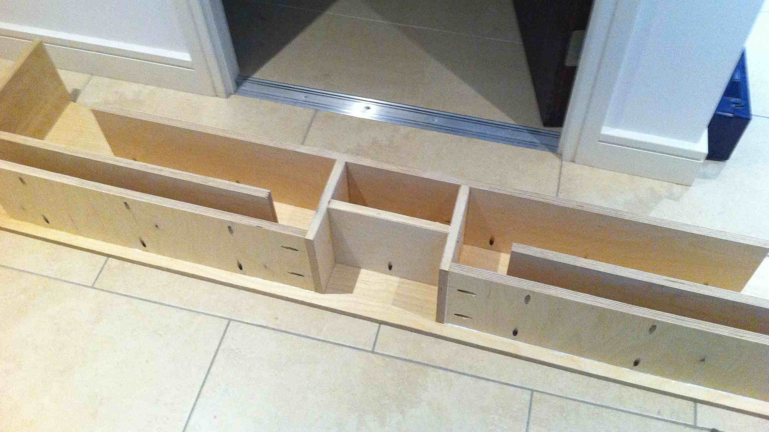

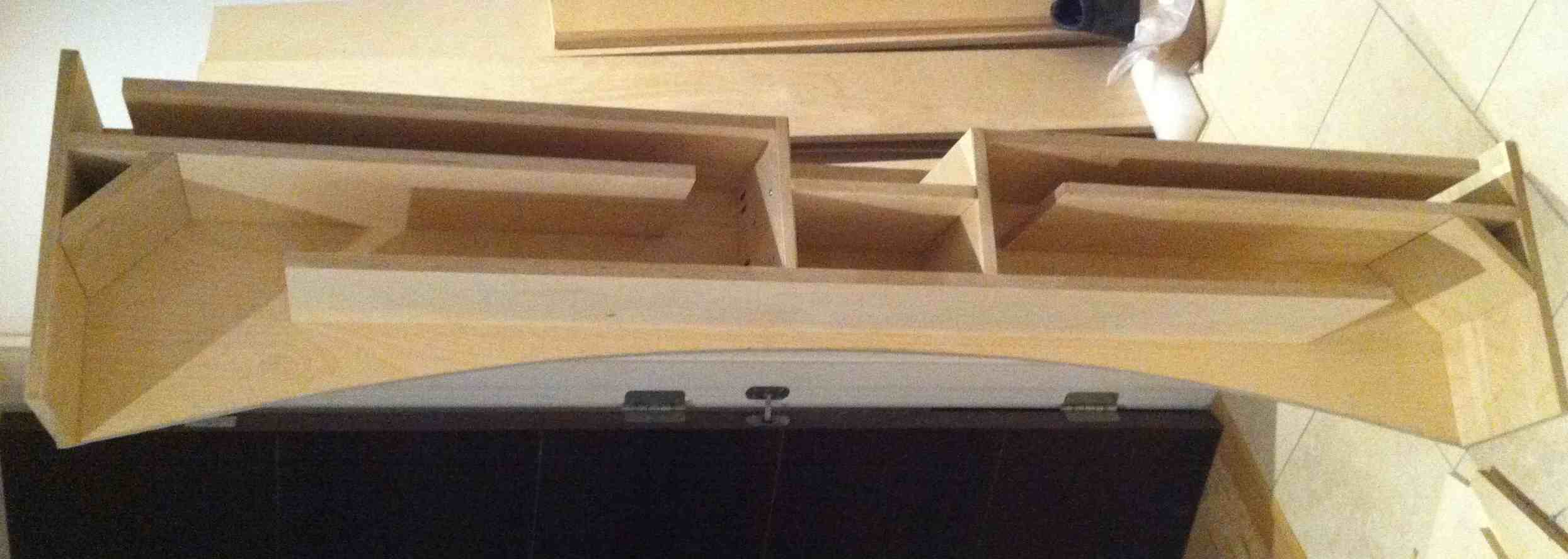

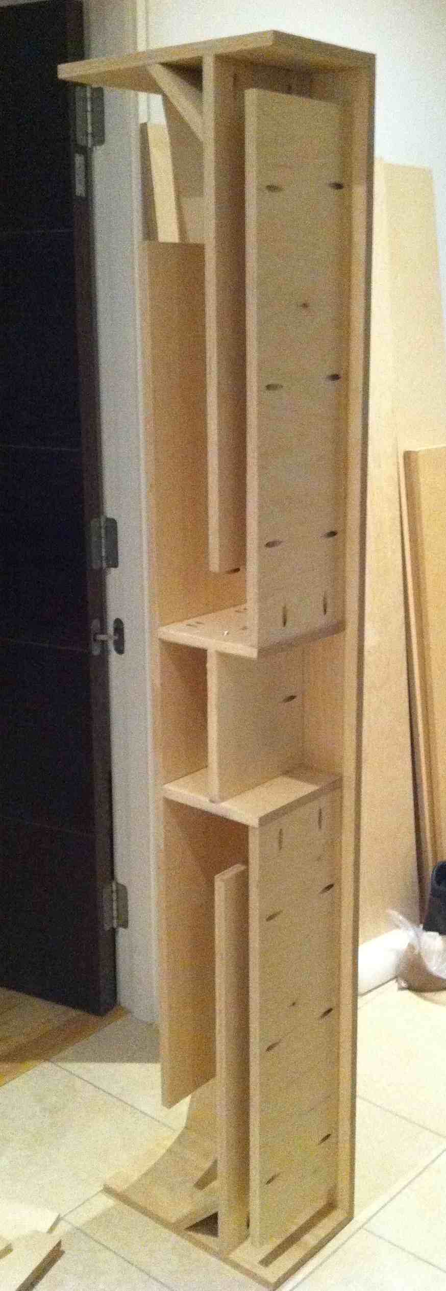

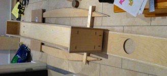

I'm working on the Victor (similar design), and plan to spray a expandable insulation foam in the void behind the compression chamber etc., to keep the weight down. Any reason why i shouldn't?There's a couple of deadspaces, I used dried sand to fill these.
other than it's a lot harder to remove than granular materials if you get undesirable artifacts, probably not

...what are the chances of that happening?other than it's a lot harder to remove than granular materials if you get undesirable artifacts, probably not
uncertain - hence the "if" not "when" - seriously, has anyone experienced grief with this technique, or had opportunity to compare to sand / kitty litter, etc?
What would you do if you were unhappy with the granular material? Drill and try to shake out?
I'll usually install the input terminal cup at that location, or include a large enough recessed aluminum plate to permit access, and the last few grains would need a vacuum.
OK capisco
This large of a void space isn't something i ever dealt with in a build. Honestly i didn't even know expandable foam was considered a technique used, let alone a acceptable one. I'll infer it is since you asked about experiencing grief with it, just not a tech you've used😕uncertain - hence the "if" not "when" - seriously, has anyone experienced grief with this technique, or had opportunity to compare to sand / kitty litter, etc?
If you spray too much foam, for some reason, it turns to liquid and won't harden. So don't spray too much at once.
