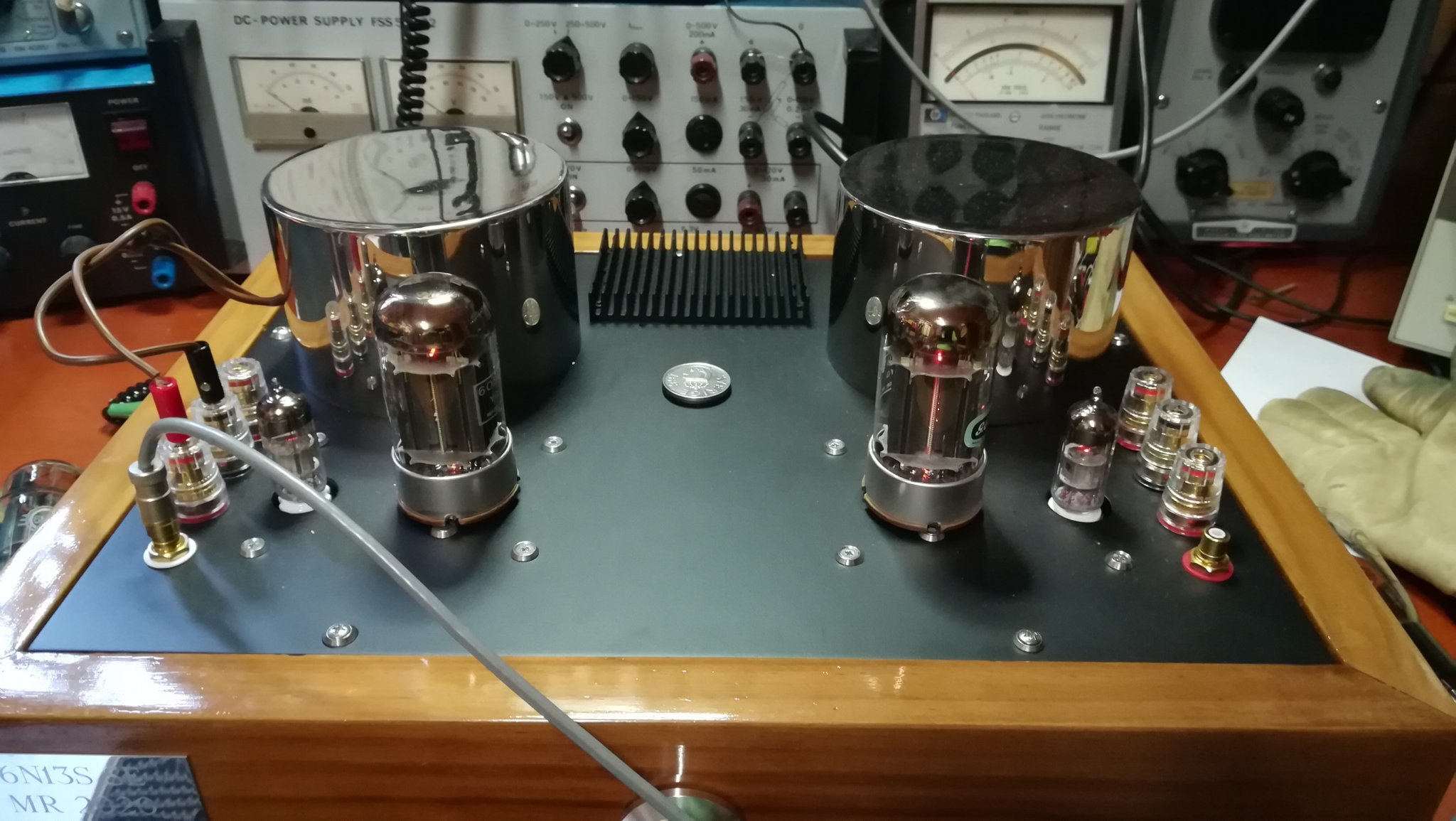

I have constructed a 6AS7G PP with 6SN7 driver and 6SL7 voltage amplifier/phase splitter (schematic attached).
During that process I also simulated a Noval version with LTP phase inverter and hi-mu triode voltage amplifier stage.
In general, optimum operating condition for 6AS7G is Ua = 250 V / Ia = 50...55 mA. Load impedance = 5k. With these values, the AC-signal level required to drive 6AS7 is some 240...250 Vpp. This can be done if supply voltage available for phase inverter is more than 360 Vdc.
6AS7G should be operated with cathode bias, then the overall supply voltage required is some 380 V.
Attached the schematic of LTP-version of 6AS7G PP too. Voltage amplifying stage contains one half of 6N2P-EV (12AX7) and LTP is done with one 6N1P(-EV).

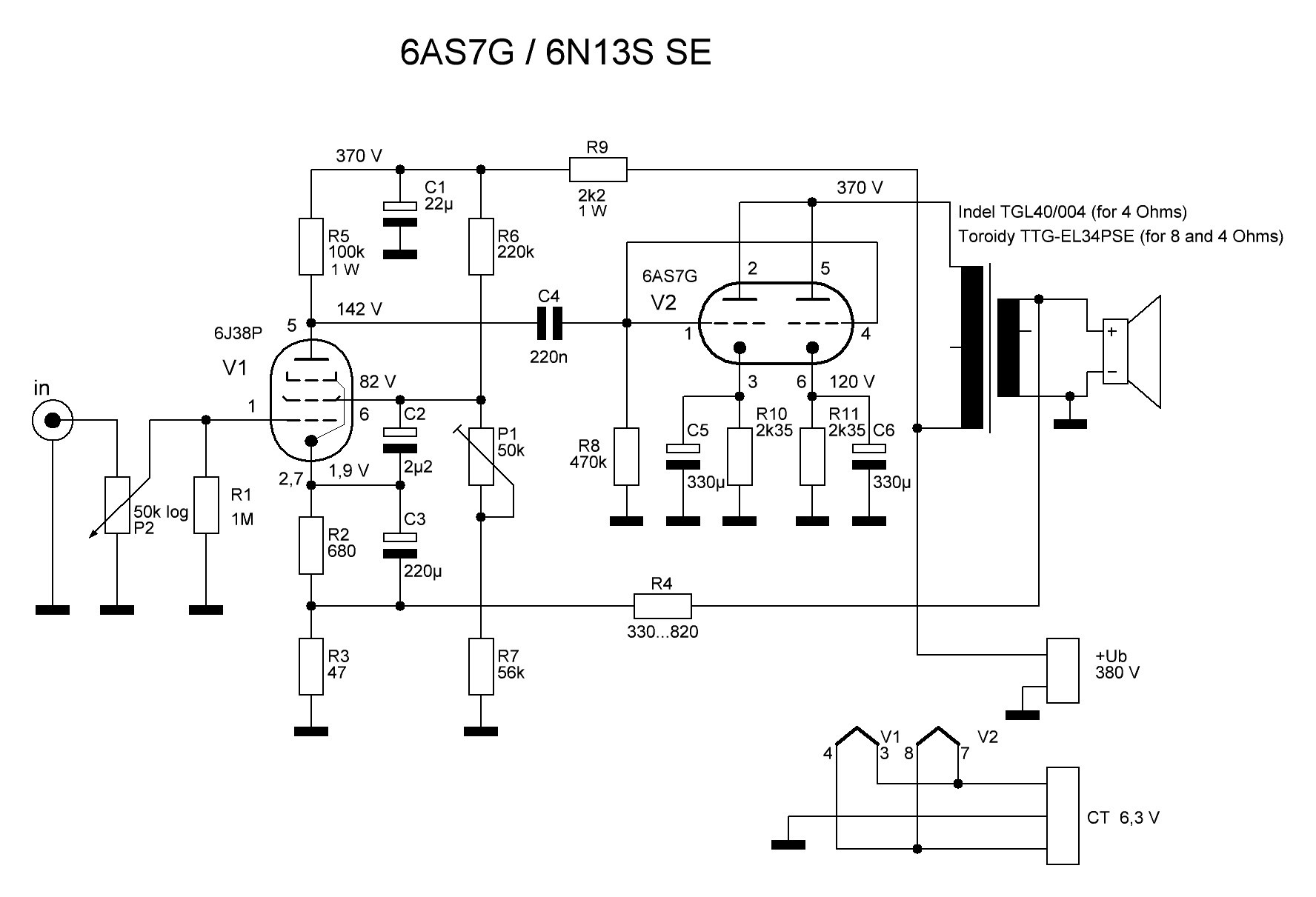

I see that the 6N13S schematic uses one adjustable plate load (82k series resistor and a 47k rheostat).
That provides a method to compensate for the sum of any un-balanced gain of the driver and any un-balanced gain of the output stage.
(With equal splitter plate loads, the splitter balance is automatic/intrinsic; but the driver and output stages are not automatically/intrinsically balanced).
It is perhaps a good idea to adjust the gain balance without any negative feedback applied; and only then apply the negative feedback after that.
Right?

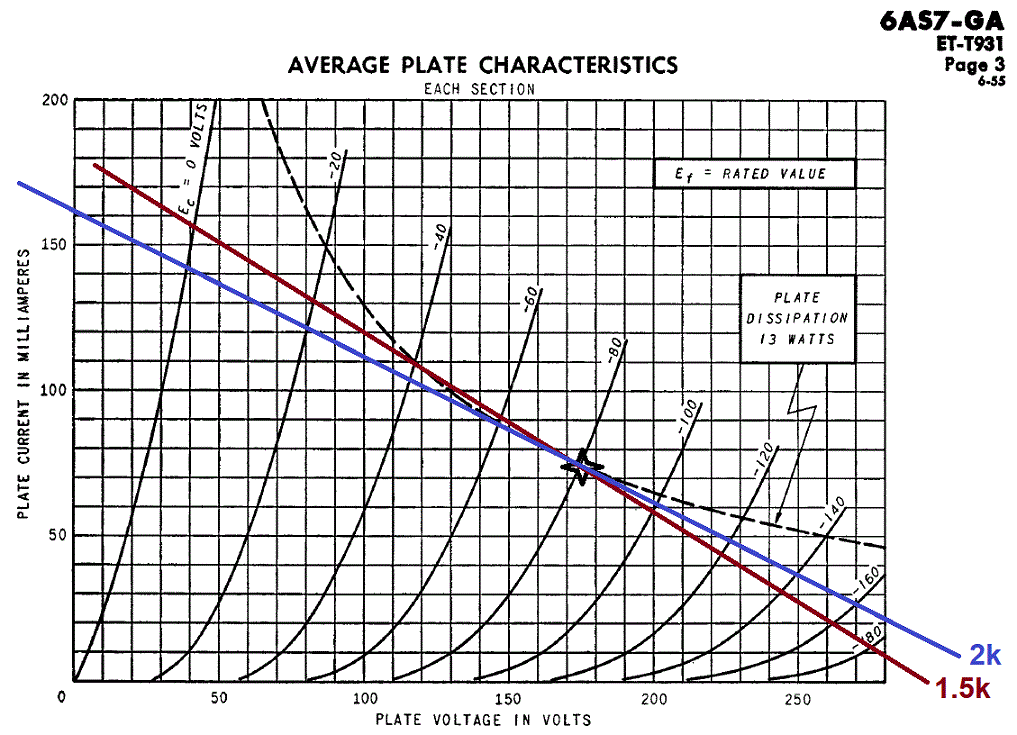

Well... Back when I was building tube amps and I had a push-pull power amp working, I goofed around with biasing output stages with a giant variable voltage regulated B+ supply and variable fixed bias, with a two-stage "dual-diff" push-pull driver stage running from its own +440V B+ supply. From that primitive experiment, I decided I like the sound of the output stage running with a lower B+ voltage and at higher plate current (more in Class A, less in Class AB). I found that as I biased the output stage colder, the sound got somehow 'leaner' and I need to add more NFB to make it sound like I liked it.
So I could see setting a push-pull 6AS7 at something like 175V plate-cathode with plate current of 75mA or so. The grid voltage would be about -81V. That still means you want a driver stage that can swing 150V peak into the 6AS7 grids. The downside is that you'll be burning up like 50W of plate and heater power to get a meager 6W audio output per channel (not counting the plate and heater power dissipated by the driver stages). Not efficient at all, but at least the OPT primary impedance can be nice and low, making it easier to find a well-performing OPT. What would you use for that, maybe 3k:VC? 4k?
On the other hand, a 6AS7 isn't the most linear triode. It's plate curves start leaning over to the right pretty early.

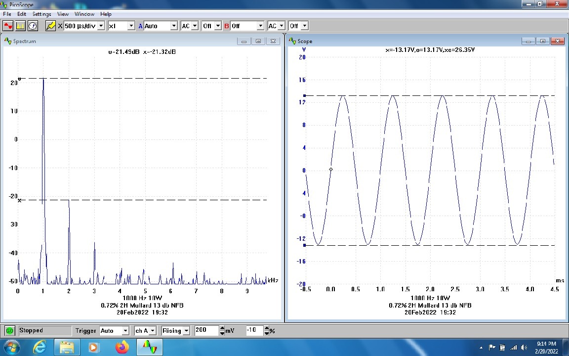

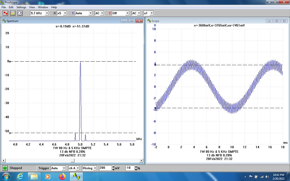

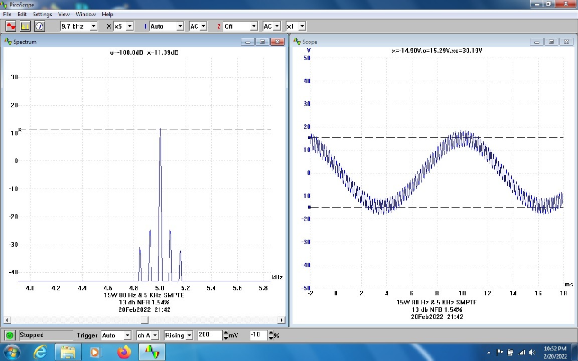

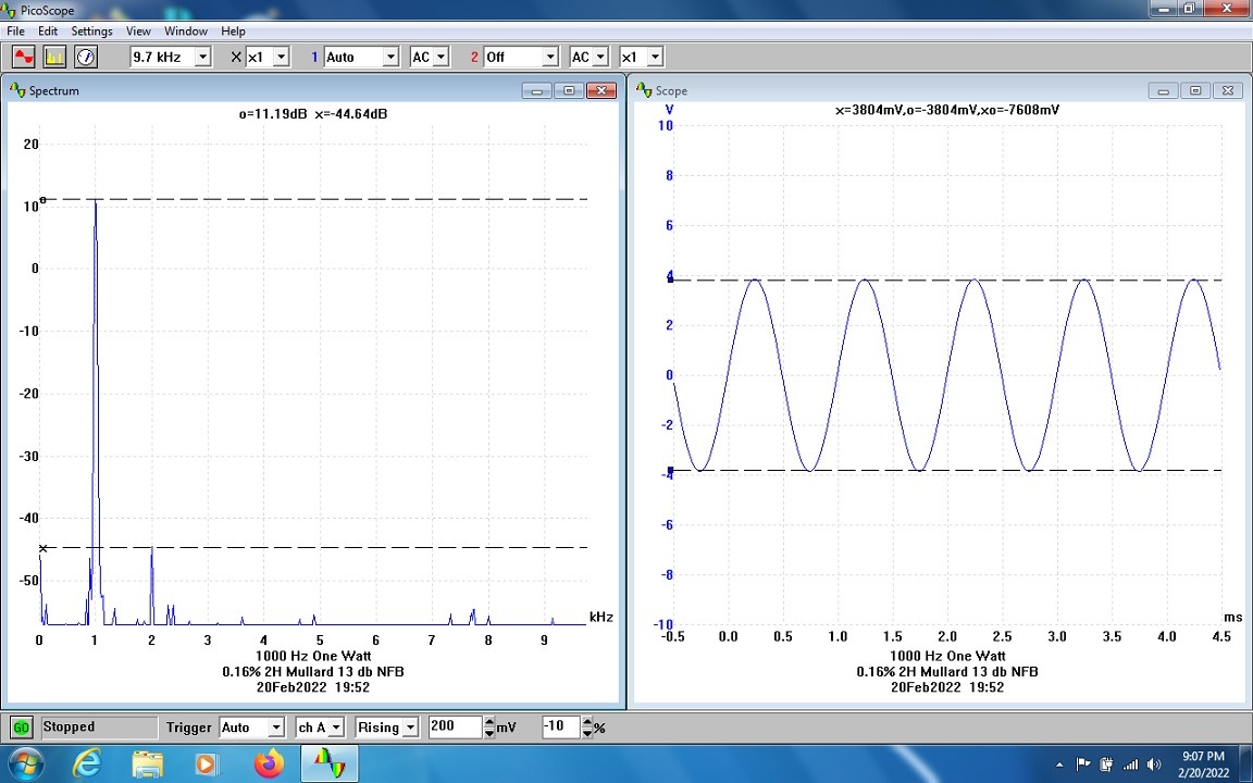

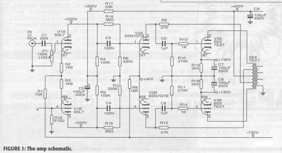

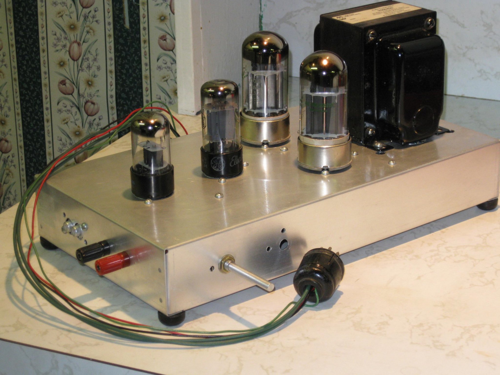

Here is a real live PPP 6080 Amp in hardware, built more than 20 yrs ago.
With a 400V supply about 20W of audio. And it really has a novel driver, a bootstrapped 6SN7GTB.
Unlike most other amp projects here on DIY there is real test data to backup performance.
The often used test 'Sounds OK' is not a great reference.
Each of the 6080 cathodes needs its own Rk. And probably heatsinks. The OPT is a special
built for me by Hammond, 2150 Ohms P-P.

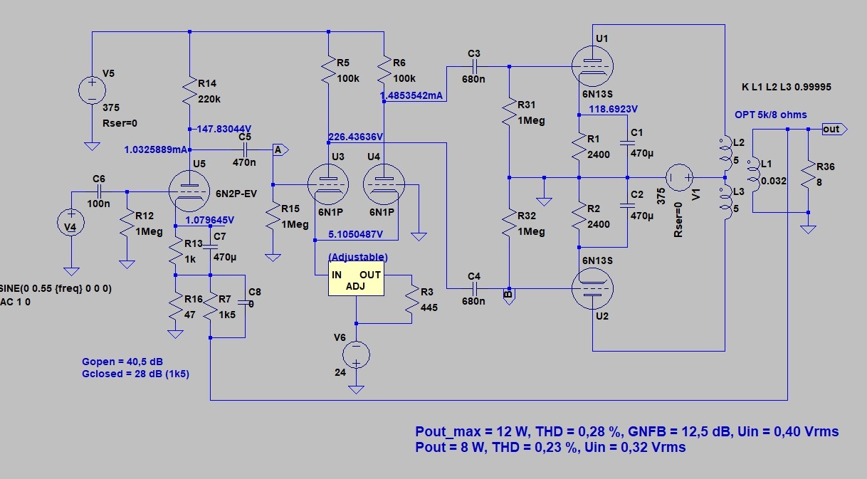

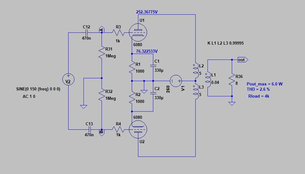

Here is the simulation of the 6AS7G PP output stage with lower (~180V) supply voltage and 4k load impedance.
Compared to 250 V plate voltage, the output power is 50 % less and THD about 35% less. (6W vs. 12W and 2.6% vs. 4%)
With 250 V plate voltage/ 50 mA current, the operation is in class A too.

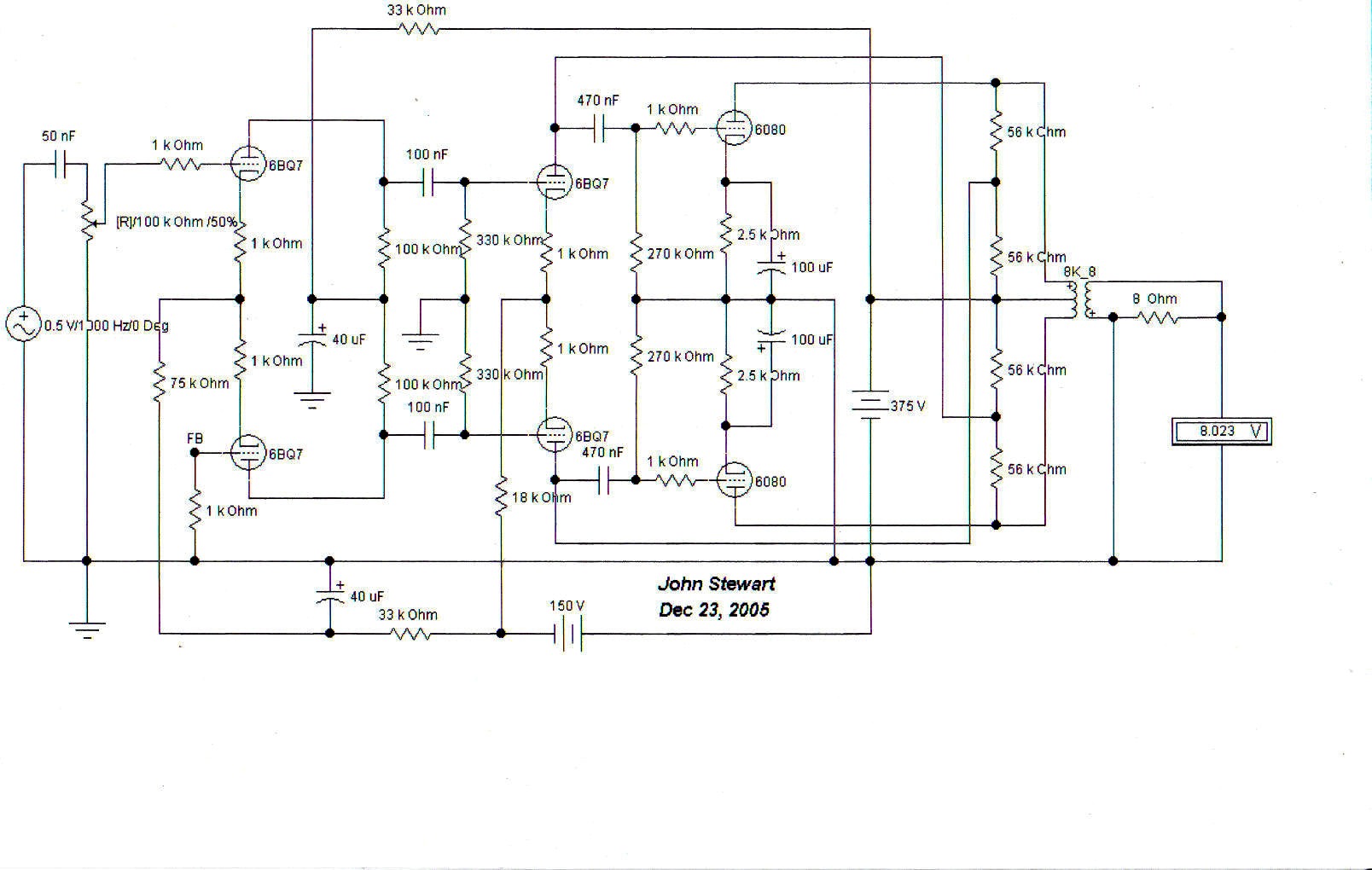

The taps on the OPT are the normal UL taps at 43%. I’d done the initial work on the project with OPT's I had on hand with 20% & 43% taps. Then I went to Hammond with a request for something like their 1650N but ½ the impedance. In the final circuit four triodes in two 6080s drive into 2150 ohms.
Part One of this project was published in the Volume 11, Number 2 Issue of Glass Audio magazine in May 1999. Part Two appeared a month later in Volume 11, Number 3 Issue of Glass Audio magazine. A circuit simplification which avoids the use of the Ultra Linear Output Transformer in the first article is covered.
The original circuit also appeared in short form in the July 1999 issue of Electronics World.
