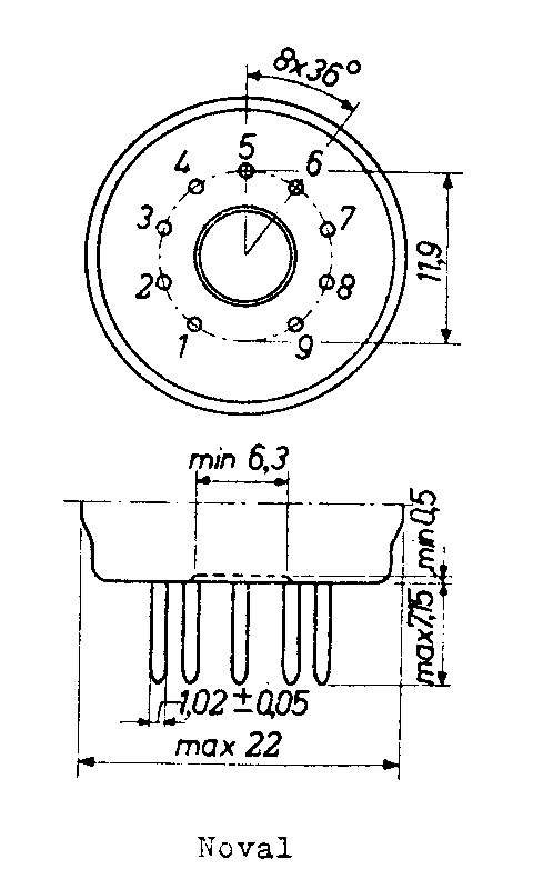

I'm putting together some nine pin noval base tube adaptors, but seem unable to source suitable base pins. They are approximately .9mm in diameter but I can't seem to find a suitable source. Either individual pins over 10mm long or stiff wire of the appropriate diameter would do.
Has anyone come across this or have any ideas.
