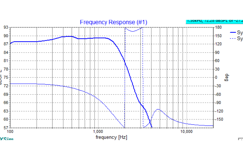

As I have low power and want high efficiency, I am looking to minimise the insertion loss of the filter, and I therefore guess at the following instead of Lar's values.
0.1mH, 15uF, 15 ohms all in parallel.
This gives just over 4kHz, which is where this driver has a peak. The peak is not great so 15 ohms resistor seems to give enough filtering. Result looks good in Xsim, as well as having less of a peak, the little that remains is now 5dB further down at about -25dB. Very small loss of sensitivity, but I think the main series inductor can be reduced by 0.1mH (to restore the same BSC) which should restore the sensitivity.
Looks good to me, but what do I know.

With low power SET considerations in mind your approach is sensible. Maybe some graphs or a screenshot would allow others to nod their heads in agreement.
Did you take measurements to help understand baffle step, or did you use a diffraction tool to indicate what is needed or calculator?

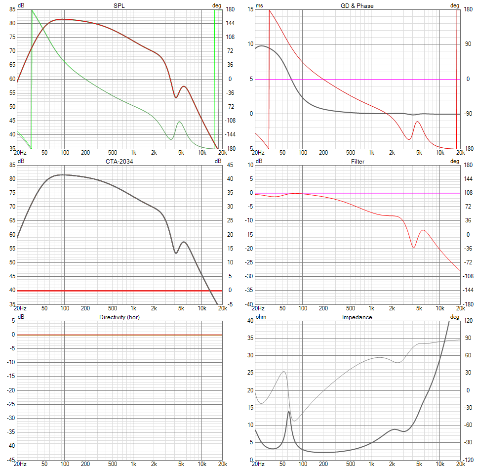

Frequency plots of woofers only, with crossover in place. First with notch then without.
Hope this is useful.

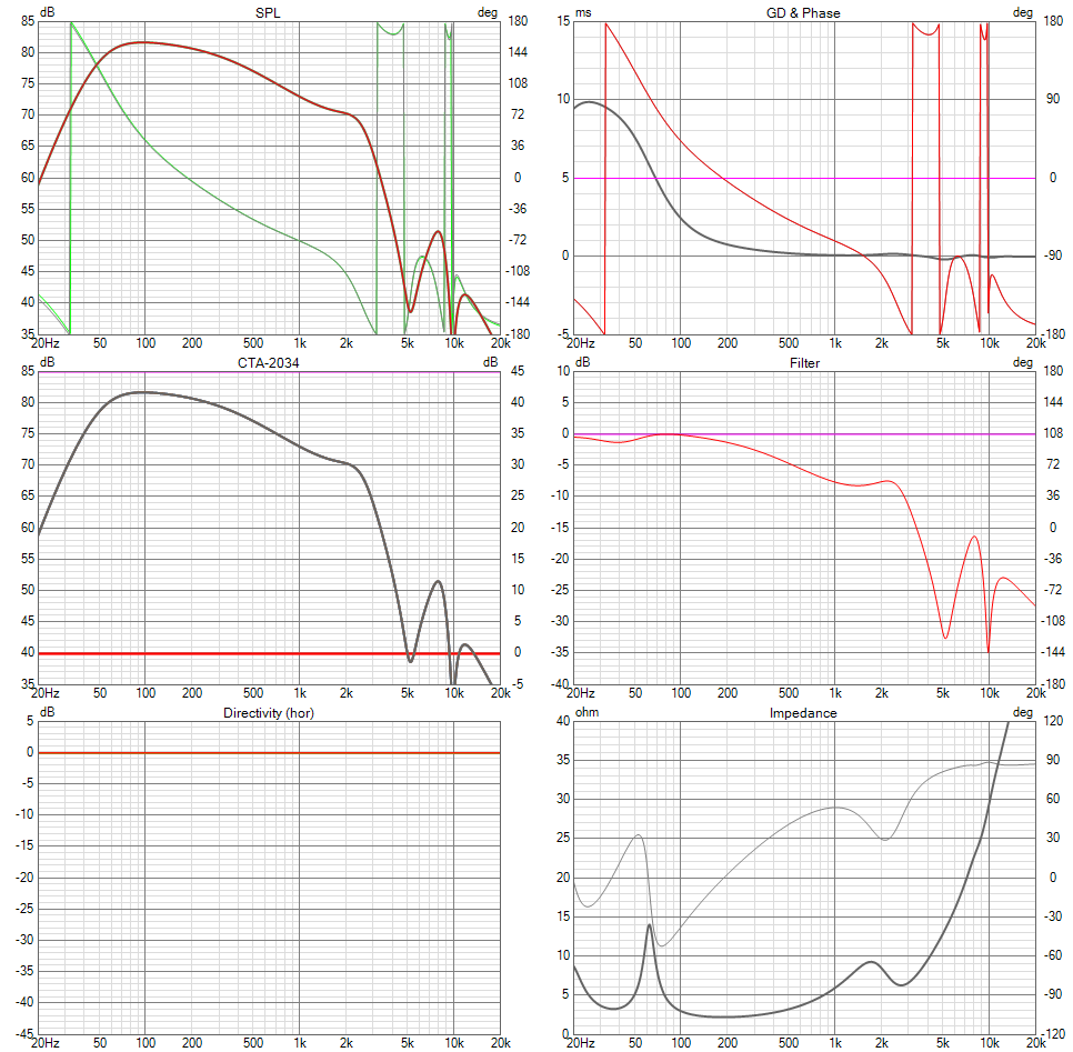

Just for clarity you are using the same aluminium coned driver as the application note but the 8 ohm version used in parallel to give you a four ohm target impedance? I ask as maybe a paper coned Purifi will have different break up/resonance modes.
The graph indicates that your filter works around 3-3.5Khz as far as I can tell, it seems to be effective. What does the impedance look like ?
As the application note is a massively useful piece of information with a thorough explanation of the reasoning behind it you are not tempted to do anything about the notch for the highest frequency peak and achieve minimum distortion profile. Again frequency and impedance information should let you see you are still within limits for you SET solution.

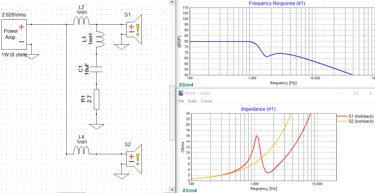

The series notch seems to work by taking extra current to drag the signal down, which may not be good with my low current amp?
The parallel notch seems to work by blocking the undesired frequencies, seems kinder to the amp?
At resonance, the L and C (in parallel) go open-circuit, kind-of. They work together to block current from outside of their loop, so the 15 ohm resistor is where the signal gets carried and appears in series with the speaker.
This is beneficial because, as we see from the force equation
F=BIL
current is the key ingredient that the amplifier ultimately tries to control in the speaker, where B is the motor strength and L is the length of wire suspended in the magnetic field.
The speaker impedance tends to be unstable, and changes with coil position and magnetization of the magnet iron (etc.). Therefore, adding 15 ohm to the total 'R' in the
I = V / R
equation stabilises the total impedance, which then stabilises the current.
The series notch (in parallel with the speaker) doesn't do any of that. At resonance, the L+C work together to form a short circuit, so the R component shunts current adjacent to the speaker. This could be effective at reducing levels if the amplifier has high impedance, but it does nothing to stabilise current through the speaker.
Don't panic when you look at the graphs, I simply used the mechanical properties of the purify driver included in the VituixCad driver file.
The information simply highlights the difference between the Filter in the app note and your version. It makes it easy to compare the filter characteristics thats all. No Baffle step, no diffraction and no break up included.
