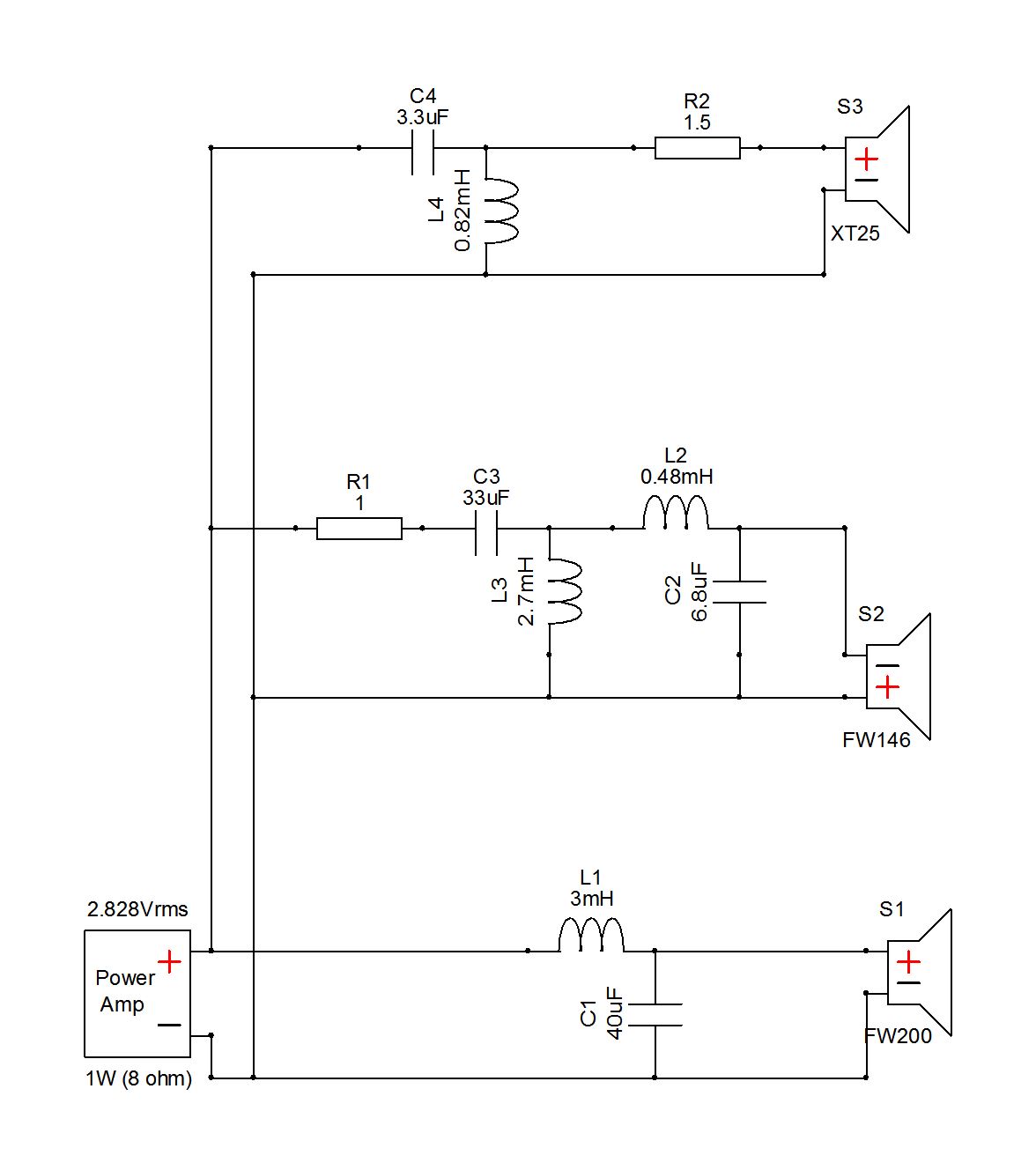

Here am I again with the speakers almost finished.
I took measures from every driver installed in the bafle and simulated a crosover... but I really don't know if thats the best solution.
Can anybody help me?
Attached you can find the measurements files and the designed crossover with Xsim free crossover designer:
http://libinst.com/Xsim/XSimSetup.exe
Can anybody help me to improve the crossover?
Thank you in advance
I really can't say if it'll sound any good, but see how the sim goes when you add a 0.2-1uF tank to the 0.48mH mid filter coil. Notch effective around 5 to 10kHz anyway. Usually straightens out phase a bit and lose some metal ringing. On a flat baffle, a third order tweeter usually works better too.
