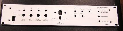

Front panel
The front panel was designed by me and made by www.frontpanelexpress.com. I used their free software and just emailed my design, they made it of 3mm thick anodized aluminum and it cost around $30. I have a much more complicated one for the BOSOZ which was around $60.
The lettering is etched and then filled with ink by front panel express (I have black and blue ink fill on this faceplate). Black is shown below.

Here is my 1st go at the BOSOZ panel with openings for illuminated switches, LEDs . This is designed to match, assuming that one is able to see both stacked on each other through the blinding blue and yellowish light. Hmmm.... I wonder if I should start looking for welding masks to protect visitors?
