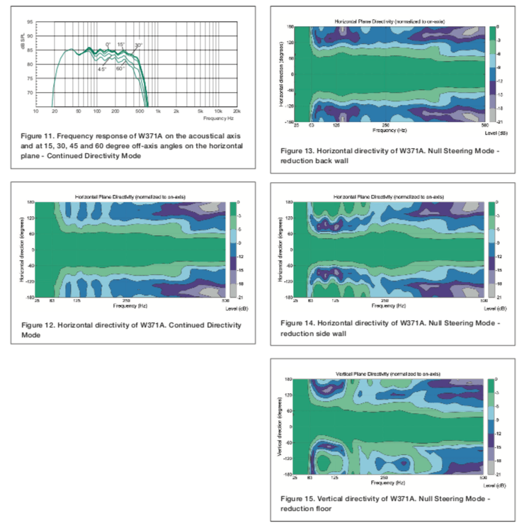

Sound waves are sound waves, and frequencies are frequencies, and because of long wavelengths compared to room dimensions, low frequencies behave differently in small rooms than large rooms or free space.
Having a cardioid (shaped heart-like) pattern makes a subwoofer cardioid.
There is no mention of a cardioid pattern in the W371A user manual, and no free space measurements- in fact the manual states "This product is designed for indoor use only."
The Genelec W371A in combination with a top cabinet and the GLM (Genelec Loudspeaker Management) provides 3 separate functional locations to provide "Null Steering" or "Continuous Directivity Matching" within the crossover overlap region. The three different locations, and their three distances to boundaries are key elements to the GLM.
Again, the directivity characteristic of the Genelec W371A as provided in the manual is not that of a cardiod subwoofer, the patterns show "Null steering" or "Continued Directivity" in the crossover overlap region down to around 60 Hz, the "sub" region from 25-60Hz is an omnidirectional pattern not affected by processing.
Yes, I agree "active cancellation" and "null steering" are somewhat synonymous, though not the same as a cardioid pattern.
