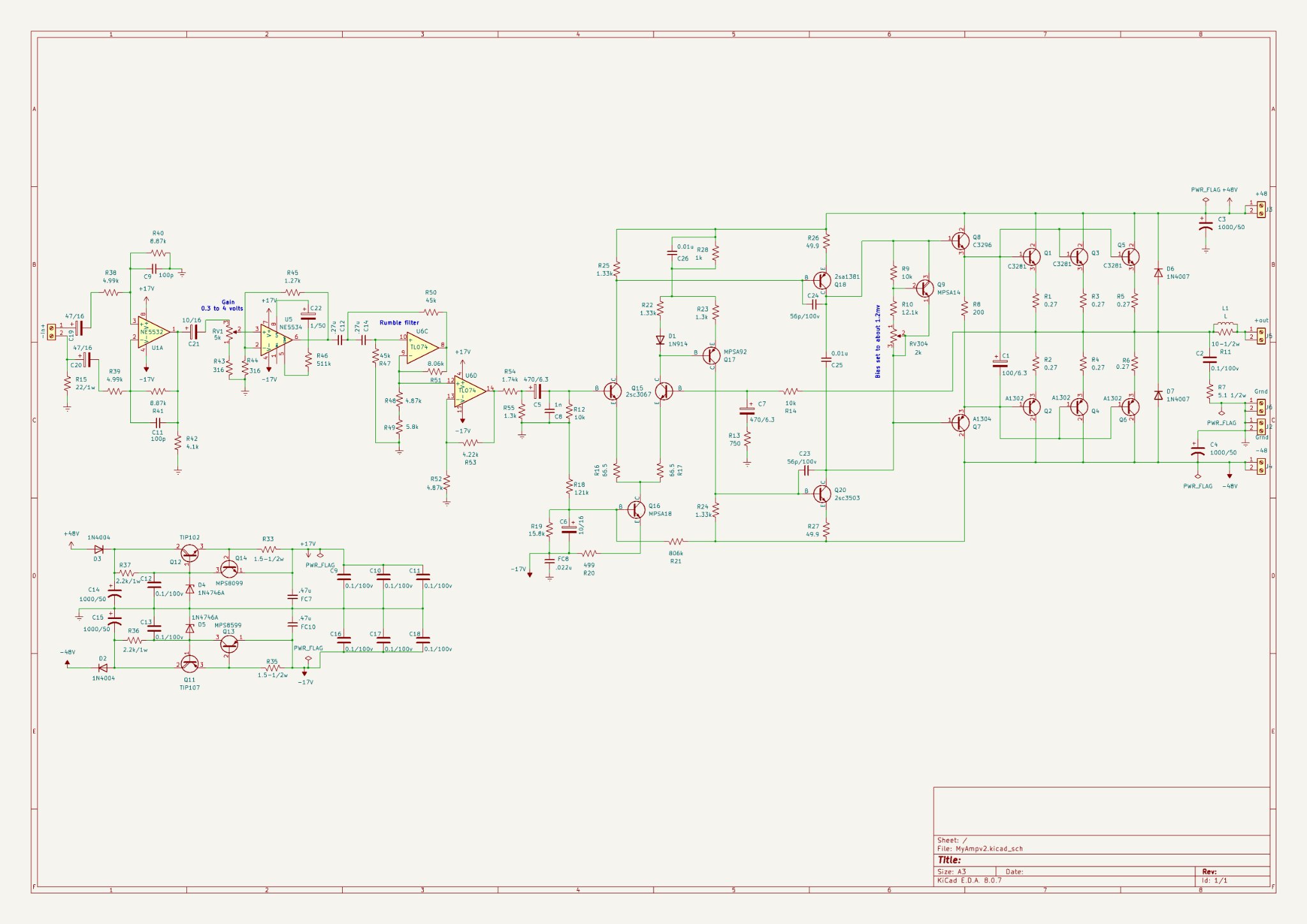

Not sure if I can use these
I'm not sure if I have to change anything on the circuit if I use NJW1302G/NJW3281G in place of 2SA1302/2SC3281
Only thing Not sure of is the difference Collector−Emitter Saturation Voltage
2SC3281/2SA1302 Collector-emitter saturation voltage IC=8A ;IB=0.8A VCE(sat)− 2.5 V
NJW3281/NJW0302 Collector−Emitter Saturation Voltage IC = 8A ;IB=0.8A VCE(sat)− 0.4 0.6
Everything else, I think looks ok.
You guys are the experts

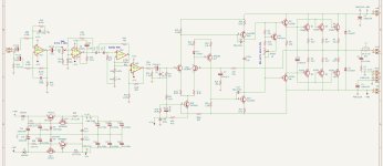

Circuit I'm working with is attached
Thanks all
Scott
