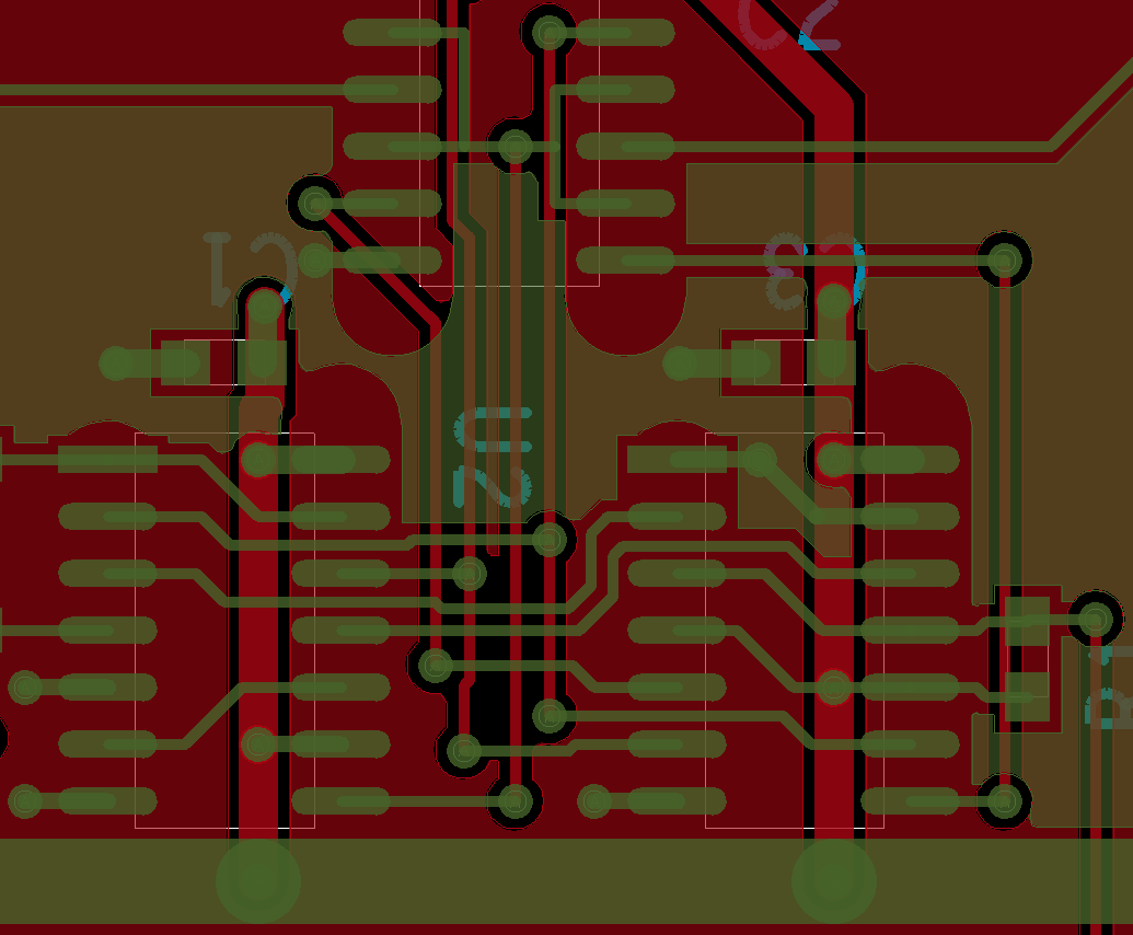

Just for a bit of fun and info:
Its not often I use the 1.27mm pitch SOIC's these days, so I had to delve into an old design. These are 1.27mm SOIC's routed using the 0.05mm recommended grid. It is just for information, but as you can see It still looks neat, ie orthogonal tracks and 45® corners. With most EDA packages if you start the route from the pad it will put the first via or corner on a grid point that centres on the pad and on the 0.05mm grid. If you did it the other way the track would be slightly of centre of the pad, but still be acceptable.

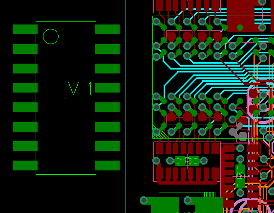

To show the contrast between SOIC's and some of today's components, the second picture shows a 16pin SOIC next to a bit of a DDR memory interface, the ball pitch is 0.1mm in the X and 0.8mm in the Y axis. The actual pads for the BGA are smaller than the vias (light green with grey drill hole), the finished hole size for the vias is 0.25mm, track and gap is 0.1/0.1mm. This is standard geometry these days with PC's etc, the next generation HDI gets even funkier.:eek:
http://www.pshk.org.hk/Activity DOC...chnologies/08 Miss Tarja Rapala 20.2.2009.pdf
