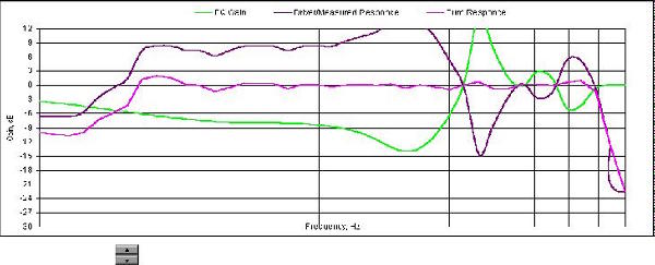

Equalizing
The only way you'll ever know what’s going on is to take some SPL measurements, at least every 1/12 octave from 15-100Hz. I bet you'll find a major peak, and at least one null somewhere in that 50-80Hz boomy range. It's time consuming but simple and all you need is a cheep Radio Shack SPL Meter and burn your own Test Tone CD, then use Excel to plot the graph. IMO all subs need at least some equalization, no or configuration is perfect. My dual Maelstrom subs were very boomy at 45Hz and 84Hz I found a 12db peak and there was a serious null at 56Hz on my right sub, but the Left sub had a null at 40 and a peak at 47Hz. After spending $115 on a BFD and about 3 days of measuring and adjusting I have everything within +/-3db from 15Hz to 80Hz, and it sounds so much better, I can’t even think of ever having a un-equalized sub again.
