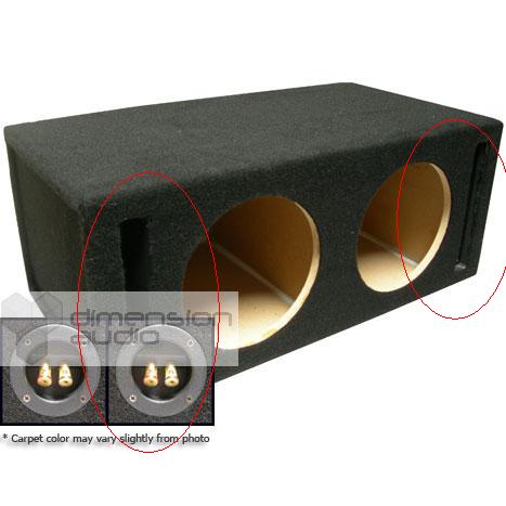

I can't really go the new amp route with more power...If I do, I will have to upgrade the alternator as it will be too much current. It's not the amp so I might either go the custom ported enclosure route or look into getting some new 12's. I think these JL's are like the bottom of their totem pole, the best bang for the buck even though they cost me about 160-180 dollars for the pair. I should have gotten something else. I was looking on some stats on subs on Crutchfield and I might look into getting a pair of Boston Acoustics G212-4 as the sensitivity rating is almot 3db higher than the JL's I have and the JL 12W3v3's. "The higher the number, the louder the speakers will play. An efficient speaker helps you maximize your available power." Per Crutchfield's explanation so it ould probably provide the extra thump I would need or I could always still go with 1 15" as 1 Kicker CompVR provides 89.1db but 1 12" Boston Acoustic provides 89.6 so if you have a pair of those I would get more bump for 2 12's than 1 15". Again, I'm in no hurry as I'm just waiting to ge the credit card down some more and waying my options. It's still good that I atleast have a pretty decent system at the moment while I contemplate things...
Hmmm....Asked the guy who would be making a custom ported box for me if the ports are on the front, each side on the front, or on the sides of the box. I asked because I told him the box would be facing the back of the trunk. He said:
"The enclosure has one vent to the right side, the subs and the vent fire in the same direction. Running the subs in the same ported chamber gains you one to two more db of output."
My big question about this is...If you have vents on one side, how is that going to effect the amount of bass you feel? Especially on just the right side. I don't like that setup that much. It doesn't seem to work for me for some reason. I want to feel the impact of it more but not just on the right side of me. Anybody had any experience with boxes like that? I mean, I know the ported enclosures that come from Kicker with subs in them have 1 on each side...I never heard of just 1 total on one side of the box. Funky setup....
It is not directional, either the box will work or it will not. Should not matter how many ports so long as they are large enough and properly tuned. What way they point, really should only matter in SPL and depends on the car.
port location is very important in a trunk car, placed in the wrong location will cause cancellation....for example if you have a box with 2 subs and slot port on the same face down the middle, if you stick your head between the sub and port, this is where it is quietest....the output of the sub and port are out of phase with each other.
port on the side for a trunk box 'usually' works better than others.
the side port will couple with the cars body better, just make sure there is room for it to breath.
I guess I'll just let him do what he feels is best. I'm just paying a lot of money for this box and I don't want to get it and try it and have it sound like junk and I would have just blew away all that money again. Here's a attachment of what I was wanting him to do with the ports. It's hard to see the ports on the front of this example so I circled them in Paint. The circles aren't too thick but I don't have any other program here at my work and I don't see any way to change the size of the line. Is this a bad idea for the location of the ports? Like I said before....I want to FEEL the bass as well as have good sound and I still feel that if it's on the right side only (Not front right) of the box it's not going to work out...
