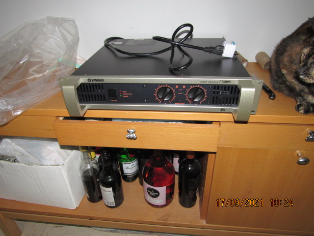

A small question for the "Brains Trust" Being a stage / Studio amp it works with low impedance loads, what would it be like using big 16R speakers? I need to assemble something to soak up the power and keep up with the H/T mains and can wire in series or in parallel.
I could also stack a 3 existing small boxes and wire them series / parallel for a 4R load.
Said boxes being 1 * 12 " 8R plus 2 * 9" 4R
It's a cost based purchase really.
Parallel speaker connections are to be preferred. When speakers are series, each driver is fed through impedance network of the other drivers in the system.
Yamaha claim each channel will drive 2Ω to 1600W peak, that's 800W each for two paralleled 4Ω systems or 400W per 9" driver. The other channel will simultaneously drive 750W peak into your 8Ω 12" system. That's a faceplate rating of 2350W total. I would have thought that to be elegant sufficiency for the application.
If you were to series the two dual driver systems then the faceplate power available from the amplifier would be 1500W peak total, but would be distributed as 750W for the 12" and 187.5W for each of the 9" drivers, not such an elegant distribution of power between the drivers.

This amp may turn out to be a counterfeit.
How do I tell a fake from a real one?
Underneath is a large bolt usually found securing a toroid and P7000s should not have that.
I have contacted the seller and if it is a fake I'll request a PayPal refund
