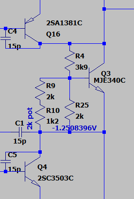

common 3503/1381 could be used for Q4,Q16, Q11, Q13, Q17, Q18
Think it would really wake up the performance.

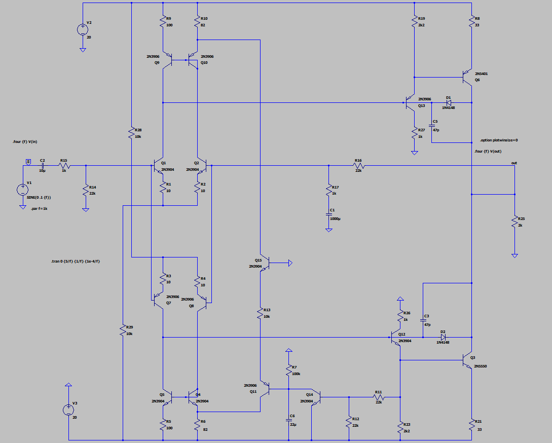

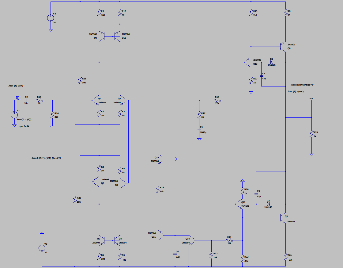

The output swings between that range -50 mV to +50 mV as expectedIf you already built a dozen or more of them, checked the bias currents of Q16 and Q4 for each of them and found that the spread is perfectly acceptable, then I agree. In that case, apparently the offset of the input stage and the current gain of the second stage is small enough for the conceptual issue I found not to be a big deal in practice.
If this design only exists as an LTSpice simulation, then I would advice you to put a DC voltage source in series with the base of one and only one of the four input transistors, do a DC sweep where this voltage source is swept from -50 mV to +50 mV and see what happens with the DC currents through Q16 and Q4. It's a simulation that can be run in a few minutes and it will give you an impression whether the issue I mentioned is a big deal or not.
They do track and the LTP gain is kept below 20dBI just now saw this thread. A mismatch in the differential pairs will cause Q4 and Q16 to have zero current or to burn out.
The differential pairs loaded by current mirrors have too much gain. A "feature" of the fully complementary amplifier is that the gain must be relatively low in order for the two halves to track.

The two control loops are antagonistic, think slewI agree with the guys expressing concerns. Was just thinking about it in a different way, which would be more along the lines of what might be its dynamical response be in the presence of noise? Say, for example, if one kicked one of the control loops to upset the output, then what would the dynamical response of the other control loop be, and how would the two loops settle (assuming the excited mode is sufficiently damped). Even if stable, what might the effect on sound be, depending on particular mismatches?
Pls share your implementationI was thinking of a fast common-mode loop, one that also ensures the signal currents through the two transistors are equal, rather than a slow one.
What happens with the currents through Q16 and Q4?The output swings between that range -50 mV to +50 mV as expected
Did you apply the offset to only one of the four input transistors? If you did, I don't understand why the output swings from -50 mV to +50 mV.
I thought of something like this, but it needs something extra to protect against destructive latch-up when QCM6 and QCM8 go in saturation.Pls share your implementation

We can minimize complexity by trusting the hfe behavior of the bjt usedI thought of something like this, but it needs something extra to protect against destructive latch-up when QCM6 and QCM8 go in saturation.
After remembering to include the plotwise directive, this seems to work well. The VAS current in both VAS transistors will necessarily be the same, save the OPS input current. So I just sense it on one side and inject a small servo current into the current mirrors (both) that sets the VAS current to a constant defined by the divider R11, R12.
Marcel: " ... a fast common-mode loop, one that also ensures the signal currents through the two transistors are equal, rather than a slow one."

The gain is proportional to the Hfe of Q4 and Q16. It is poorly controlled.They do track and the LTP gain is kept below 20dB
Leach's LTP has a tightly-controlled gain of ~2.
