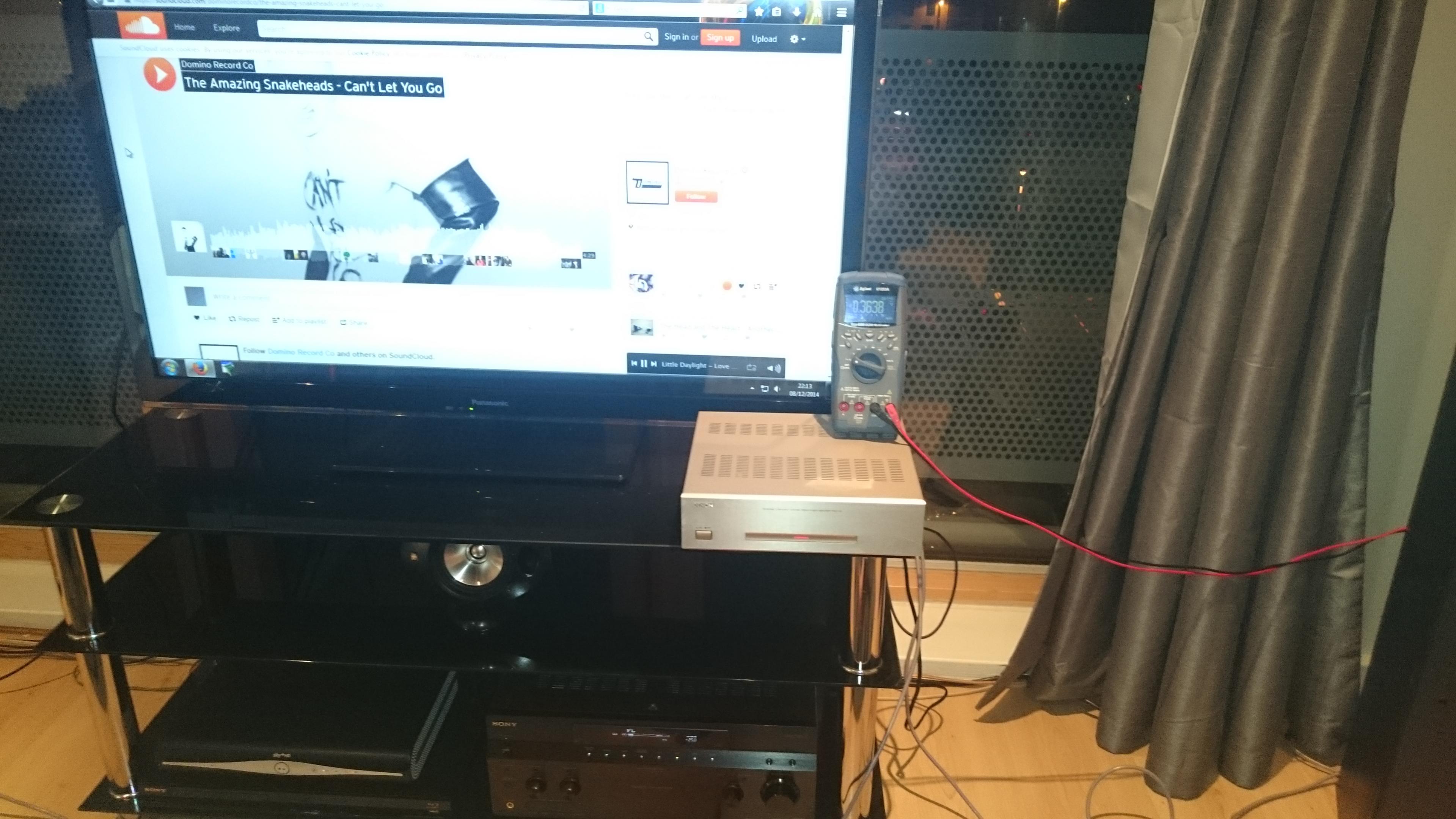

Off subject, but having just hooked up a small denon poweramp I have been reminded that I have been missing out.
Having used my AV receiver Sony as pictured for years, i think I have become used to ESR drift. If this little Denon amp is similar to what I am expecting from a gainclone then I am excited

If you aready have a nice little amplifier, no point building one.
Something more exotic ?
