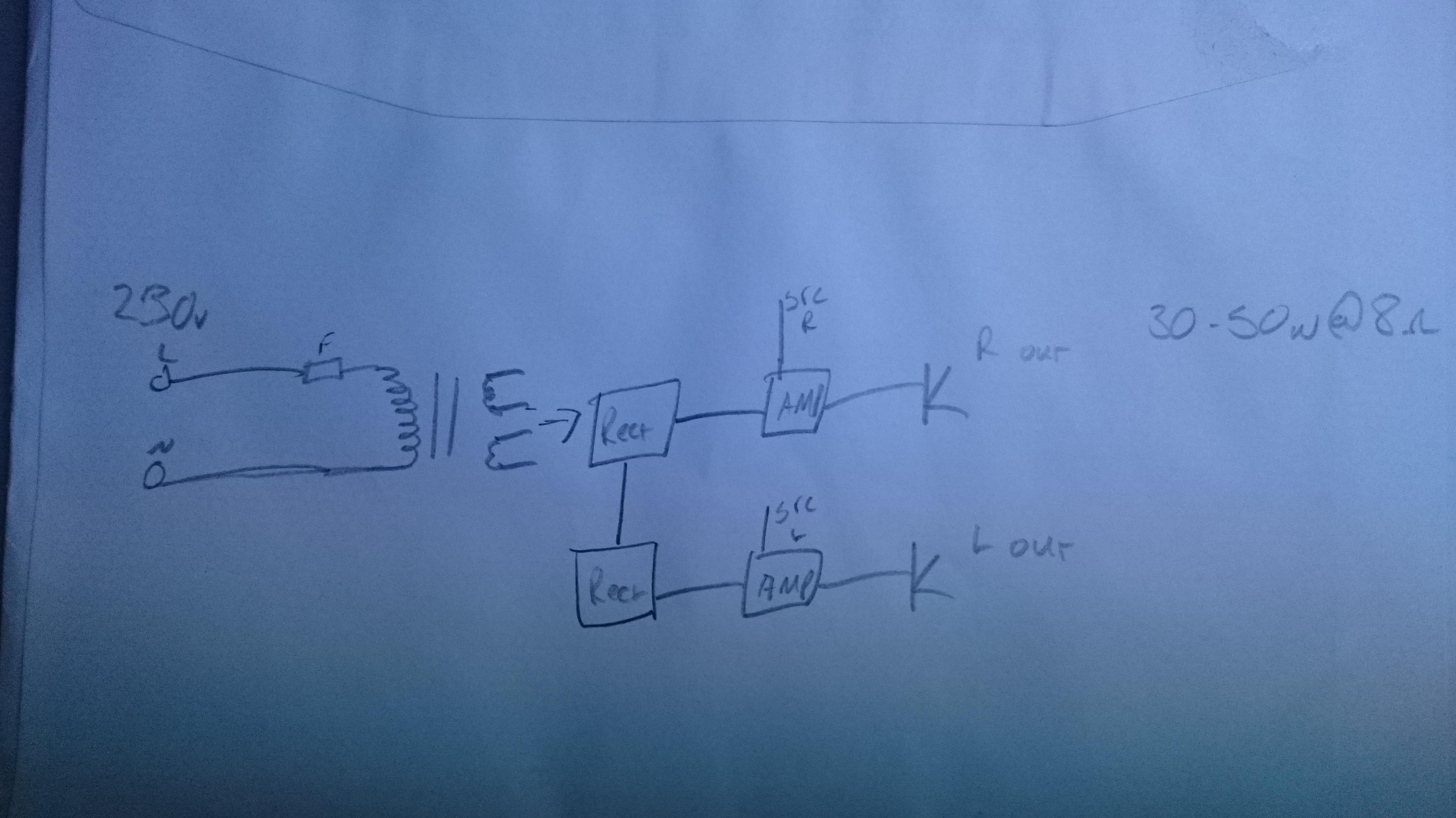

Hi thanks for the reply,
I was reading this thread http://www.diyaudio.com/forums/audi...al-gainclone-kit-building-instructions-2.html and it mentions 22+22 300va winding.
The amp will always be driving 8R speakers. Power wise 40w is ample, I won't be running it close to the edge all the time. At the moment with my speakers and AV receiver I only really use around 10w.
So would the basic amp kit and a single 120VA 22Vx2 winding be enough? I know these sound like basic questions, but once I know the basics I can figure the rest out.
I think you might be right about the dual stereo.
My idea is;
1xWinding fed into 2xrectifier boards that then supply 2xamp boards, does this sound correct?
Thanks Mark
Ok, this may be a crude image that I just quickly done, but I hope it helps explain 🙂
Basically 1 winding to drive 2xrectifiers that then feed 2amps and I believe this would be a mono amplifier?
Hope the quick drawing makes sense
Mark
Also note in a stereo amplifier case, you can have one transformer with one
PS board for both channels, or dual PS boards for each channel, the latter
is more akin to monoblocks. Twin transformers is pointless in one case.
This is what I am after, one transformer to dual PS to each channel
Your wording makes mine sound like I am speaking a different language 🙄
But this is basically what I am after, so I would need 1xsuitable winding and 1xbasic amp kit (consists of 2xPS PCBs and 2xAMP PCBs)?
The best pot is dual linear with an added law faking resistors (google),
(It has much better channel matching than any audio taper pot.)
The "best" transformer is a big deal in production runs, but
in DIY it is really about price breaks, e.g. 150VA may cost
barely more than 120VA, 100VA could be much cheaper.
Chip amps (like op-amps) are not designed to need separate
PS boards, (just local decoupling), often in AV you'll find
lots of them all driven by one transformer and PS board.
There is no need to use two PS boards, and IMO the
Audio Sector approach sucks, as each board is dual,
so you only use both with two transformers, i.e. full
monoblocks, and monoblocks don't need dual boards.
YMMV but you don't need boards at all to build gainclones.
AudioSector are unduly complicating something simple.
rgds, sreten.

Clueless overkill is stil clueless overkill, DIY it does no harm.
One AS PS board is a dual rectifier board for two amplifiers.
Its very OTT for a 40W per channel amplifier, and IMO
not that particularly well designed either.**
If you go full mono block (two cases) you can half populate
the two boards or buy the pretty pointless extra diodes
and caps kit so your running two already totally over
the top rectifier circuits in parallel for each channel.
In principle, not handwaving, (I'm not going to justify
the complicated issues*), you will be fine with a 100VA
transformer and wasting your time going over 150VA.
rgds, sreten.
* Matching a transformer to use for music is not simple.
Any pretence it is, is simply oversimplistically wrong.
** The board is totally unnecessary for a bridge rectifier
on its back clamped to the case, and connected to the
transformer, with 10uF wired across the output.

Be careful with your voltages.
A 230:22+22Vac transformer running on the UK's nominal 240Vac will give a higher voltage.
The transformer regulation also gives an higher voltage than the "fully loaded" specification.
Your no load output voltage is:
Vout = Vmains / Vpri * Vsec * {1+regulation}
The maximum output voltage of a 6% regulation 230:22+2Vac transformer on the maximum UK voltage of 253Vac will be 252/230*22*1.06 = 25.65Vac
The peak voltage will be 36.28Vpk
Subtract a bit for a no load diode drop and you have a potential for ~35.8Vdc across your smoothing capacitor.
DO NOT use 35V caps. Use either 40V or 50V capacitors.
Hi Andrew thanks,
Really didn't think about off load voltage and the output voltage rising at all, told you I am a novice.
Since this is my first amp, I'd like to start by not having to change component values yet and learn by using with what comes in the kit.
Ok so if I have done my sums right, I am wondering if a 230:18+18Vac (160Va 10%reg) would be ok?
252/230*18*1.10=21.69Vac, and I have worked the peak to be 32.54Vpk.
Would this be suitable for 35V caps or am I close to the limit still?
Mark
