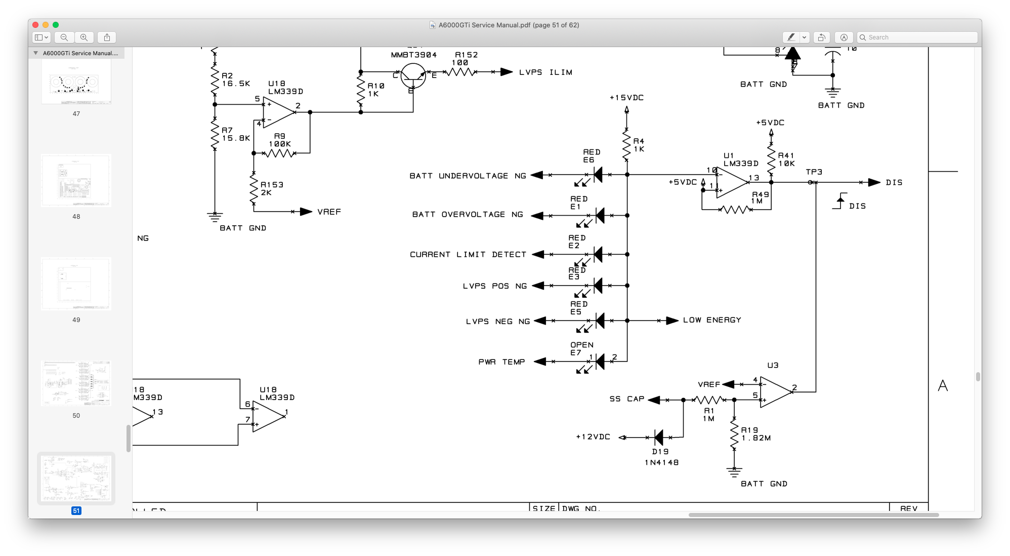

Page #28 of the SM
LVPS NEG(E5) Low voltage power supply negative no good
ILIM (E2) Power supply over current or audio section fault
Sometimes when it does power up, the Battery OV light shows very dimly, but the OV/UV thats over/under voltage circuit works when I change my external PS to 16v or 10v.
Battery OV (E1) Voltage greater then 16V
Battery UV (E6) Voltage less then 10V

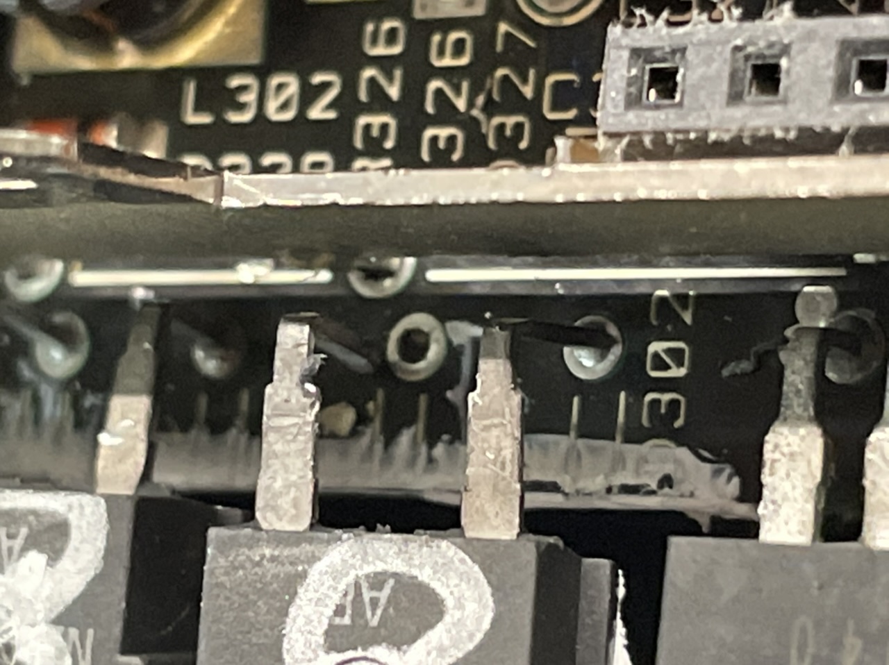

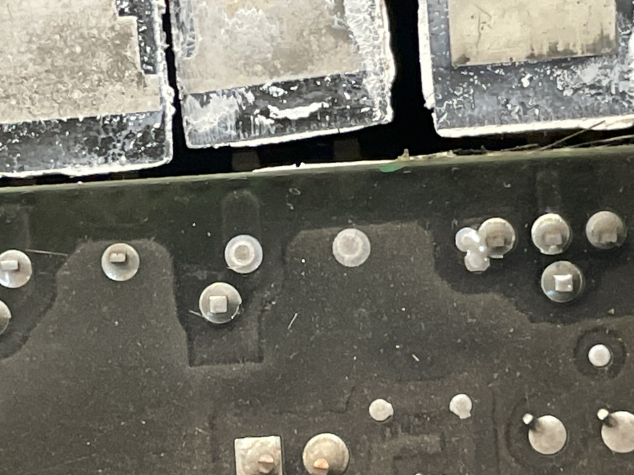

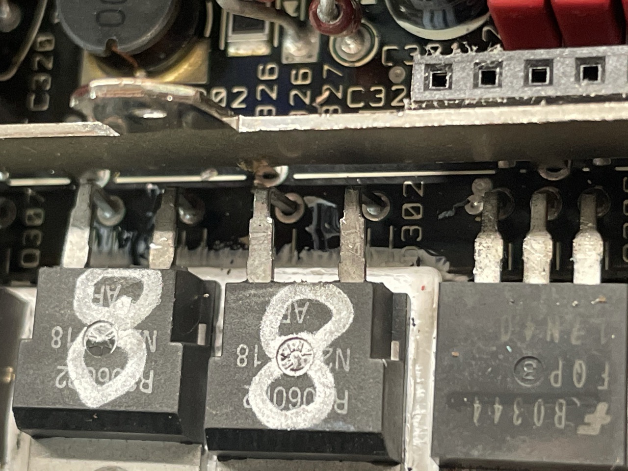

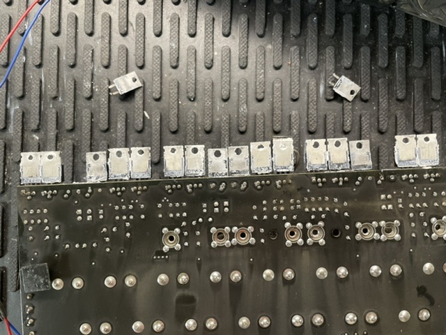

On the Audio board, I actually did find a manufacturing fault. All 8x rectifiers (R3060P2 devices) were poorly soldered, and 2 of them only had 1 leg soldered each. (Photos)
These rects being poorly soldered are likely to have caused this amp to crowbar and then mess things up on the PS side of things.

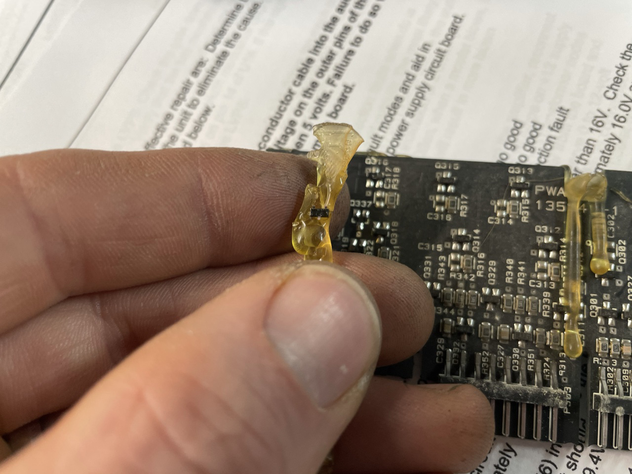

Also the glue is a royal working on this amp. Pulled off an smd transistor on disassembly on accident.

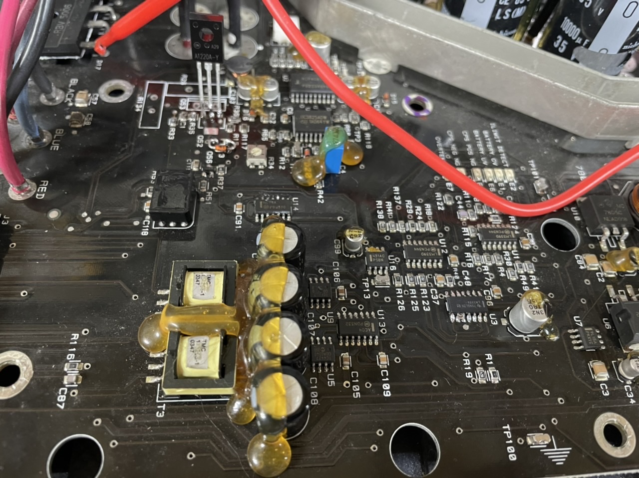

Back on this amp. Before getting the FULL SM, I decided it would probably be best to replaced ALL Uxx ICs in the PS since many of them had failed and I was circling round and round.
Long and short of it, I replaced everything EXCEPT the U2 HIP4081AIB. Probably a mistake to skip this one, but its a bit harder to find and costs a bit more.
The amp no longer has any status problem/LEDs, BUT it also will not power up correctly fully
The "Pre" power supply is working. I'm getting +-24v out of the Pre-PS, +-15v, and +5v out of the other regulation components as well.
The amp is drawing 2A from the bench, and everything seems 'normal' as-in ready to 'go', but the main power supply is not booting up.
Main PS is driven by the U2; HIP4081.

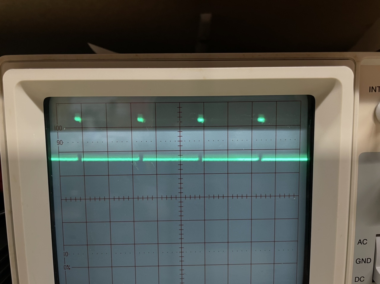

Pin 3 has a square wave that rests at 2v, and a low duty cycle up to 4v. Looks clean
Pin 5 & 6 have a nice, clean; 0-5v square wave
Pin 8 & 9 are at 5v, with 'noise'. Makes a rather thick line on the scope. This seems irregular.

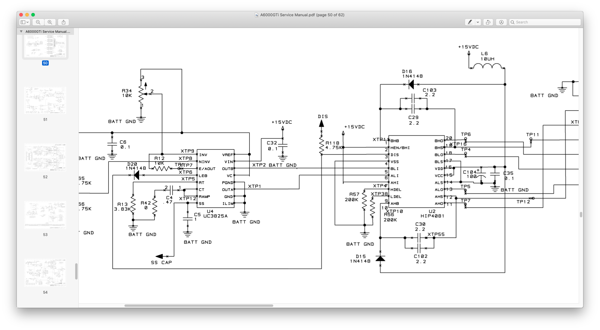

I removed D20 as I was going to test the output of U4 ping 4 and to my surprise the amp TRIED to power up. It was VERY BRIEFLY trying to draw about 15A and so I pulled the power super quick. I do not know if it would have FULLY powered up. I then replaced D20 with a new 1N4148, and amp is back to not powering up as it was in post #27.
Hmmm...
Heres the schematic I'm looking at.
Hmmm...
I wouldn’t say driven, more like steered. That IC drives all the the PS FET gates, but it gets its marching orders from the UC3825. Are you getting drive waves out of the 3825?
Yes, HIP4081 pins 5 & 6 are being driven by pins 11 and 14 of the UC3825A. Clean square wave as mentioned.
U4 - UC3825

U4 pin 4 and U2 pin 3 connect back to what's labeled as DIS after a 4.7k on the above schematic. Board trace shows this connecting through multiple components, including U1 and U3, both LM339.
U3 pin 5 is also connected to SS CAP on U4 (UC3825A)
Schematic:
Schematic:

HIP4081 pin3 (DIS) from what I understand shuts the chip down when DIS is over 1.7v threshold. I'm getting 2.123v on it.
Could my new SG3825A be floating too high? As mentioned, scope is showing a square wave with a floor voltage of 2v, and a low duty cycle square wave up to 4v on pin 4 (LEB) hence 2.123v on the dvm.
If I put a second 1n4148 in series with D20, possible get the voltage dropped enough for the amp to boot. Thoughts?

The waveform is exactly the same with two 1n4148s at D20 tied serially. The second 4148 essentially just lowered the over-all voltage by about 0.4v, which as I understand is a go/no-go voltage for the HIP4081 at 1.7v. So, essentially the second diode tricked the PS into booting up. It is extremely close and seems like it might want to shut down still; I feel a 3rd diode would improve it further.
1v/Div @ 0.2ms
1v/Div @ 0.2ms
