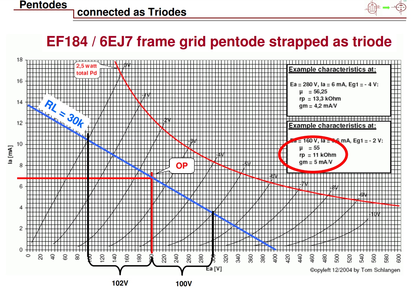

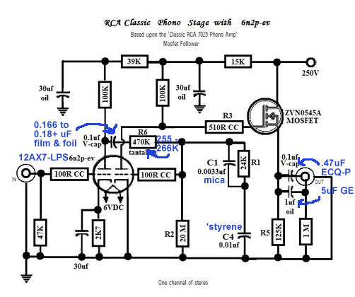

The PCF802 is interesting. Its triode exhibits the same μ (amplification factor) as the 6SL7, while having lower plate resistance and higher transconductance (gm). A RCA style phono preamp is possible, using the PCF802 triode as the 1st gain block and the pentode as the 2nd gain block.
Build a current regulated 300 mA. DC supply for the series wired heaters. As pentode O/P impedance is high, buffering it is (IMO) essential. The DC coupled ZVN0545A source follower shown in the tweaked version of the 12AX7 RCA setup would be fine here too. RIAA EQ network parts values need to be recalculated and I suck at getting that right.
I am also looking for a good EF184 preamp schematic. Triode curves are promising. The ECH84 triode should be usable as audio amplifier, but the PCF802 is a challenge because on most audio applications it would be required to pair it with another tube with 300mA heaters, and the resulting heater string voltage would probably be non standard.

Freedom from all sorts of heater issues is why I favor DC coupled MOSFET source followers.
If 100% tubes in the signal path is desired, a 12AU7/ECC82 (for cathode followers) shared between the 2 channels would work in a PCF802 based phono preamp, that employs a 300 mA. series heater string. A LM350 adjustable regulator IC is surely stout enough for the task.
