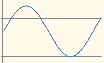

Hello Nazar_lv
It's not a good point of view to think that upsampled data are outside the audio band.
Look at the joined diagram:
- dot in ... color are real samples recorded on CD,
- dot in ... color are 2x ovsl sample
Can you say me where are the samples recorded on CD. 🙄
OS is much jitter sensitive because each output sample contain same 'amount of jitter'. By increasing output sample you increase total amount of jitter. It's the problem number one in one-bit DAC where oversampling can reach 256x....OS has almost the same sensitive to jitter as NOS, for "white" jitter OS is less sensitive if DF has good stopband attenuation -100db or more...

no, it is simple audiophile idiotism🙂OS is much jitter sensitive because each output sample contain same 'amount of jitter'. By increasing output sample you increase total amount of jitter.It's the problem number one in one-bit DAC where oversampling can reach 256x.
When we increase sapling rate this will reduce the sample to sample amplitude difference and random jitter induced distortion will be less by oversampling factor, for sinosuidal jitter within baseband will be not rejected and will be the same as in NOS.
A 1bit DS modulator has a step size that is fullscale(0-5v PWM) thats why this DACs is very sensitive to jitter, if we use more output levels("multibit" or "multilevel" DS) and use discrete time filtering (SC filters or DCT (Direct Charge transfer) DAC) then jitter sensitivity will be less.
it is very simple explain becouse my english is not very good.
I dont understand you questionLook at the joined diagram:
moving average filter is interesting only for 192khz sampling rate, for 44,1 he only do HF rollof, many DACs and logics introduce much more EMI and PCB design will be much harder and less optimalWhich new problems the shift-registers dac does introduce ?
