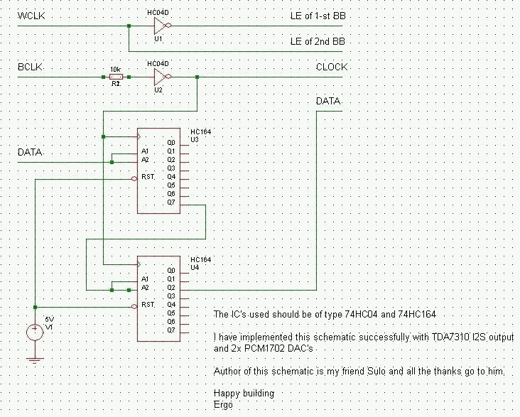

I want to mod my Linn numerik:
- It has SAA7274P digital receiver(And 2 crystal to sync with Karik). AND DO NOT have DF1700.
- DAC is PCM 1702.
- Opamp is AD846N
- Is it already in nos mode?
- And upgrade opamp bring it to next level.
Please help me on this project.
If needed i will take pictures.😀
Many thanks.
