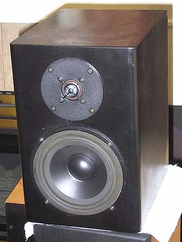

Re: Duane's 2-ways
I think Duane's speakers just got named ... can someone tell him?
(and i did take notes: VIFA + VIFA) I betcha Andy G could tell us exactly what they are.
One of the better sounding speakers in room 1.
When 1st heard in room 1, Duane himself was quite mystified at the hardness of the top end ... after everyone left for other rooms he had them back up on the stands and was listening to one cut after the other, trying to get a handle on them.
Then we hauled them into room 3, where they sounded quite excellent... still a few minor problem areas. I suspect a little duct-seal wouldn't hurt -- not many seemed to know about this "majik" compound.
And here are the black beauties.

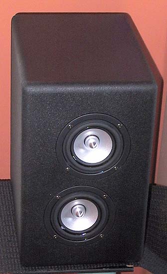

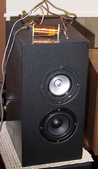

The Elf (and his cousin the Ant)
Not the best sounding ... not the cheapest, or the most expensive, but i figure the standout of the show.
These little babies, show the potential of the really small full-range (probably better described as an extended range mid-tweeter) with augmented bass. They struggle to hit 100 Hz, and can't do that with authority, but do a credible job from an octave above that, up, up, up... In the HT with the sub they were quite good.
Implementation here is a ported 1.5 way. (the Ant replaces the 2nd W3-871 with a different 3, choosen, i expect, in an attempt to get just a wee bit more on the bottom. RAW?). Each of these drivers is $12. That's 4 for $50.
Now, the 1st thing i thot when seeing them is 2 way with an active side-mounted 8" (or pair of 6.5"). If the woofers were low enuff sensitivity, you could even go passive (the one downside -- these things aren't real sensitive)
What is important about these thou is the alternate approach it engenders. Instead of a midbass & a tweeter, we have a woofer & a mid-tweeter. A whole new world opens up. And with active subs becoming so very common place ...
These little TagBands aren't the 1st to come along that would encorage this approach (usually either under represented like the Jordan JX53, or scary expensive like the Raven R3), but could well be the one with the right combination of sound quality, low price, and you have to admit, seductive good looks, to get people to experiment with and popularize this approach (which if anyone has been paying attention is pretty much what i've been doing with my FE103As and RS 40-1197s -- neither of which is readily available -- well you can buy the RS in Canada but how sexy is any RS speaker gonna be?)
And you could start a system with a pr... add a 2nd one ... then a woofer, and maybe a super tweeter (all these new exotic superTs, how long before 40 kHz is considered a given for a proper full-range system?
I'd love to get my hands on a set of 4 of these, and see how much more can be squeezed out of the configuration... i can already see a number of places where implementation tricks could make a better speaker. In the meantime, i have 2 pr of similar 3" (the exotic beauties and a set of W3-879S) to play with (and 4 Adire AV-3s).

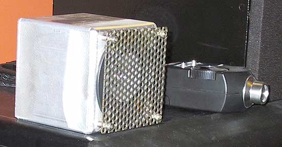

The Cubes
And an example of how small an enclosure you can get away with...
More pictures at the RAW site. (a tip Al -- lose the frames)
These aluminum beauties were made by Dean, who seems to be a hidden talent at RAW and i am sure will keep encouraging them to think different.

Dean my cube builder.
Well a old Nuera customer who makes Aluminum furiture in Vancouver.And the cubes came out of it.
AS I showed the grills make look to industrial but I am going to have measurments loaded on my site for those who want to see the grills effects on the output of the cubes.
Did you guess.
Flattens out the range believe it or not.
And to put into production a speaker that is beyond Galo for 1/16 the money.Was a challenge.But it is done.
And the cubes are in stock and I can make them in 100-500 runs at a time.

On the ANTs, yes getting close.Have to un wind each inductor to get 100% of what I want.
And the lower driver cahnge.
To just smooth out the bottom end of the 1.5.
Much flatter using these ofhter drivers in the lower end.
And I have the ANT coming in a twin black paper driver.
more on that later.

Re: Re: Duane's 2-ways
I agree with aaroncgi, I've got WAY too many passwords now. I think I'll just put a folder on my desktop called 'Passwords - Keep Out' and put them all there so I don't forget. On second thought that may not be such a great idea. I may have to resort to writing something down on paper.
Thanks, but as all I did was alter the cabinet dimension/volume/tuning, I think they should still be called Emblas. Designed by Seas (or by someone that Seas paid to design it, one of the two).
The drivers are both Seas: 25TAFC/D tweeter and P17REX woofer. Crossover is 2nd order at 3k.
I did some more listening when I got them home and I can tell you that as far as the 'SS Rulz/Yay, Tubes' debate goes, the difference between the 2 was not as significant as putting them back in a room that they liked. It's about 15x15 with 8 foot ceilings. It gives enough room gain below 70Hz that I can pull them out into the room to provide proper imaging without losing the low end. With the bottom end filled in, the overall volume could stay lower and the harshness in the tweet almost went away. It also helped to not have them toed-in.
My opinion on the harsh sound of the speakers in the first room would put most of the blame on the ~30 ft. long room. That, coupled with small speakers with small woofers that were too far from the back wall and sitting to high off the floor and you are bound to have problems.
Overall, a very enjoyable day. I was glad to meet all of you and expect to see more projects out when we do it again next year.
Back to work now,
duane
By the way, I think the winner was the ELFs. The sounded great and even with the necessity of a sub, this would make a very inexpensive HT.
