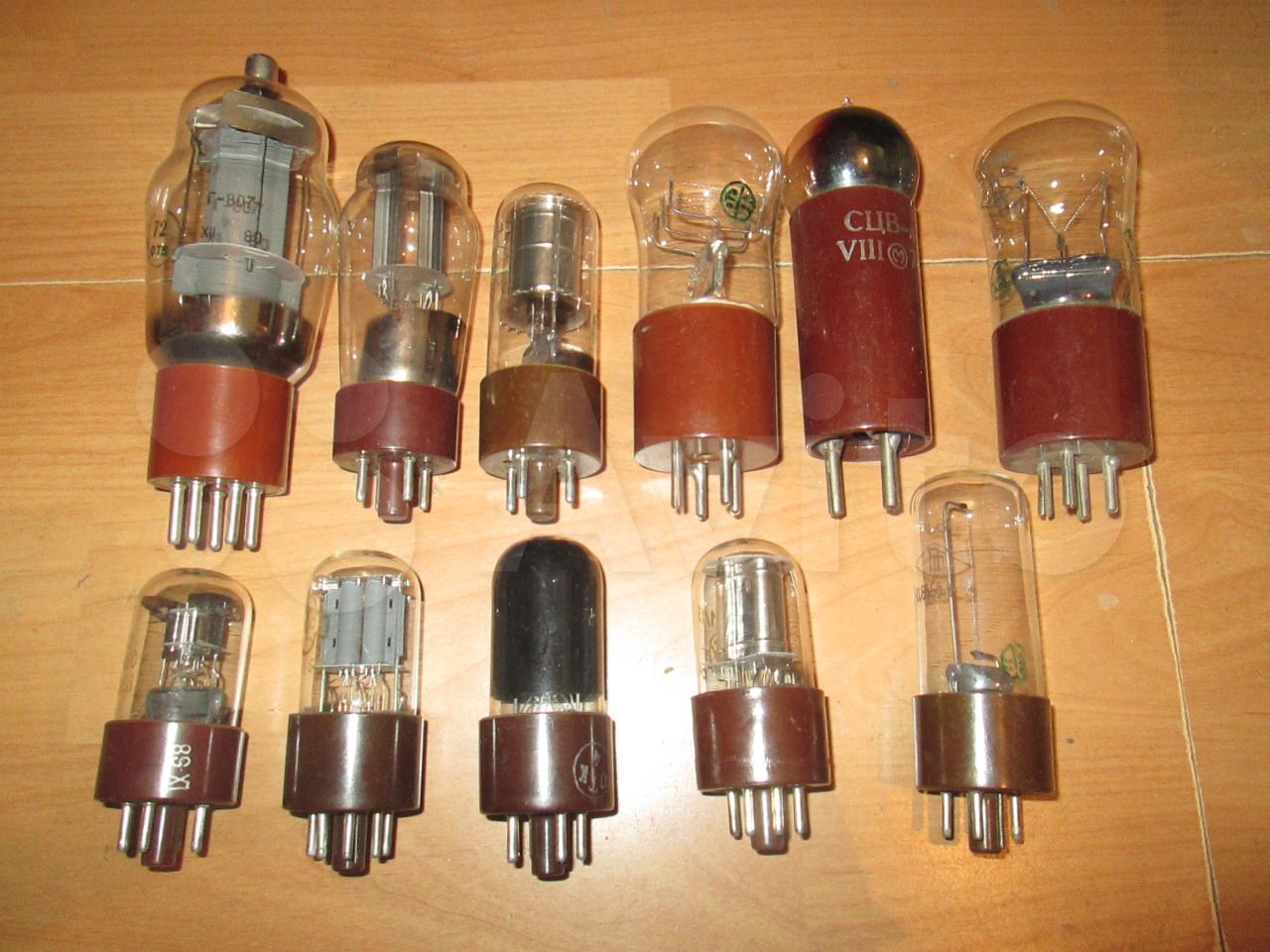

Did anyone get the spec on the Octal tubes that appear to have been made in the 40s or 50s? Would be amusing if they were as good as the best NOS 6SN7 or 6V6s out there.

The first one is most likely the equivalent of 6P6S (6V6), not 6SN7. It has characteristic screen cooler flag. The second is one of the military UHF pentodes used in portable transmitters.
The data sheet is in Russian, but tube name is FUBARed.
The 6V6 is likely Korean-made, I haven't seen any Russian-made 6P6S with brown micanol base.

The tube name is just Korean transliterated to Russian - it'll be 4jŭng5jib by modern Romanization.The data sheet is in Russian, but tube name is FUBARed.
There is quite rare early 50s Svetlana 6P6S with the brown base, but the base itself is made much nicer (bottom row, middle).The 6V6 is likely Korean-made, I haven't seen any Russian-made 6P6S with brown micanol base.
The thing is I've never seen 6P6S with rectangular(ish) top mica spacer - unlike the many 6V6, it's always almost round. So I'd second the "Korean-made" opinion.
