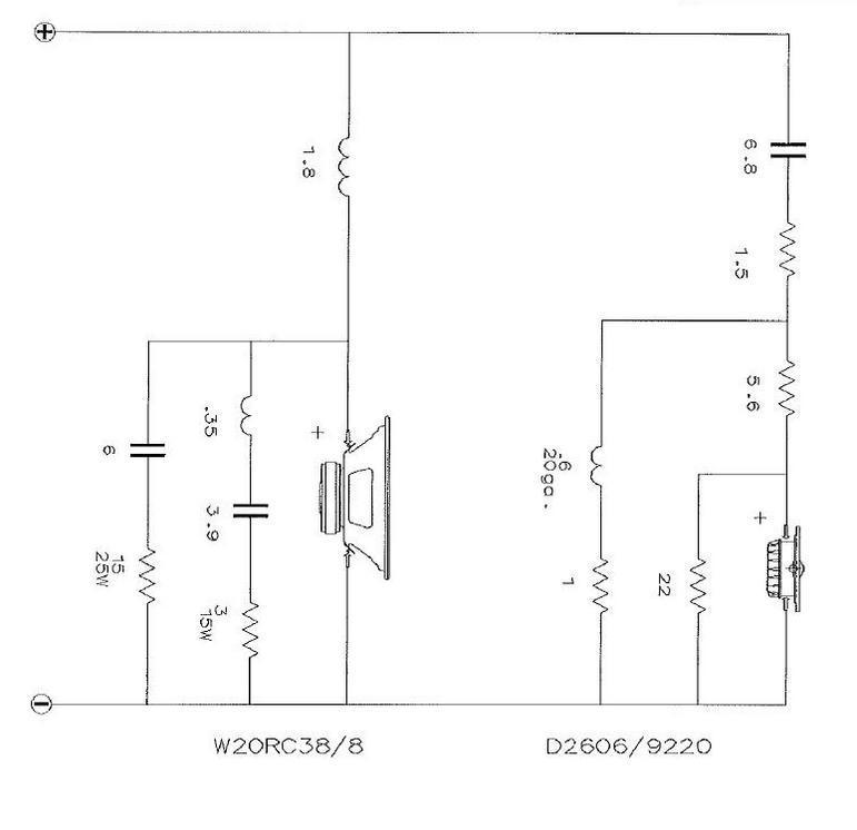

However, I see you have an interest in a 8" silver flute, here's a xo for the 8ohm model.

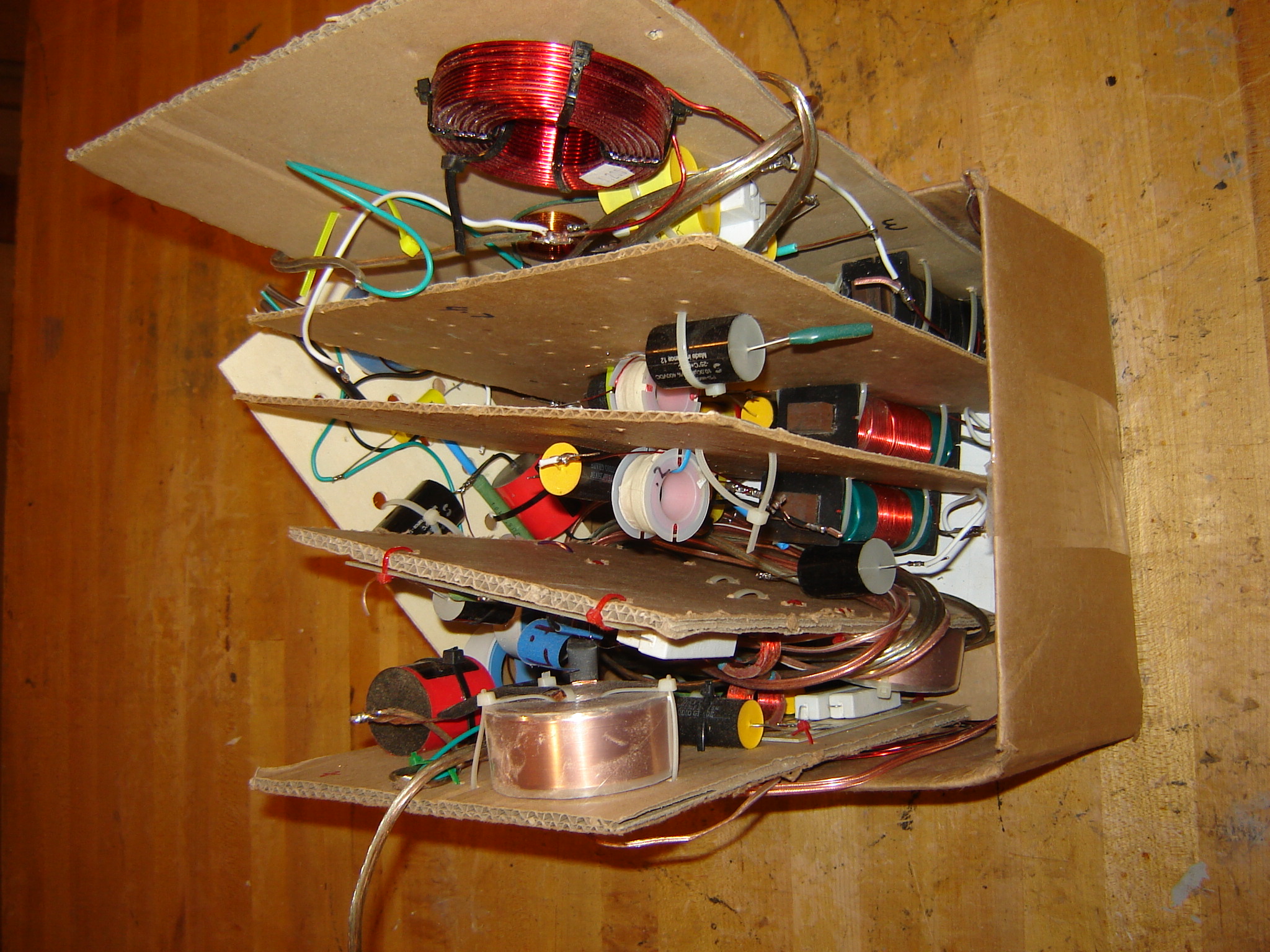

When good desings go bad
Us diy-ers need to stick together; here's a box full of xo boards that sounded good for a while then simply gave me a headache after about 2 weeks.
I think there was about 30 xo/designs/boxes in a couple of years, only two designs remain and really enjoying them.
Point being, it is tricky, mostly engineering, some black magic and finding speakers that work nicely together.

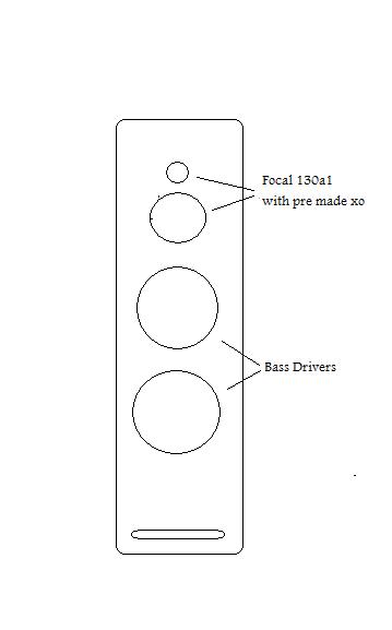

the initial thought was add some 8in woofers build a simple 2way crossover around 1khz put them in a box call it a day, well a little more in depth then that but that was the jist of it. then it got complicated when I wanted to do dual 8s up front and singles in the back then I started to realize the myriad of problems. you guys have pointed me in some good directions. unfortunately when I look at impedance gaffs my eyes glass over and I get the deer in the headlights look. however I'm nowhere near close to giving up I dont have any test equipment which makes it harder, and i want to double duty the fronts for music so the need for a larger driver is there and I like the look of towers (so does the wife and she likes music as loud or louder than me) (shes a keeper)
ok I"m going to try one problem at a time, or one aspect at a time. using 2 woofers doubles or halfs your impedance, (I understand nominal impedance and wiring) doubles box volume, and adds 3db. does it affect anything else? crossover frequencies etc? I used to be into car audio back in the day that may be hurting me now
That's right. Thinking there is some question what you want to do.
Is this it? [sketch]
There has been success with 2 - 8" SF's in a 3ft3 box, but I didn't like that the SF's 8'' cone is very, very thin.
As mentioned, best to whip up some test boxes to see if the Focal's have potential indoors. Do you have parameters on the 5.25 woofer?

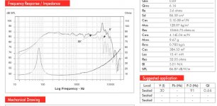

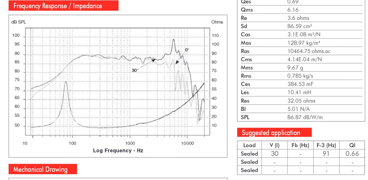

spec sheet on focals
http://www.focal-america.com/wp-content/uploads/2010/09/130A1.pdf

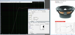

Well its wip-y but doable I guess. WinISD defaulted to a 16.5l box with a small port.
[most small drivers model nicely; smooth, straight line, with gradual roll]

I had debated on a sub bottom, but wanting a matching center speaker took that option out. a .58cf ported box is easily doable for a cabinet in a cabinet.
pardon my ignorance but graphs are a language I have not grasped yet so I'm not sure if that is good or bad

Not much to it, its simple enough, the good new is the speaker will go down to 50hz in a smallish box - I'd be running to the bank with that one.
