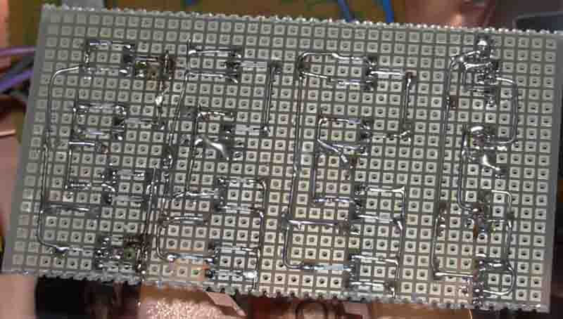

Thanks. I realised that the other day, so I ordered 25 MBR20200 Schottky as samples for only $15 postage 😉
Regards, Lee.
Holly Cow, Thomo ... the MBR20200 are max. rated 20 amps / 200 volts !!. These will make perfect, very fast, very clean, full wave bridge rectifiers ... for pre-amp, or even mid power amps!! I would "derate" them to ~ about 1/3 power, and still use healthy heat sinks if power requirements exceed ~about 500 watts (=~7 amps @ 70 volts AC into the bridge). For US$25 bucks, a steal!! (Got a source for the rest of us?) 😉
