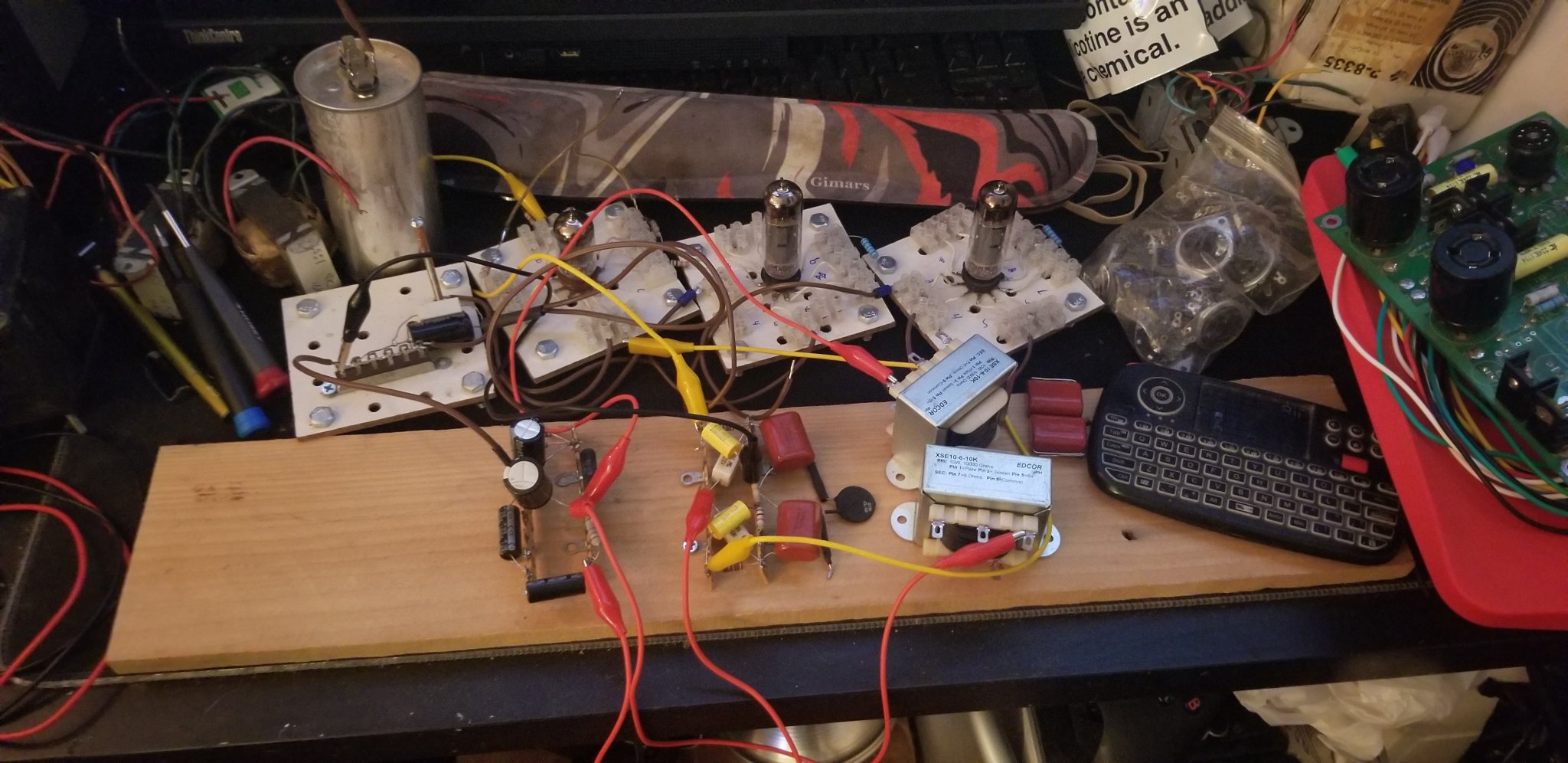

Not really a waste as I just wanted to make sure it wouldn't blow up the amp from overpower. I am just breadboarding the amp to see if i like the sound. I may breadboard a number of amps before building one for keeps. I'm really good at putting things together from a schematic or plan but a electronics engineer I am not. I am not comfortable with the math, actually i do not even know when to use a particular formula for a specific task. Still working my way through that. Im a hands on learner and have no one close by to help me learn the way i learn best, so I'm doing the best i can with what i have, ME!! LolThe OP was going to use a power transformer suitable for 60 plus watts for a 2 watt amp. Nothing wrong just a waste of a nicer future project transformer.

Not a pet name at all. It has been discussed on many forums, google Darling amplifier and youll get at least a half dozen schematics.
Besides which my question was somewhat generic. "Schematic calls for 300-0-300 200ma period. Will a 300-0-300 330ma be an issue." Pretty straight forword question.
Unfortunately it got a bunch of different answers. Also i stated im a noob so some leeway should be expected as i may not even know the proper way to ask a pertinent question. I certainly wouldn't lambast someone for asking a question not up to my standards, just because i want to be big man on the forum.

I honestly don't know if they line up to build it, but reviews were that it's a sweet sounding amp and i just happened to buy a box of tubes that included a dozen 1626 nos tubes. But its not the only amp i was looking at, and a number of them use 300-0-300 150-200ma power transformers, so i have the Stancor beast in my junk box and wondered if i could safely use it. Thats all, i didnt have a single amp that i wanted to build yet, i want to breadboard a couple of designs to see which one sounds good to me then build that one.And people line up to build this?
A well respected darling amp http://www.diytube.com/clementine/clementinemanual.pdf
Also convertible to 6l6's
You've got a dozen of them then make a push pull parallel power amp and get 50-75 watts of power per channel not .75...
Wrt breadboarding it seems like a good idea.
They are but I can't take credit for them. George from Tubelabs created them I just copied his design.Those square white boards look to be easy to work with, especially for breadboarding
Been trying to find a schematic to do just that. Couple years ago i found a six tube variant pp but I can no longer find it. And I'm a noob, I'm afraid designing my own version is still beyond my abilities. Sad..You've got a dozen of them then make a push pull parallel power amp and get 50-75 watts of power per channel not .75...
