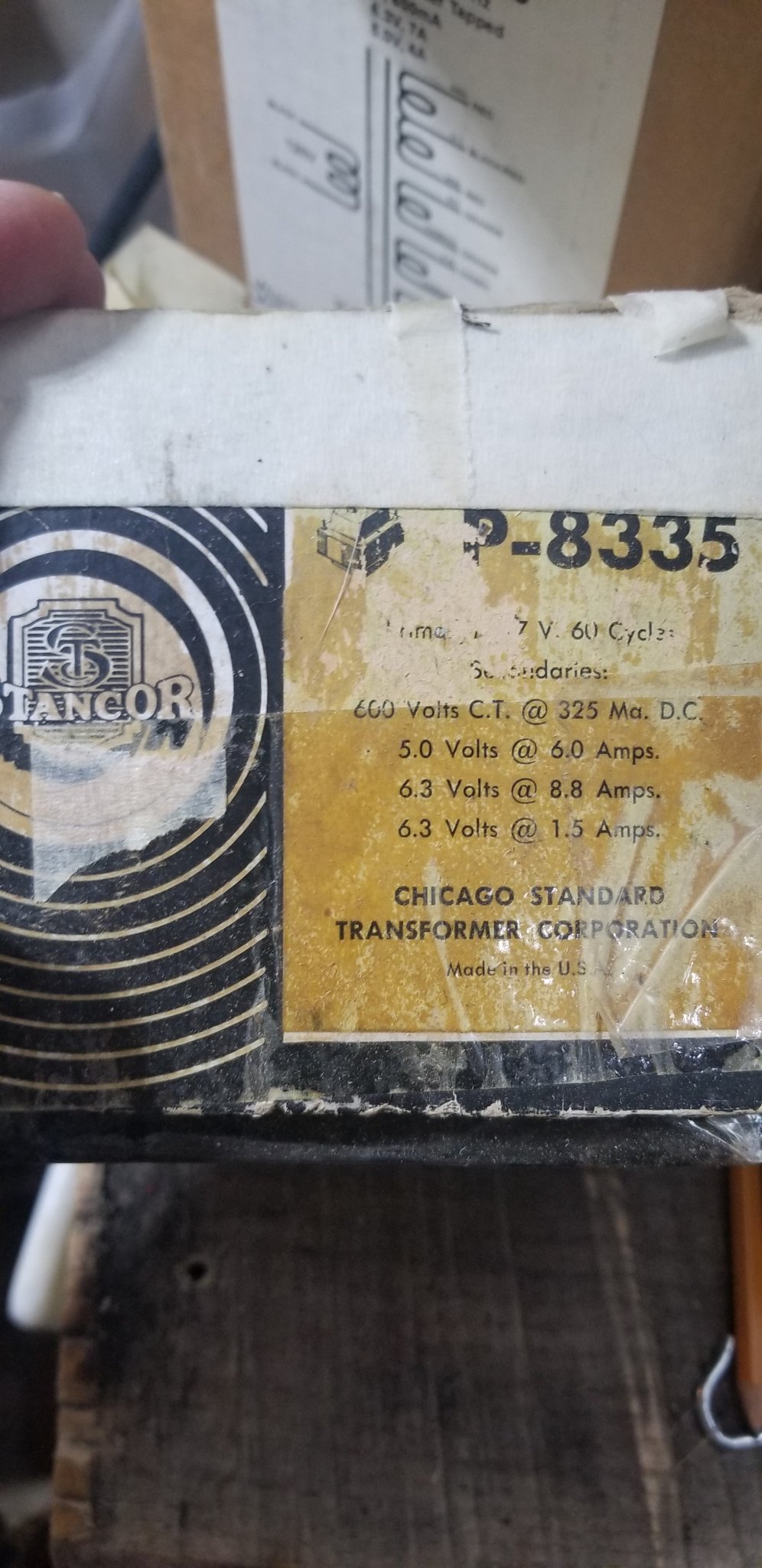

It it a Stancor transformer , I will post the specs on the box when i get home. I was looking at a number of schematics for darling amps as i have a number of 1626 tubes. As well as possibly building a point to point version of a zenkit 1 as i breadboarded this amp like 2 years ago and have most of the parts for it. I think i used an underpowered 540v ct edcor at the time. Anyway I'll post better info when i get home.
So here are the specs, Stancor P-8335
300-0-300 325ma, 5v 6.0A, 6.3v 8.8A, 6.3v 1.25A.
The amps I was looking at were just for a fun project and to learn. I was looking at 1626 Darling amps because i happen to have nearly a dozen nos tubes. There is a parallel tubed version that uses 300vct 150ma transformer that is why i originally asked. This transformer is more than twice the current.
So what kind of amp would you build with this transformer?
Oh and i believe the primary is 117v its not totally Visible on the box but it looks like a 7 on the end.
