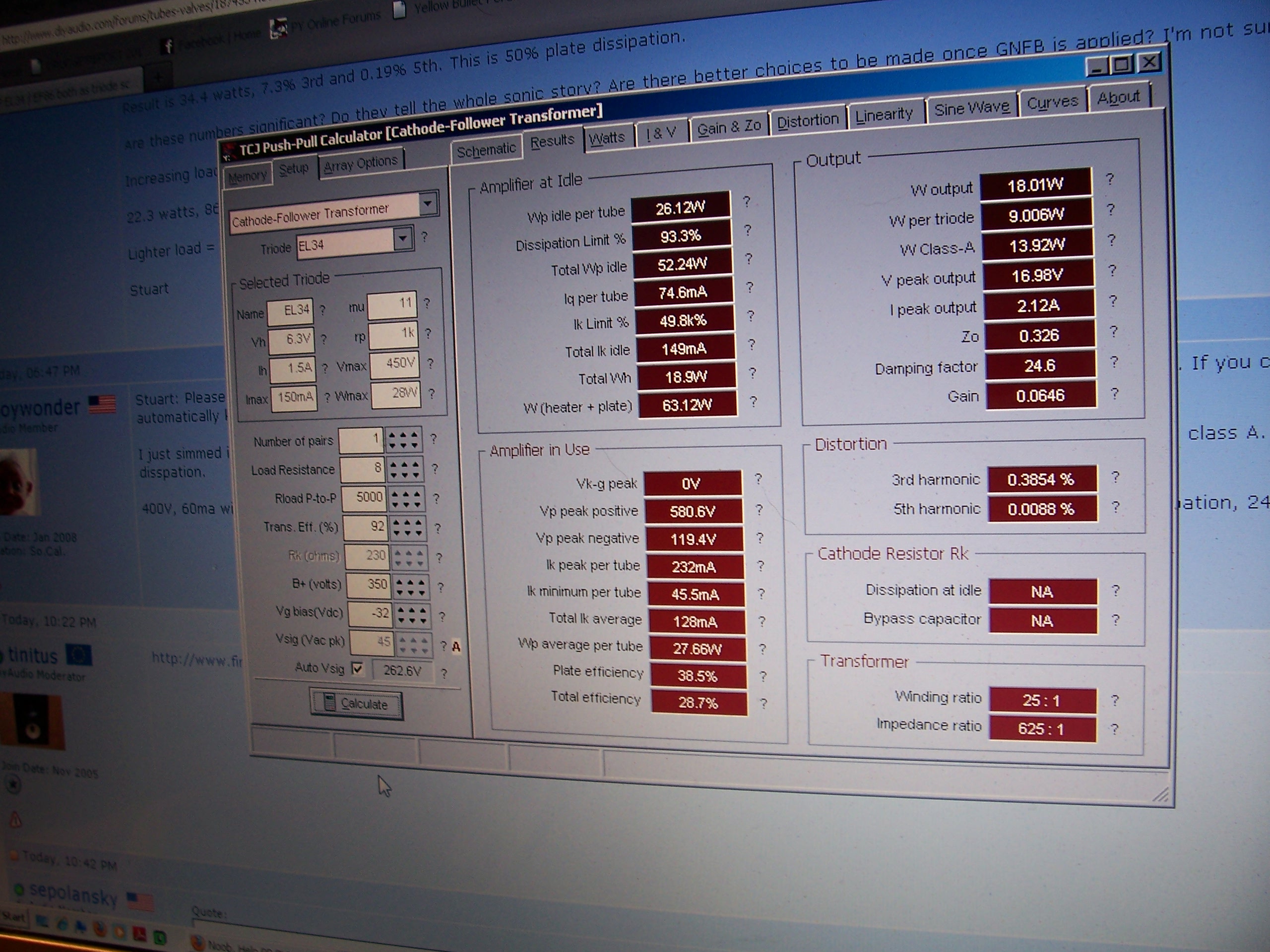

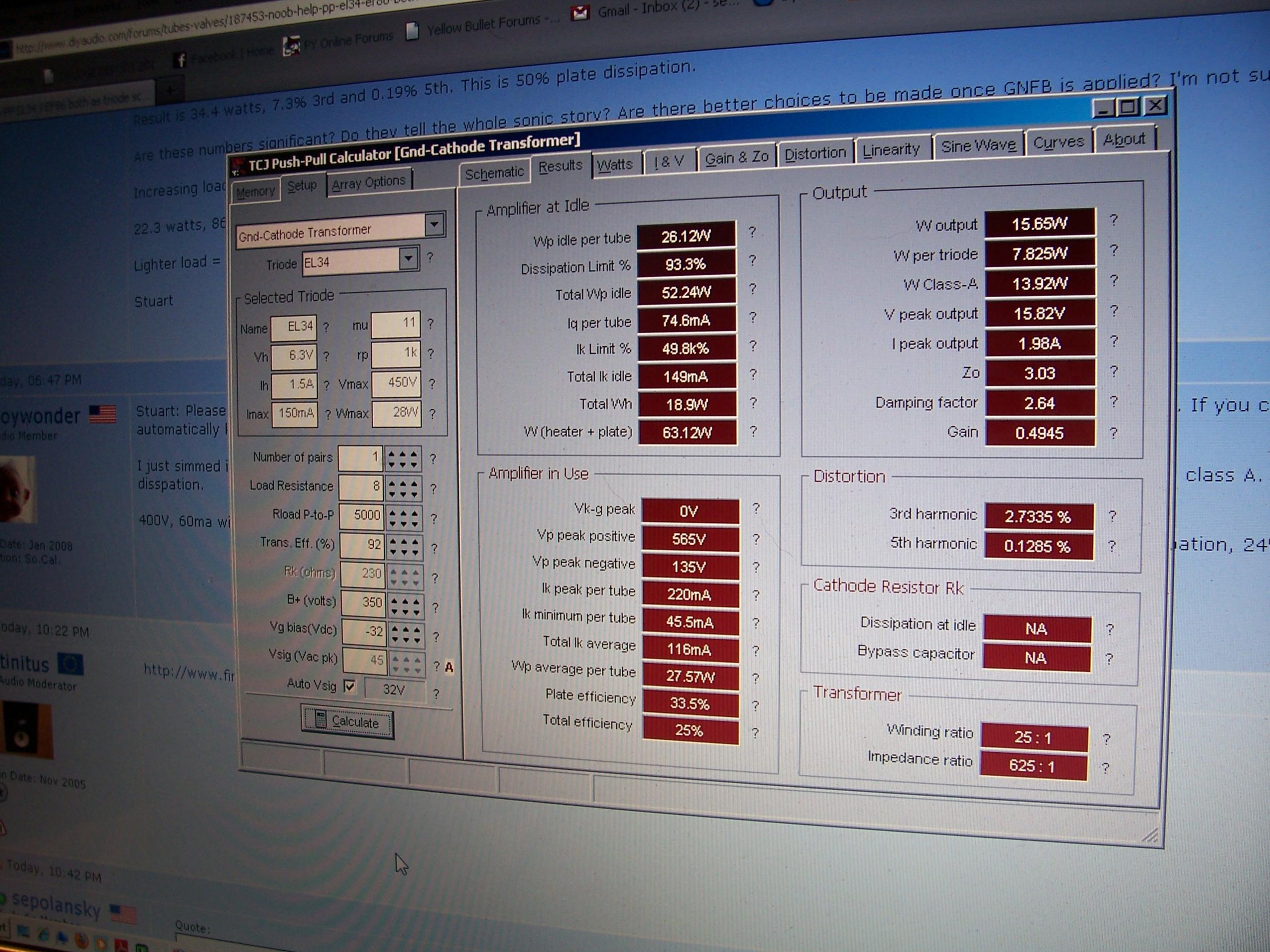

Buy a copy of John Broskie's (Tube Cad) Push Pull Calculator. It will allow you to experiment (simulate) with various B+ voltages, transformer loading, bias points, etc. to fine tune power & distortion. It's cheap ($29!) and insightful.

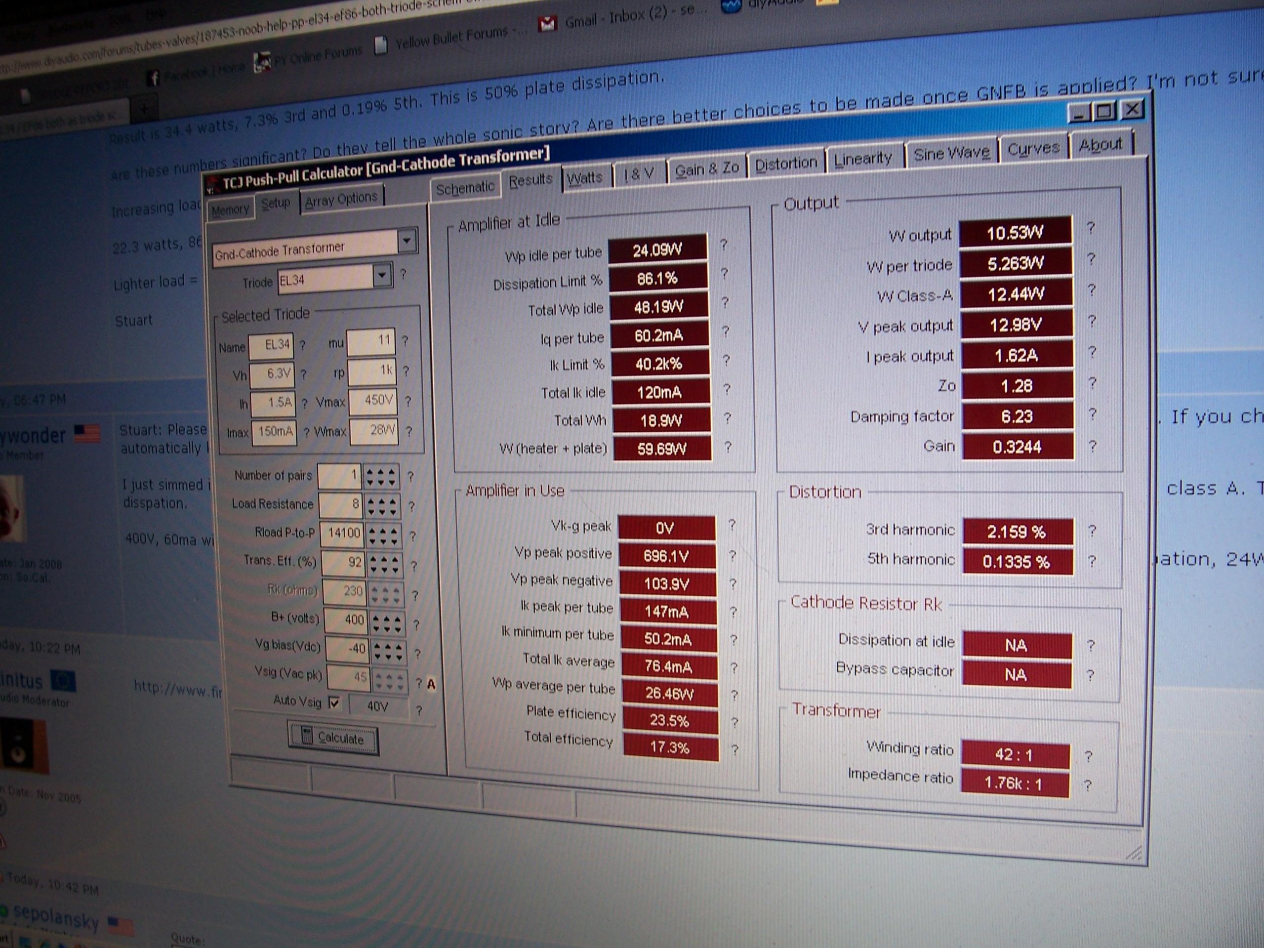

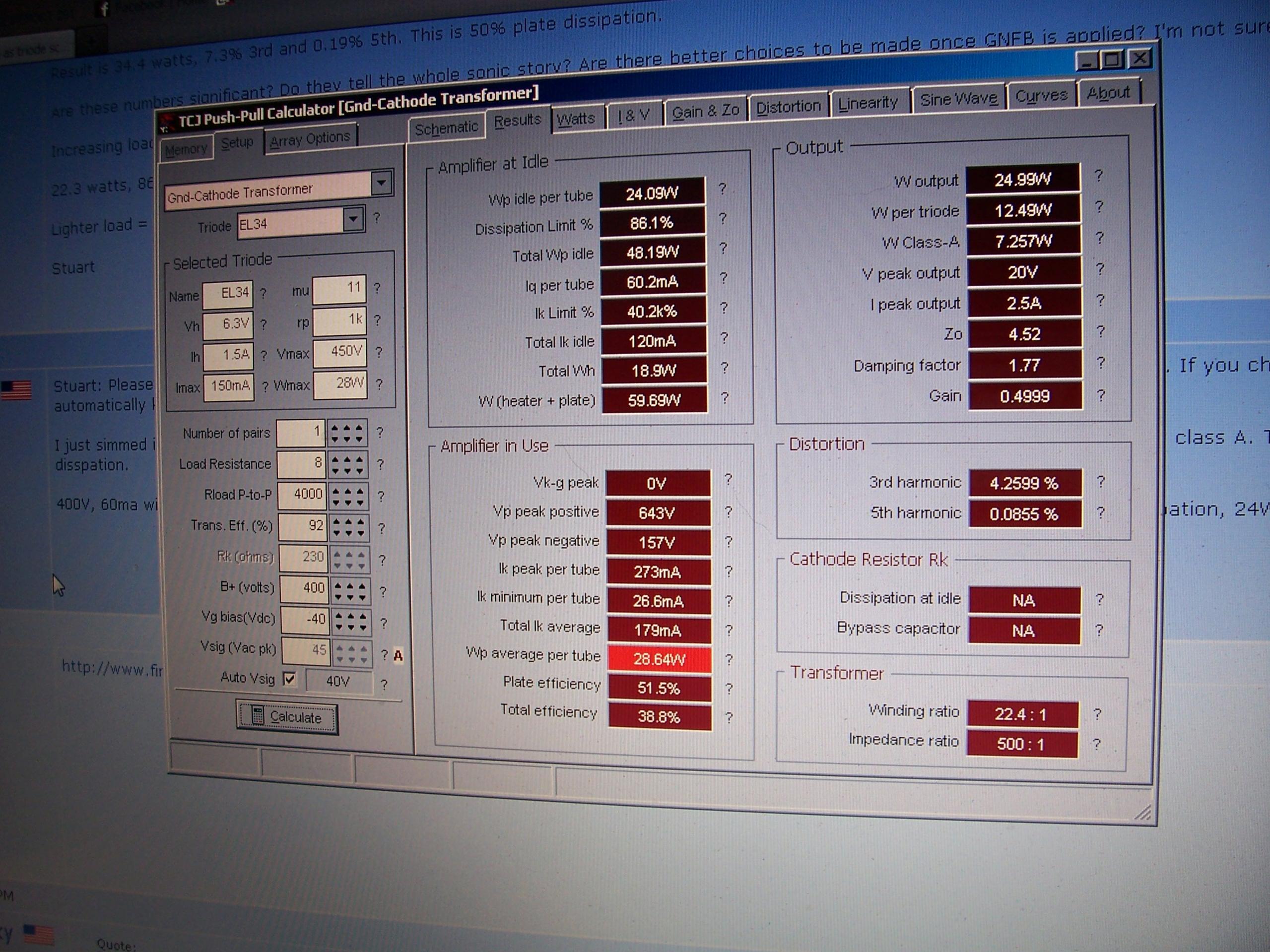

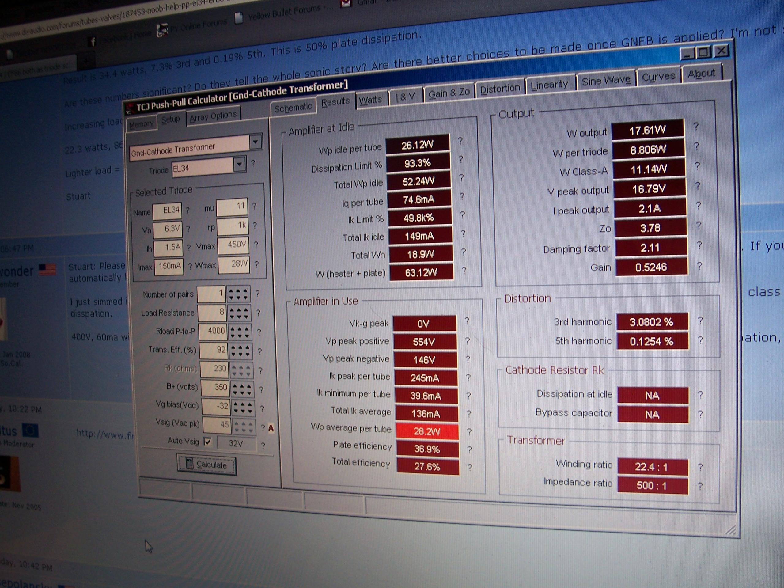

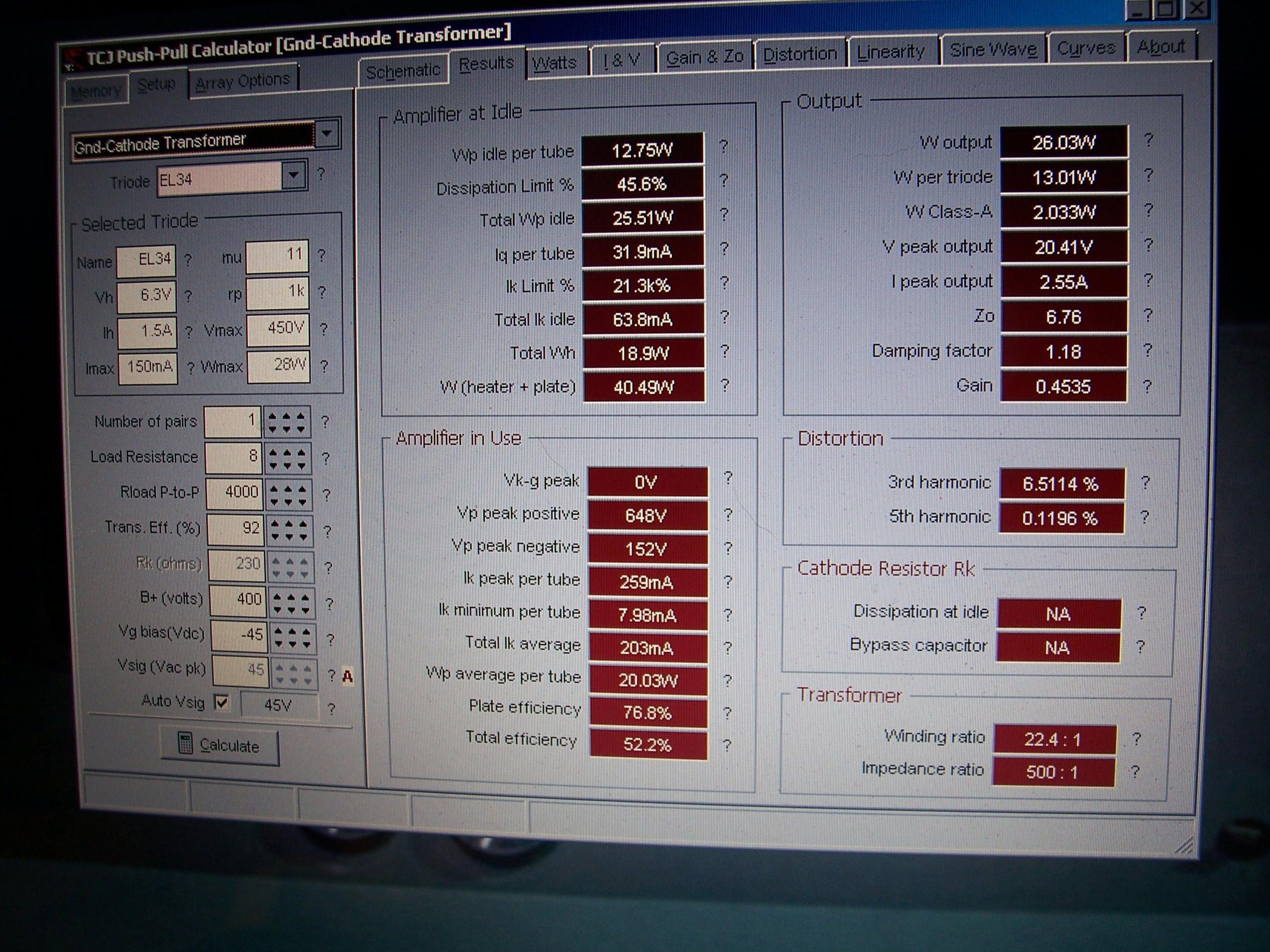

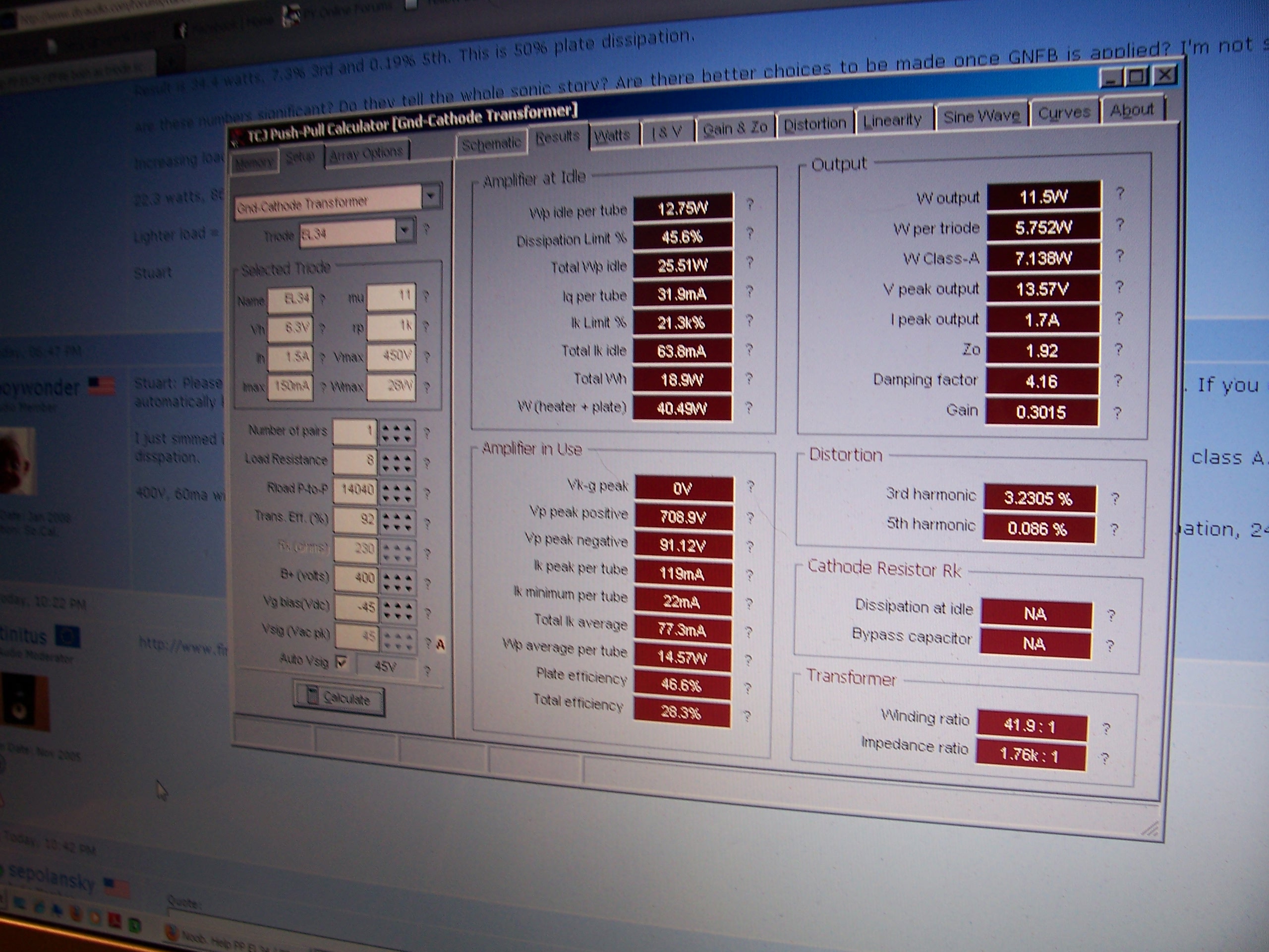

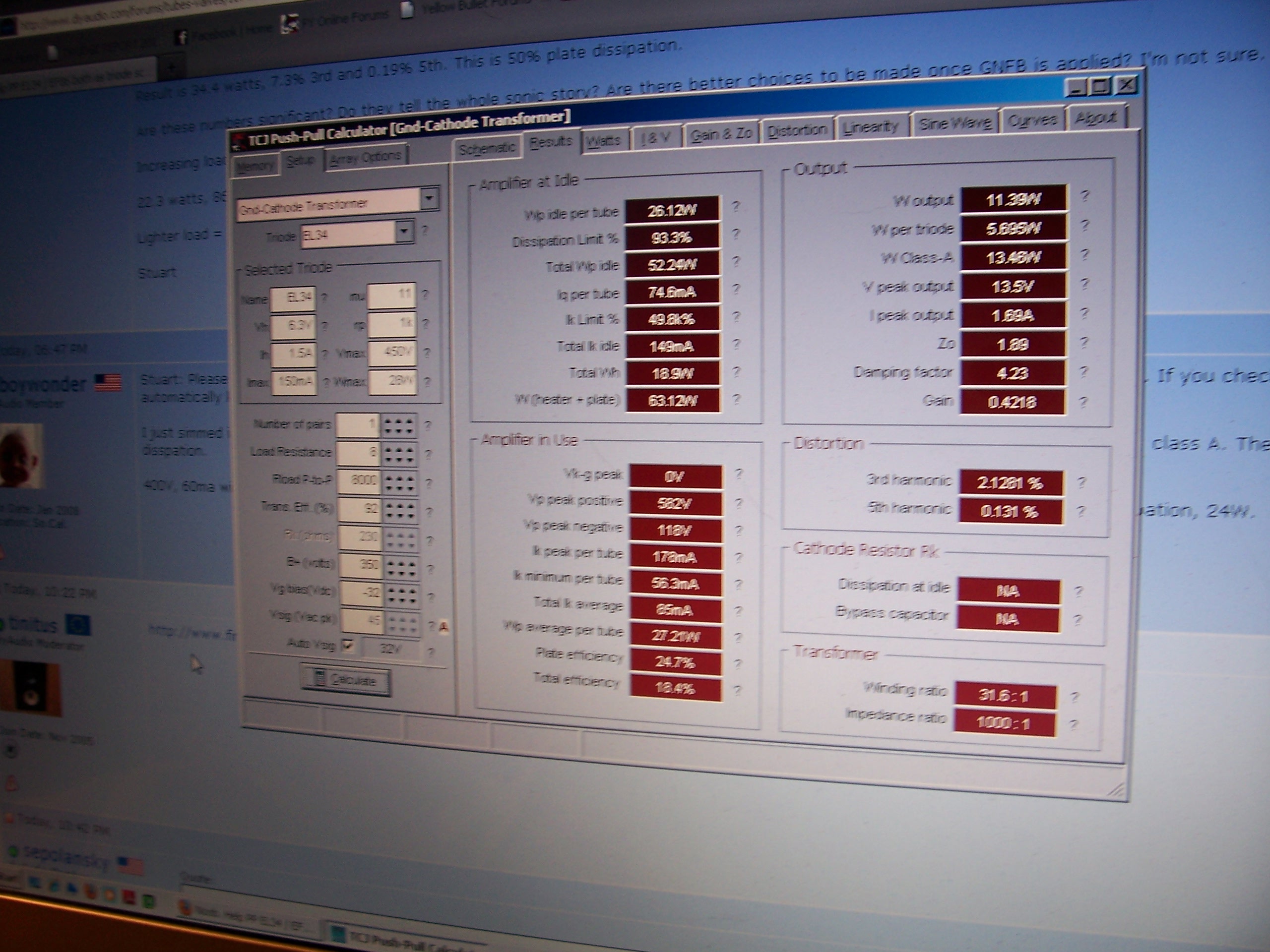

I did a quick simulation using your 400V, 4k load and other standard assumptions. Power out is 25 watts at the onset of grid current when bias is 60mA per tube. To get that 60mA requires a negative bias of 40 volts. so, in light of that, I may suggest a -50v bias supply rather than my earlier suggestion. Distortion is predicted to be 4.27% 3rd and 0.09% 5th. Of course, that's without NFB. That is also idling the tube at 86% of plate rating and at full power, the tube is slightly over maximum plate rating.

I will try and get the PP Calculator. Was that 25W/channel? I don't really need that much. Would lowering the EL34 supply translate to lower output and lower distortion (wild guessing here)?
25WPC for a pair of triode EL34's seems high (assuming AB1 operation), although KT88's in triode should do 25W no problem. Poinz' EL34 MM does about 14W or so.
Lower B+ = lower output power for sure, distortion depends on the load line.

Now, I'm no expert, I'm just going by the PP Calculator results, but higher bias current seems to lower distortion. Whether it matters once GNFB or Schade NFB is applied, that's another story and way beyond me.
A limiting factor of PP Calculator is that it only calculates tubes in triode mode. But, here's what I've found.
For instance:
1 pair EL34 400V B+ 31.9mA bias current 4k load grounded cathode
Result is 26.2 watts; 6.51% 3rd harmonic; 0.12% 5th harmonic
Same setup, increase bias current to 60.2mA (86% dissipation)
Result is 25.2 watts; 4.27% 3rd, 0.088% 5th
Lower B+ to 350V, increase current to 75mA (this is 1/2 of maximum plate current, probably as far as one should go, eh? Like designing for 100% Class A)
This is 93.3% dissipation.
Result is 17.8 watts, 3.1% 3rd and 0.128% 5th.
Going the other way, design for 30mA plate current and plate voltage of 450V.
Result is 34.4 watts, 7.3% 3rd and 0.19% 5th. This is 50% plate dissipation.
Are these numbers significant? Do they tell the whole sonic story? Are there better choices to be made once GNFB is applied? I'm not sure.
Increasing load (back to 400V, 60mA bias) to 5k ohms gets:
22.3 watts, 86% dissipation, 3.8% 3rd and 0.1% 5th.
Lighter load = less power and distortion.
Stuart
Stuart: Please check your input signal (Vsig) in the PP calculator. If it exceeds the -ve bias voltage you are into AB2 operation. If you check the auto Vsig box, it will automatically keep you in AB1 operation.
I just simmed it with Vsig=Vbias and it gives about 11.5W output with your target bias current of 31.9ma, B+=400v with 1.29W class A. The tubes are loafin' at 12.7W disspation.
400V, 60ma will yield more class A power (about 4.5W) with similar max output power (11W). This runs the EL34's at max dissipation, 24W.
Hey BW,
I made sure that Vsig didn't exceed Vbias, each time I changed parameters. Thanks for the auto-Vsig tip. Let me check what I did wrong, because your #'s are a lot different.
Stuart

BW,
I tried redoing the sims. The only way I could get my sim to come close to yours was to increase the transformer load to 14.1k. I took a few screen shots, let's see if I can post them.
Check out the distortion on the last simulation.😱 What's the catch? Look at the required drive voltage.
BTW, 22 years ago, before I knew 1/10th the pittance I know now, I built an EL34 amp. Still works today, only thing ever failed is the power switch. Used Joe Curcio's input circuit from Glass Audio. It is switchable between pentode and triode. 30mA bias current and 440V on the plates. Measured about 26 watts at visible clipping in triode, 42 watts in pentode using a 375 volt regulated supply. So, I suspect my numbers may be close. Used outputs from a Fisher 500C receiver.
Stuart
