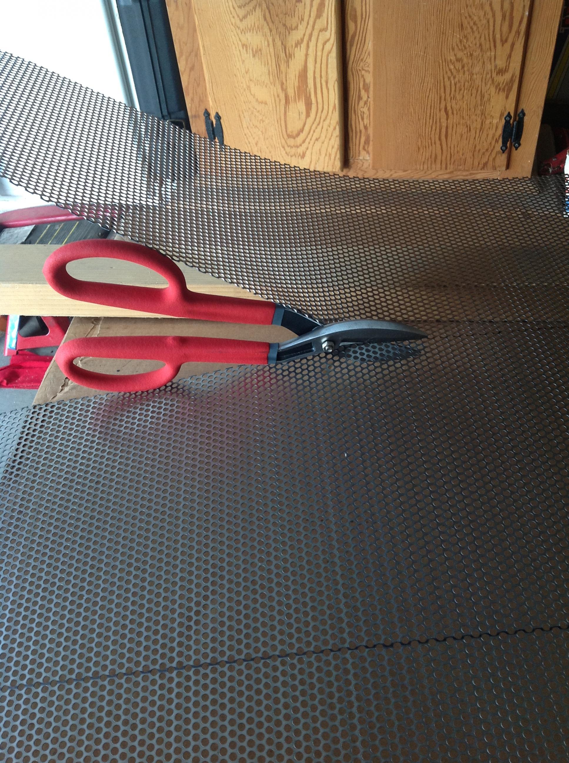

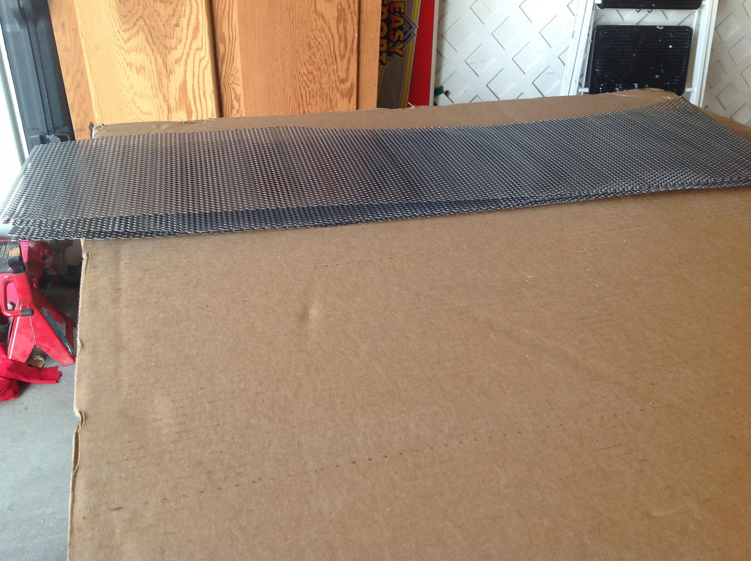

Here's the 12" snips cutting the perf sheets. The sheets are not quite flat after the cut--hopefully I will be able to get them flat enough.

Cutting done. I used some 12" tin snips I got from Home Depot for about 20 bucks. The process did induce some bending. I also picked up an edge grinder, so either straightening or edge smoothing is next.

I think that you will have even more of a challenge getting those panels flat again.
The most tolerance of warpage tat you can ave for an ESL is about .010" and maybe up to .025" total for both sides if you are lucky.
Being slightly bent is not the same as having a panel with many large waves and creases.
Even some of the very slightest waves in a panel have been known to separate at the tape bonding.

I think that you might be able to salvage few pieces for some smaller panels or someting or maybe you will get lucky with A LOT of extra hard work and get them straight again.
But, all in all, They Must Be Flat!!!

I asked how to straighten here only because the panels have more than just mild bending :-(.

Spent an hour straightening the panels. They seem to be flat enough, and time will surely tell. After some bending back into shape on the drawer liner, I set each panel flat on the wood work surface I was using, and tapped along the width and height looking for high spots. Straightened even more, so, we'll see.
Also got the angle grinder out and started rounding off all the sharp edges. That will take a while--maybe get that done this weekend.
