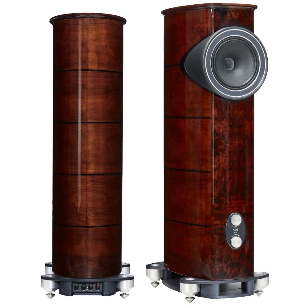

This is currently more of a thought exercise on designing and building cabinets for full range speakers.
I don't have a specific driver in mind... and my questions are pretty basic.
I was looking at the Fyne F1-8s (8" coax) in a compact 'bookshelf' speaker. (Their F1-5s are the same design in a smaller package and are bookshelf speakers)
They have a downward ported base, and I think I know how I can do that... Its the cabinet itself that I need to focus on...
I want to CNC the cabinet in layers. I can calculate the number of layer and use either MDF / Plywood, or a mix of both.
My first question is shape. While the Fyne's have the driver in a cylindrical shape protruding from the cabinet, the cabinet is also shaped a bit like a tear drop.
Now does the internal shape matter? I mean I could design the speaker to have the internal walls follow the same contour or be a box inside. (So side walls would be thicker.) This would reduce the need for internal bracing. Or I could make it where I follow the contour, and then do internal bracing...
(The bracing opens up some other questions in term of creating box tubes... ) In terms of ports, I plan on 3D printing.
Translam? A huge waste. The only thing it gets you are more exotic shapes.
Takes way more material to end up with a lower performance enclosure.
Not awhole lot. Outer shape will largely dictate the diffration signature.
It seems that w CoAx or full range drivers, the rule of thumb is that the cabinet should be 2x the diameter?
That gets you nowhere. Fs, Vas, Qts are largely what determines cabinet size.
Fyne F1-8s
The cylinder holding the driver in this one is really good at making for an ugly diffraction signature. The firstthing that struck me with the Fynns, was this, i’m guessing, someone in the marketing department.
A translam probably need sto be twice as thick as if the material was used in the direction it was designed to be used, and due to the slices more bracing is probably required. I have yet to see a translam that approaches bracing in a decent manner.
That is the way to get exotic shapes.

It looks like the edge of the cone is further out than the baffle?
(Again I'm still learning about the front baffle and designs..)

As Allen noted, the driver is a baffle and it has a pipe end correction = 0.61r, so for an 8" frame = 4*0.61 = 2.44" + 8" = 10.44" effective dia..
This WL and larger fold back and reflect off the cylinder further increasing it's effective baffle response to some extent and as it goes lower the vertical pipe adds a stepped response to lower still, i.e., Allen's 'follow the waves'. 😉
