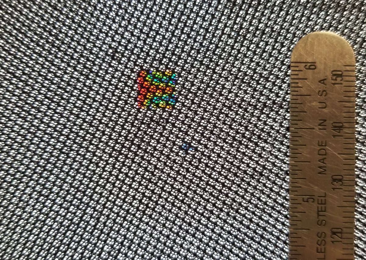

Have you made sure that it is not actually the grill 'frame' vibrating or being affected that causes it?It can't really get much closer in this case. The cloth is stretched over a thin hoop made of white oak (steam bent) which fits snugly over the driver's front gasket.
Grill frames as mentioned before is a common source of diffraction, and 3rd harmonic from rattling/vibration etc.
Without trying with fabric only and check the difference, the measurements can't give a conclusion.

A rattle will cause a long series of harmonics including H6 and above, whereas here we see purely odd harmonics. Solid body contact effects are unlikely to cause purely odd harmonics.
Does supporting the grill cloth have an effect? If the cloth experiences nonlinear air resistance, then it becomes a radiating surface for odd harmonics. Supporting the cloth allows it to move less.

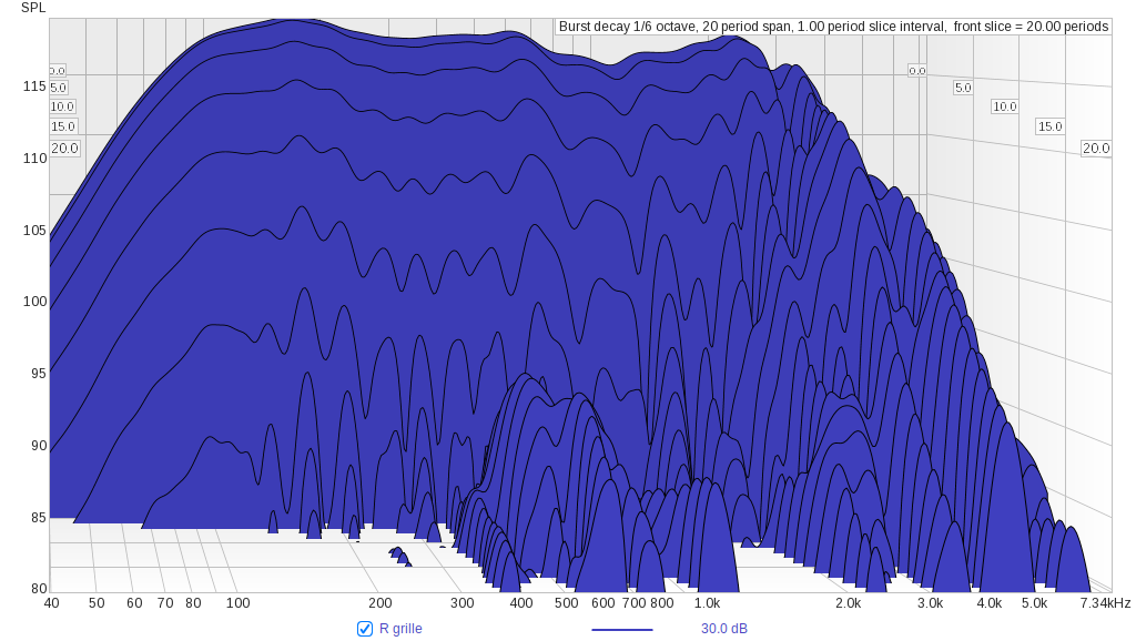

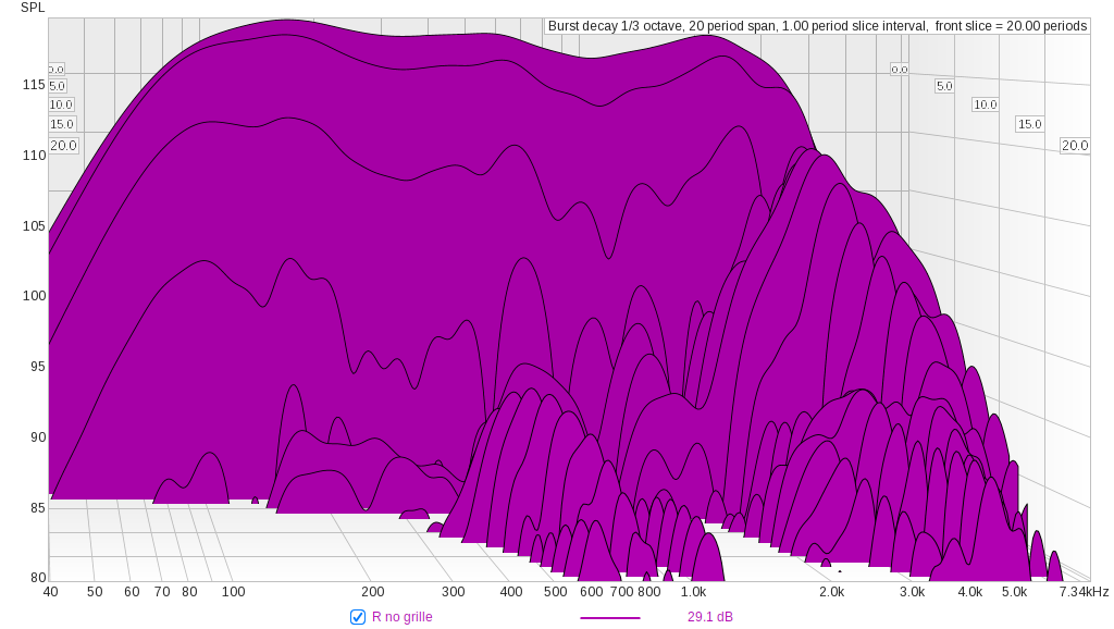

I finally got around to doing a few more tests. The microphone position is roughly the same, but a few other things make these measurements not directly comparable to the previous ones:
First, no grille at approx. the same drive level as before (~6.3V RMS at the woofer terminals; ~5W into 8 ohms):
And with the grille:
Next, I tried to support the grille cloth somewhat by holding a couple hardwood dowels across its face:
I couldn't tell from where I was standing during the previous tests, but it turns out that the grille cloth does move quite a lot. Tentative conclusion: The motion of the cloth is a factor, at least at lower frequencies.

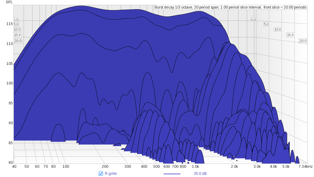

I also tested two lower drive levels. Here's ~2.83V RMS (~1W into 8 ohms) without the grille:
Still some difference, but smaller than at 6.3V.
Now ~0.89V RMS (~0.1W into 8 ohms) without the grille:
Seems to be no clear difference at this level. Note that 0.1W is still moderately loud in the context of home music listening—around 88dB mid-band at 1 meter in half space.
