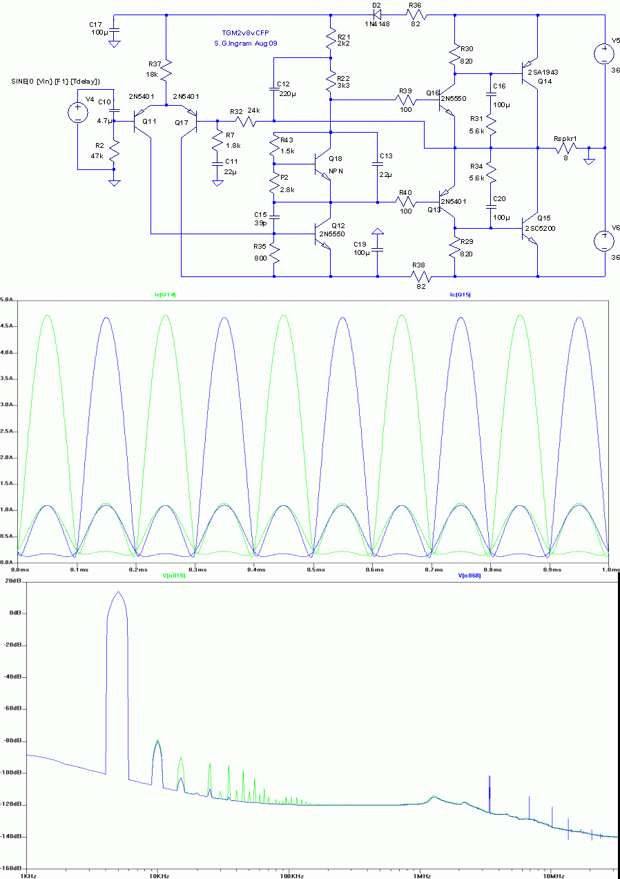

I have been looking at how to take full advantage of the linearity inherent in the CFP output stage. The problem is, CFPs are thirsty for current because they hate to switch. The methods I've explored to date for achieving non-switching behaviour have not been that simple or as effective, see: http://www.diyaudio.com/forums/showthread.php?t=146015&highlight=harry77&page=5
So now I have a design that appears in sims to create a non-switching CFP output which is cleaner although it's rather crude. In the CFP structure the master device is configured as an emitter follower on the output. The slave device wraps around it, taking it's base input from the collector of the master device which is held off the power rail via a resistor (setting the current level in the master device). The signal at the base of the slave is inverted with respect to the output. By providing a level of ac-only negative feedback from the output to the base of the slave device it's possible to keep the slave device always fwd biassed. The current through the output slave device never drops below the idle current which is set by the Vbe multiplier.
I have compared this with a version of the amplifier that uses only EF outputs operating in ClassAB with everything else being equal. The idle current through the CFP stage is set a bit higher, as they are always happier that way but never high enough to operate in full ClassA at the signal levels I'm using.
The negative feedback from the output to the base of the slave output devices is accomplished by a resistor & capacitor in series. See attached schematic. Also attached is an FFT plot at 10kHz at two different signal levels of +/-9V and +/-28V output (into 8 Ohms). The green trace (with more spikes) is the standard EF output structure and the blue trace (predominantly H2/3) is the non-switching CFP. It seems to function just as well at higher and lower frequencies; it's particularly clean at lower fundamentals.
How would you refine this ?

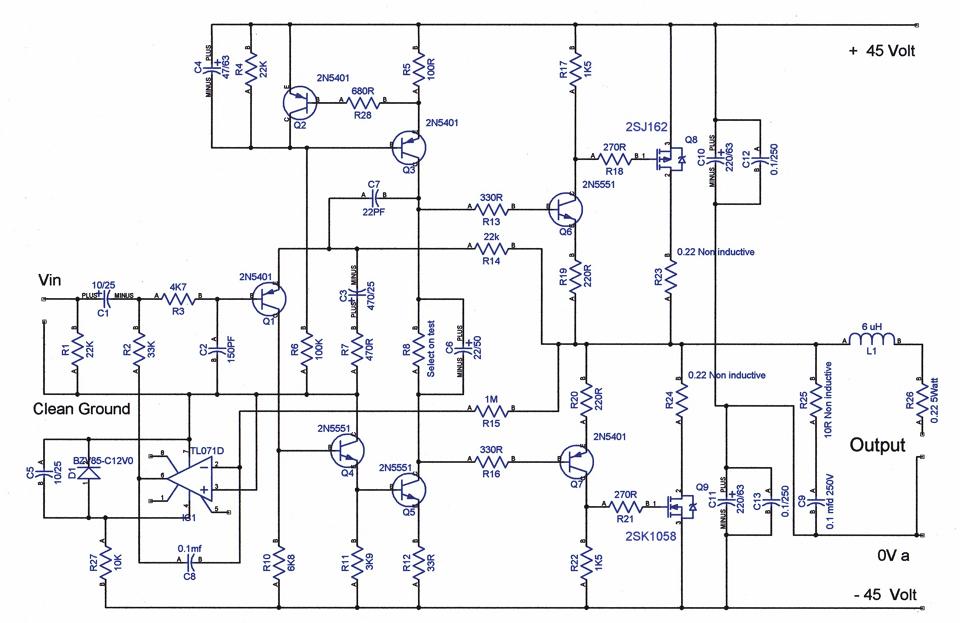

Gareth,
you steadily keep searching for the truth (there`s nothing wrong with that). You could also take a look at the structure of The Ultimate Suplifier (bridged output, no global feedback). Or just at this great sounding topology with switching output (lateral MOSFET required).

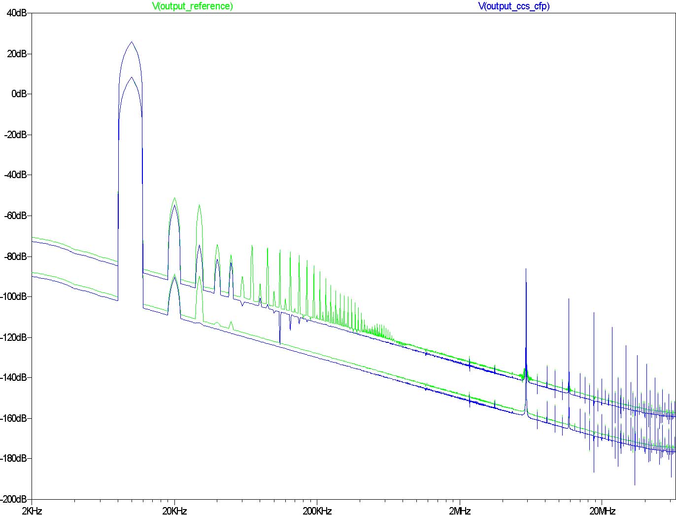

I am also, currently somewhat fixated on the (simulated) harmonic spectra as a key indicator, for good or bad. I don't like what I see from switching outputs (yes this is in conflict with being very happy with TGM2). With ClassD you have a big filter afterwards. With Class AB there is no filter afterwards. With Class A there is no switching. I'm drawn to non-switching outputs. Even with some H2/3 it doesn't take much to produce higher order harmonics from IM.

Perhaps the circuit I posted looked a little complex, but we can strip away quite a bit for a simple 50W+ amplifier.
top image - schematic
middle image - current flow through output devices - always non-zero
lower image - FFT (blue) of CFP output verses EF output (green)

Gareth,
maybe the truth is written in the stars...but there´s is not only one truth I`m afraid.
I will try to give a more detailed answer successively.

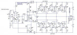

Gareth,This has a lot of potential.
Excellent, that's what I was hoping for, a vote of confidence
I'd welcome further thought and comments.

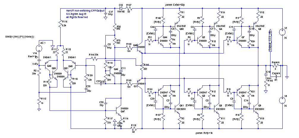

Sebastien,
This technique was used by Arthur Bailey and Sugden in their sixties amp which used a CFP output stage. Very clever, I thought.
However, Bigun's idea of a resistor and cap in series loading the collector of the master back to its emitter has lots of merit too.....

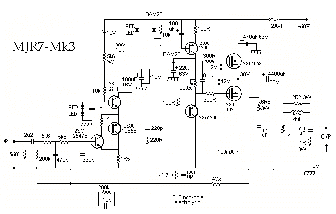

Here's something I successfully experimented, providing symmetrical paths for the output devices gate currents. Works fine, however I concluded it's not worth the complexity, and generally CFP output stages are not worth the trouble.
The attached schematic should be considered as conceptual only.
