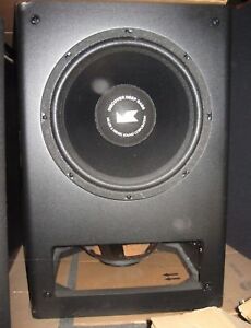

Get the slot as narrow as you can.
You can get away without a slot, m&k subwoofers did this.
Push pull can be sealed, transmission line, or whatever.
I've been on the fence to make a 2x15" sealed with f3 near 30hz.
