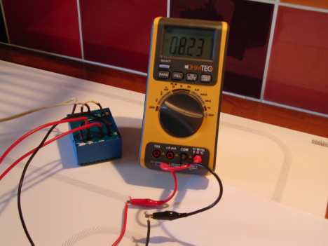

tube buffer + power transformer problem
Hello Thomas,
i have a problem with 15 v transformer, i only have 8 volts ; i tried Kooka and Julien connections, and still only 8 volts???

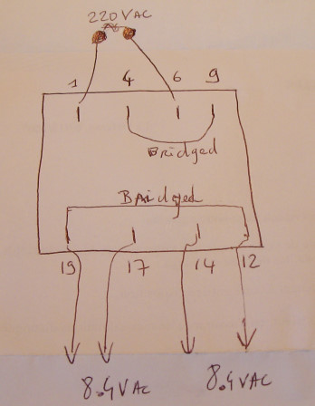

Re: tube buffer + power transformer problem
Hi Gomi2,
What is your main power voltage? Kooka's is 230V and Julien's is 110V. You need to wire them according to your main voltage. If yours is 220/230V, have a look at mine.
http://www.diyaudio.com/forums/attachment.php?s=&postid=1353606&stamp=1195340847
One thing I do find is the transformer pin can be a bit dirty and not taking solder. Give them a bit of light sanding and it helps.

Re: Re: tube buffer + power transformer problem
Yes, on the primary side you have the same connections in both transformers. But on the secondaries sides you need different connections. Look at what SamL did, that is simple and correct.

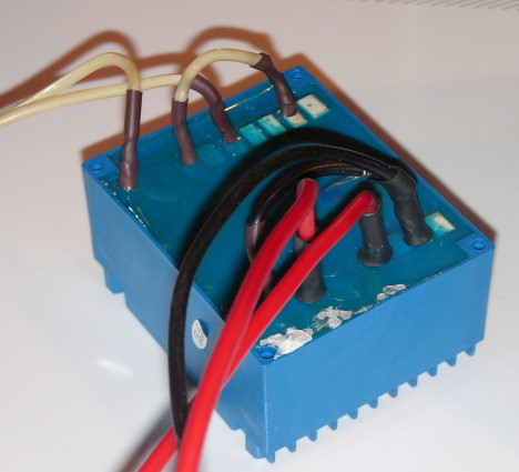

transformer pb
hello all,
i am using 220 v main.
one thing is changing for 110 or 220 main : it' s primary connection.
for secondary connection , this is the same thing ; i tried Kooka or sam connection (= julien connection) : always 8 volts.
sam connection for secondary : (=Julien connection)
12-19 connected together, and connected to "o" PCB
14 and 17 connected to one "16v" pcb socket
Kooka connection for secondary :
14 and 17 connected to "0" pcb, 12 and 19 connected to one "16v" pcb socket
this is giving the same result with my transformer : 8 volts !
thx a lot!
gomi

hi gomi,
pls take photos of the connect method of U in forum,
with PCB pls.
if transformers had problem, I will post one new one to U.
if only half of voltage U get there may connection method was wrong!
OK!

Re: transformer image
Hi Gomi,
Can you try measuring again with the 'black' lead on earth from the main.
