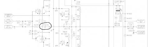

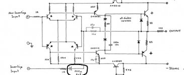

I'm cautious to second guess Bryston, but I'm looking at the electrolytic caps in the feedback look and wondering if it wouldn't be a good idea to replace them with non-polarized Nichicon Muse. The input topology of the 1B preamp and 4B amp (schematics below, caps circled) is the same, and I have measured a couple of millivolts across the cap in the preamp so there's really no bias across them. These caps are approaching 30 years old and in the signal path, so they're going to get replaced anyway, so now is the time to make the change. Is this a smart move?

these DC blocking capacitors in the lower leg of the NFB feedback path have virtually no DC across them and virtually no AC across them, when properly sized.
This results in virtually no distortion due to the cap being added to the -IN input of the amplifier.
In my opinion there is nothing to be gained by going to non-polarised.
However, if you want to play safe then adopt the back to back non polar solution that Bateman suggests for superlative distortion performance, almost as good as the best film caps.

Thanks guys, just put Nichicon Muse bipolars on order. The reason I got started on this is that the gain of one channel seems to wander and I figured these caps should be replaced anyway and might well be the cause of the problem. I'll post the results of the change after I get a chance to install and listen.
Jim
My personal experience with repairing old amps and receivers is that if the gain and distortion seem to change, it is the feedback network electrolytic capacitor. They will typically be intermittent and malfunction will be temperature dependent, so it is good policy to change them if you're working on it anyway.
Got the caps in this weekend. Still had the balance issue, so I replaced the volume pot with a $4 radio shack special, and that seems to taken care of the wandering gain. Might consider an upgrade to that later.
The preamp sounds significantly better than it did before the work. Good detail, big soundstage, I'm really impressed. It might be that the thirty year old electrolytics weren't quite what they used to be, but as $1.56 (for all six caps) mods go, this was a winner.
