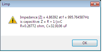

@ op :if you have not the tool to measure capacitance of the caps, just go for mkt or mkp with 5% precision minimum. SCR or Jantzen or monacor first prices are cheap enough. electrolythic NP for speakers have easily till 10/15% precision only whatever the % claimed by the brand.
Have just measured the capacitance of a NP 33uF using LIMP, here is the result 32.9106uF

I have read somewhere that there is need to add in series a small polyester or MKP MKT cap with the NP cap . I do not remember the reason why. Is that true?
The small capacitor in parallel with the large non-polarized capacitor mitigates the effects of inductance in the large capacitor. A small capacitor is usually used across the series NP capacitor for the tweeter, but is not needed across the shunt NP capacitor for the woofer.
Ed
