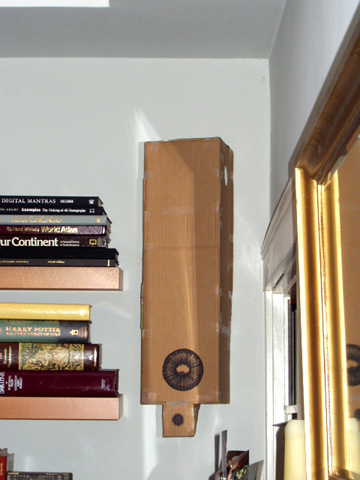

here's a spiffy cardboard mockup of the speaker that dave (planet10) is making for me.
it's going to be wall-mounted - that's why the tweeter is on the bottom (never mind the goofy tweeter enclosure, i'm going to make something nicer, egg-shaped). the walls are non-parallel such that the back is wider than the front, and the front wall is angled in. this allows for wall-mounting without having to worry too much about toe-in. hopefully 'bafflestep' will be minimal.
not that it will matter that much in my living room which is adjacent to the street with all its noise.
