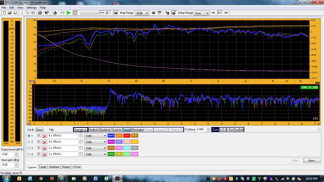

Looks like you need to work on the gains to the mids to make then around the same SPL for the same input voltages as are got from the treble driver.
Even though the mids are lower sensitivity, there are more of them as there are the mid woofers (4).
If you look at the attached you can see from about 400Hz up is quite alright with a taper off towards the higher frequencies so its not too harsh. The problem is in the lower bass where it falls away under 100Hz.
I'm not looking to optimize the curve at this time, as it is ok for the rough baffles they are in, and these are not finished designs. I am just looking to get more power to the woofers rather than improve the graph.

The SPL display in Post #5 shows that you are on the right path now. This is definitely a setup problem in the DCN28.

I think most of the tapering off is due to baffleless bass drivers sitting on the floor (one has a small baffle), but in part some of it is due to not getting enough power to the bass drivers, to really punch out those low notes.
Based on what I measured above, I think I need to decrease the top end, mids, mid woofers, while leaving the woofers at +0 and turn the volume up on the DCN28.
