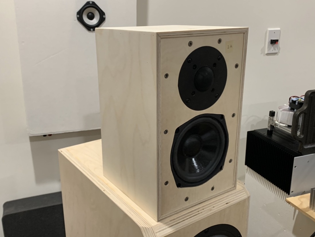

I went sealed with my DIY Satorels, 40litre and SB WO24P-4. (Plus Morel EM1308 and ET448 with active Nanodigi crossover with LR2 crossover at approx 700hz and 3500hz). Main reason was that I have a fairly lively room bass wise and the sealed box tames that somewhat.
